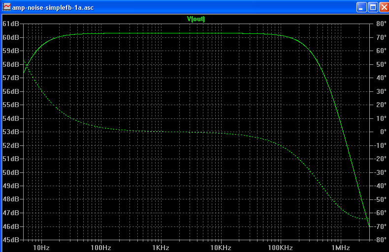

Perhaps something simple like this can work.

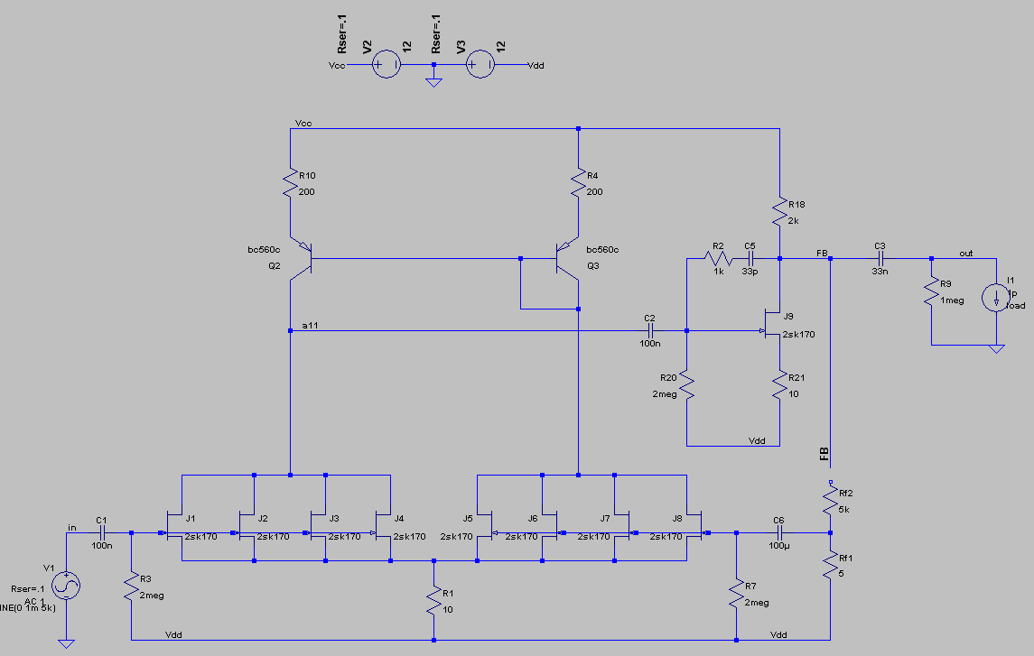

High first stage gain using paralleled 2SK170V jfets (or perhaps bf862 better). Two low noise pnp, not necessarily bc560c, but I didn't have a model for any of the 2saX bjts. The total open loop gain is about 88dB, as seen in the second attachment. Using a resistor divider to get about 60dB, as in the third attachment. The second stage is not directly coupled. I did try, but failed to come up with a simple directly coupled second stage that would work as well as this.

I don't see what the problem was with the performance of the circuit in post#1, aside from the low-frequency roll-off, which would be easy to fix by increasing C5 (and maybe C1 as well).

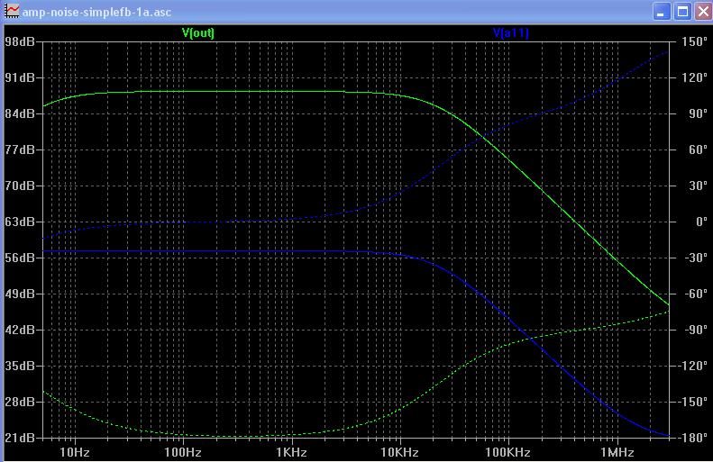

With the latest circuit, won't the DC voltage at point a11 be more-or-less undefined?

Yes, the circuit in post #1 worked, but the fly in the soup was not so good stability of the gain. So feedback was recommended, hence the resistors Rf1 and Rf2.
The voltage drop across the bjt shouldn't be large, so there should be enough voltage across the jfets to do their thing, I think. But I haven't built this one yet; I'll try it first thing next week.

I don't think the so far posted schematics are a particularly suitable start to implement a low noise amplifier--e.g. have you looked at the PSRR of these designs?
Is there a particular reason why it *needs* to be fully discrete? I would not have any difficulties to sketch such an amplifier (that actually works) for you but I don't see any justification for it. Rather I'd suggest you look at this: www.sg-acoustics.ch/analogue_audio/test_gear/pdf/lab_preamp_100x_lp_r1.pdf
The first stage (everything to the left of C6) could be easily modified for 60 dB gain and lower noise, with overall much better behaviour than what we've seen so far in this thread.

Thanks for your advice Samuel. Just to be clear, my perspective is that of a beginner, which I am, hence, there will be questions which you may find trivial and/or annoying. One my motivations is to learn something from this exercise.
Yes, but didn't concern myself much with PSRR because the supply is intended to be batteries, and the whole thing be cased in a metal box. It would be nice to keep the circuit simple, if possible to get away without much PSRR. What do you think?

Where does the input stage DC flow? It says 1mA above Q2, so that will flow through Q2 and Q1, but then it is blocked by C5, so where does it go?
It doesn't seem to be really low noise?
As shown it is indeed rather noisy as it has low gain. However to complete the schematic you'll need to add a gain setting resistor between the two sources of the input pair.
Instrumentation amplifiers are nice for their CMRR but they have higher voltage noise compared to a single-ended input (such as shown in my schematic). It's all a matter how low the noise really needs to be.
Through R6. There is a DC offset at the output of U1A because of this (and the Vgs of the input JFET) but this is blocked by C6.
Samuel
So if it flows through R6, then it must flow into the output of the op-amp and then to the negative power rail via the lower output device in the op-amp output stage. That is not very intuitive! But OK, I begin to understand a little, so thank you for the reply.
