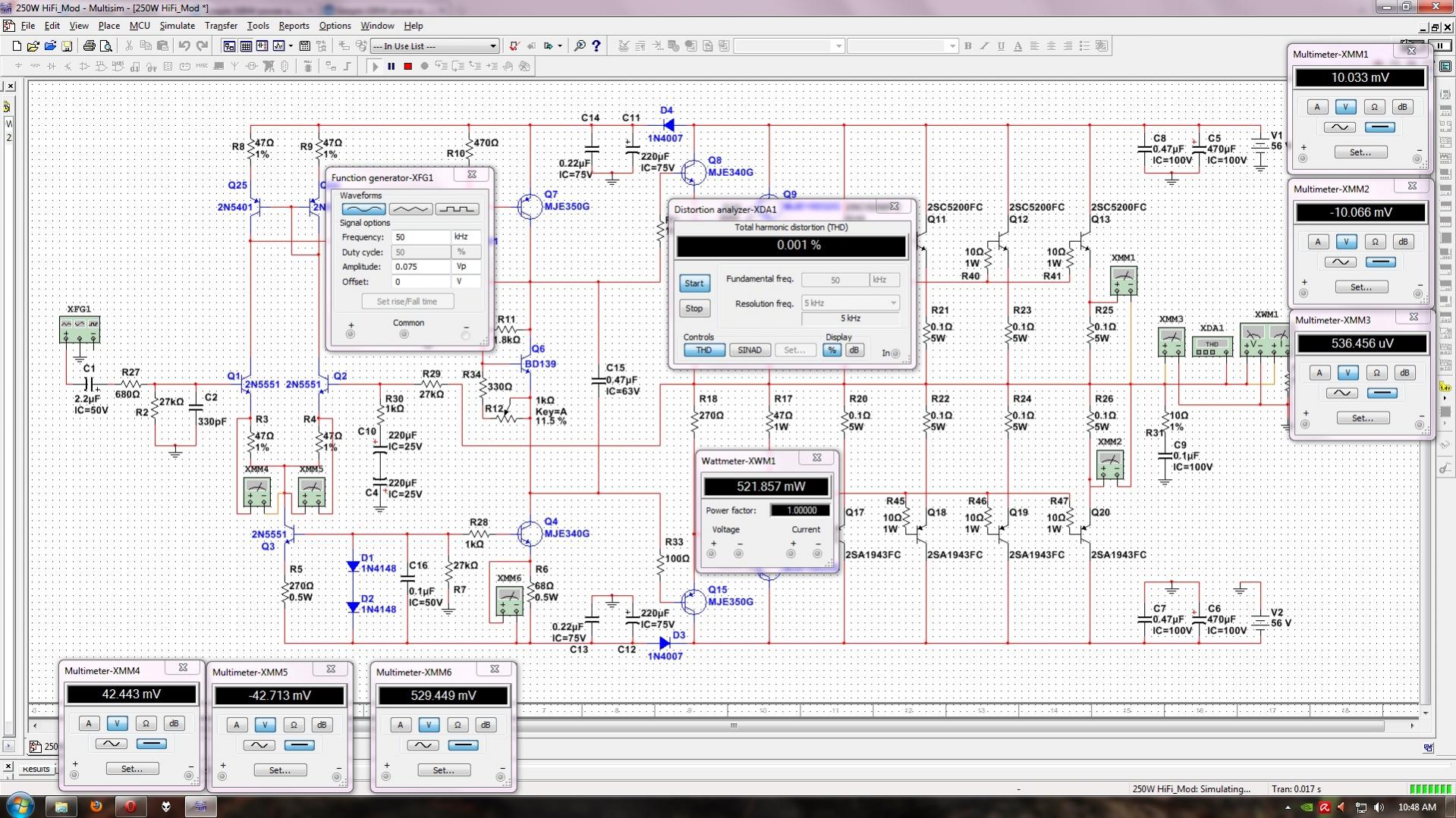

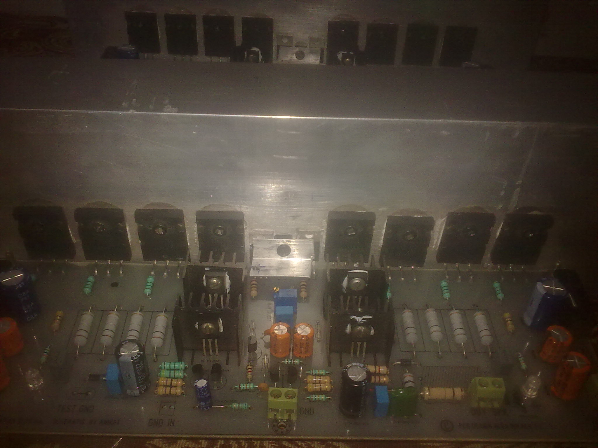

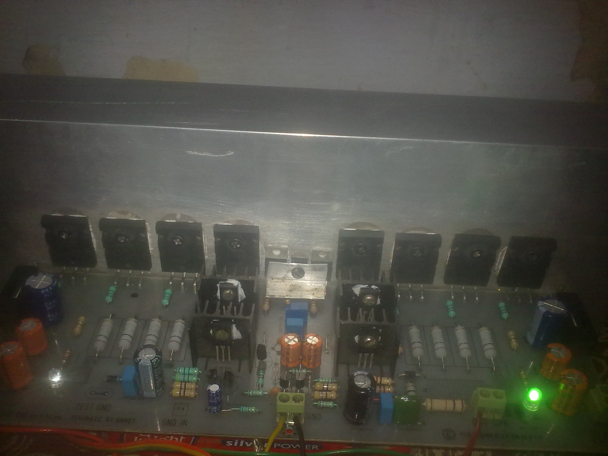

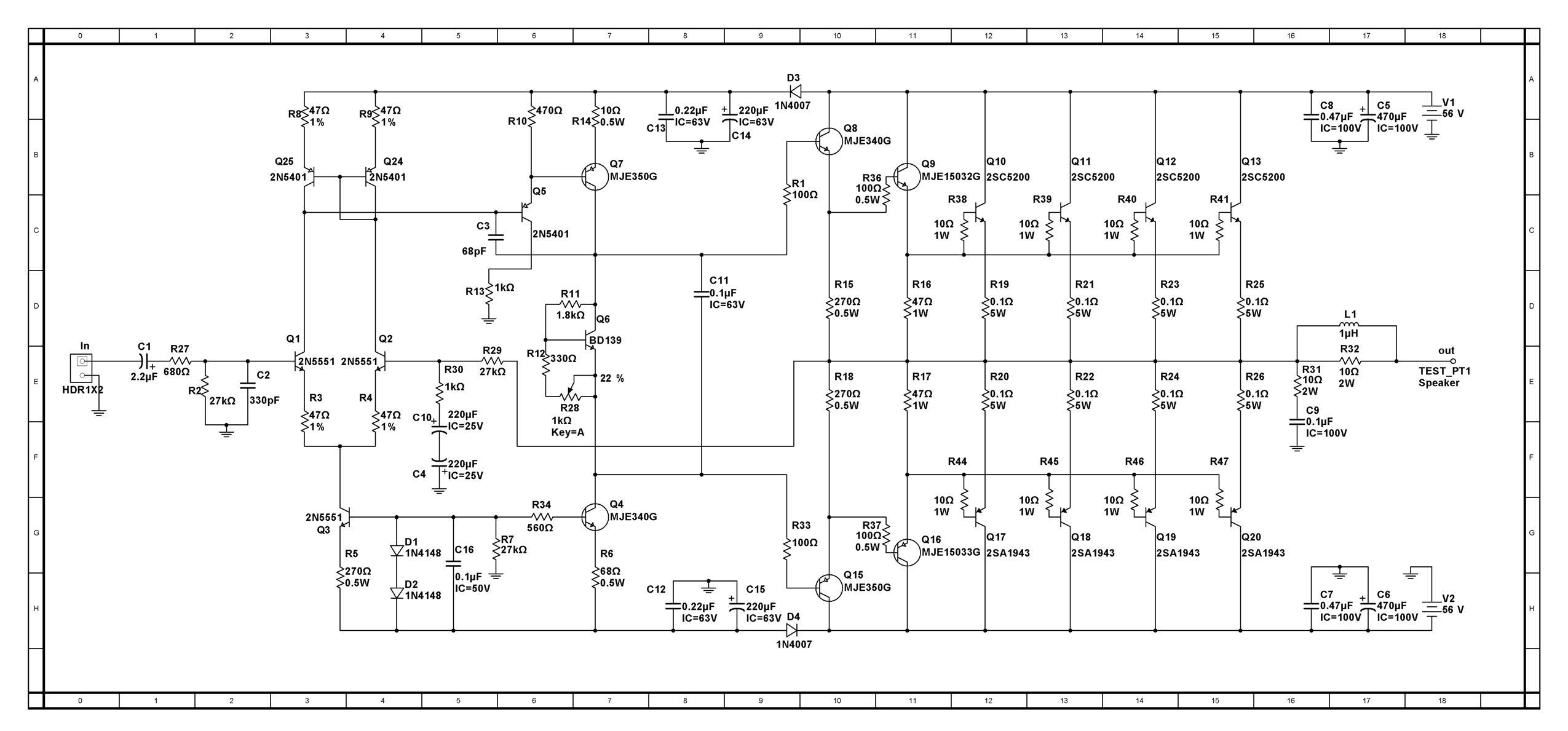

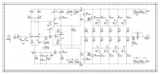

Till the time i could get the required power transformer and chassis, i did some tweaking in the simulation and made some changes in the circuit,

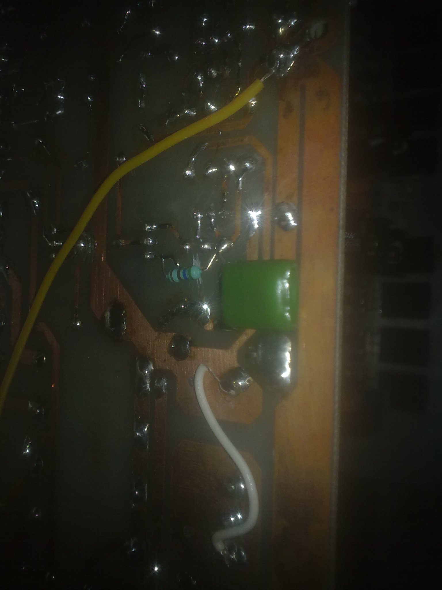

included R34 560R and C16 0.1uF and soldered them on the copper side of PCB, changed C11 to 0.1uF and R36,37 to 100 ohms. Increased predriver current by reducing R15,18 to 270 ohms.
powered the amp with +/-28V supply, set bias at 75mA per transistor, checked DC offset, 1.8mV and 8mV DC on channel 1 and 2 respectively. amp was stable no signs of oscillation.
Also changed the miller cap C3 to 68pF. tested it with a number of values starting from 100pF which was installed earlier when the amp was oscillating originally with 47pF.
tried 100, 82, 68, 56, 47, 39 and 33pF in C3 position.
amp was stable with 56pF as least possible value of C3, with 33,39 and 47pF showing oscillation. So i installed 68pF as a fail safe value for C3 and would gain some high frequency performance.
with all the changes mentioned above there was a prominent difference in sound. Mids were smoother and soft and highs, very crisp and sharp. and the bass was even tighter, faster, more deep. bass is really awesome.

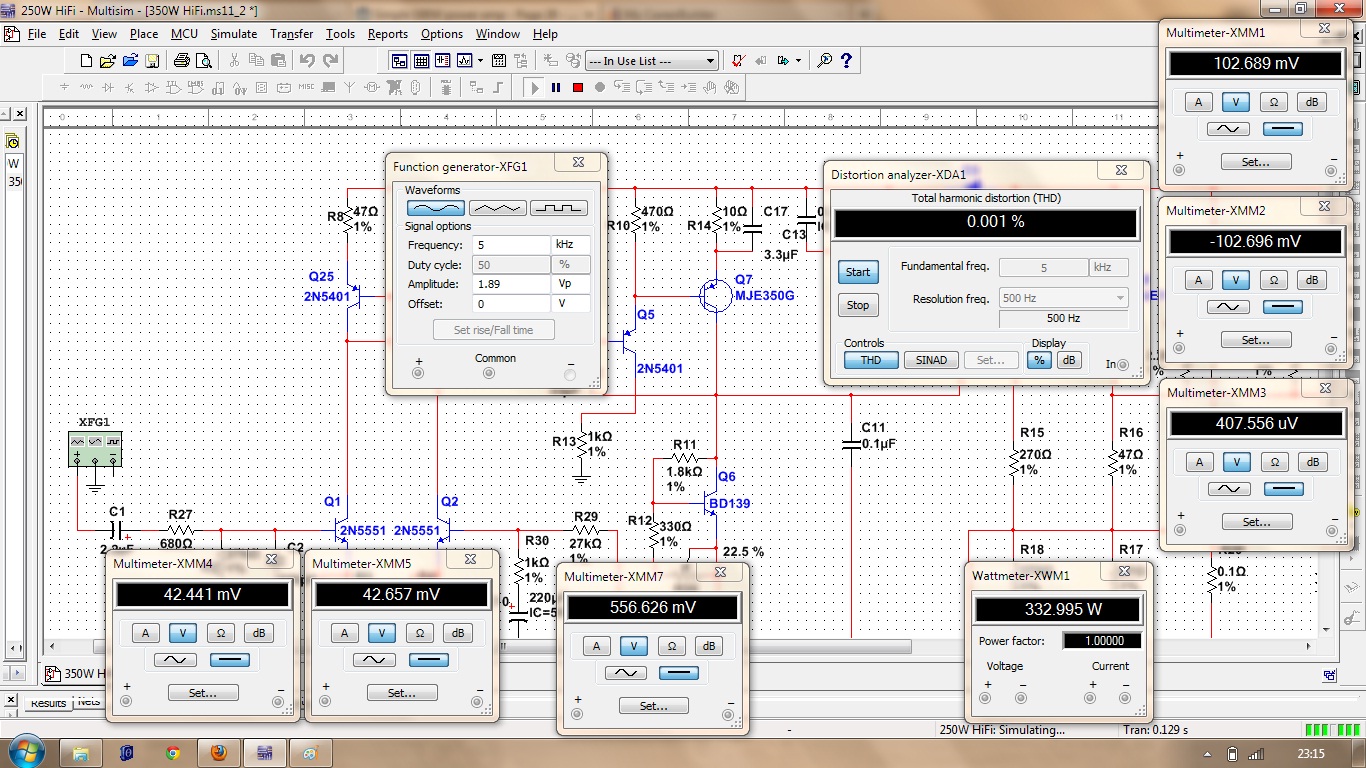

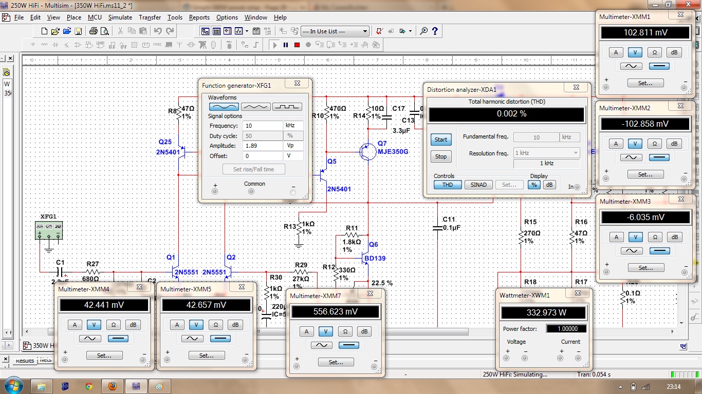

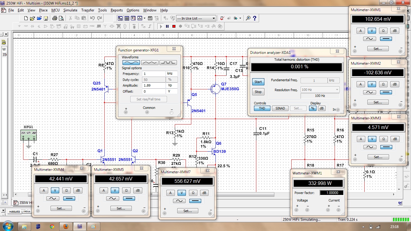

One thing . Can you simulate adding capacitors to R6.14 . They should come in at 5 kHz is my guess ( -3dB ) . It might change dominant pole requirements . The beauty is it keeps the stage match as now except at high frequencies . It might be a fight between loop gain and easy of drive . I have no idea how it would work . I have a hunch it is a free lunch . The hunch says lower 10 kHz distortion . I am feeling too lazy to do the maths . That's the first time in my life I ever said that .
R14 looks likely to be the one to try . R6 is worth asking the simulator to check out . I doubt it will be the one that makes a difference . Tell me if I am wrong as I would be surprised .
10 R Xc = 1/2PifC . -3 dB is where Xc = R therefore C = 1/2PifR . C = 1/2 x 3.14 x5000x10 = 3.3 uF to a good approximation . My best guess is 5 kHz is the critical frequency . Hopefully C3 stays the same . Even if it had to go to 100 pF you might win more than you loose . The idea is to have increasing loop gain when you need it most . I think on simulation it should show something ? My theory is the 10 R resistor usefully helps the previous stage to drive it . Some would say you don't need that resistor especially when a Darlington . Probably true . 3.3 uF will keep DC conditions the same . I would use a 100 V polyester cap . Theory is they sound better than 63V type . 16 V high grade electrolytic like Panasonic FC would be OK . There will be a phase shift . It might come up on simulation as unworkable . Poor old me always does it the hard way . I must learn simulation . Anyone near Oxford willing ? I am told this program you use is great .
D3/4 is an excellent place to introduce a quiet PSU in the future if you choose . Just remove them . You can try both increased and reduced voltage . Both can be good . The former to have nicer clipping , the later for power . +/- 10 V of output voltage if transistors OK is an idea . I would use 100 VA and 4700 uF unregulated , should be fine .

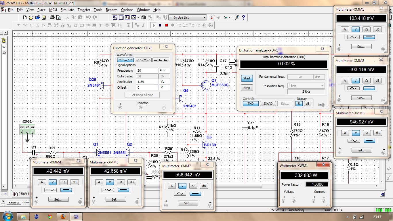

Attached are the simulation results with the addition of 3.3uF cap in parallel with R14. THD figures are 0.001, 0.001, 0.002 and 0.002% for 1,5,10 and 20kHz @ 330 watts into 4 ohms respectively and these were identical without C17 3.3uF cap. C3 is same as 68pF.
Aniket
Aniket
Aniket
I could say try 0R ?
Try at 0.5 W 50 kHz if it will let you .
Maybe just try it for real ? No harm I guess ?
Very interesting . We might be beyond the simulators ability ? In theory something should happen . Especially at low wattage .

Hi Aniket can you post a gain bandwidth plot till 1MHz. Ac SIM.
Hi, Vostro, could you please guide me, how to simulate that in multisim??

HI Nigel,
0R for R14.. ???
0.5W @ 50kHz, would simulate that.
That's interesting . I always work with a spectrum analyzer on a real amplifier . I had forgotten you get THD figures . Sometimes I work out THD for my amps . When the spectrum is full of nasty 5 th 7 th and 9 th harmonics the THD hardly changes . One usually says if the nasty ones are below - 90dB it is OK .
I would suggest you try R14 as 10 R and use 3u3 . You might on voices typical to Indian music sense a slight reality that you don't have now , an open mouth quality which is more incisive . It would be to western ears a bit shrill . My favourite Quad 303 has this . It's distortion spectrum looks like a suspension bridge .
Dr Chaudhuri had an Arcam amp and Royd speakers . His Arcam went wrong . We replaced the TLO71 op amp in the middle section of the amp with NE 5534 and a 10 pF polyester a per Aracm recommendation . The amp would have measured about the same . It didn't sound the same . He was delighted . This is when we listen together from then . At 97 years of age I would guess he had been to the garden shop to get sand to damp the speakers and weigh them down . I was angry because I would have done it . He used his shopping trolly . It was 1 miles to the shop , 4 trips . He had weights and broom sticks to anchor the speakers against the walls . That worked . He covered his speakers in layers of carpet . It worked as it kept reflected energy down . As he said . To damp inside a speaker is perhaps a mistake , do less of it . Not to damp outside is also a mistake . My speakers don't have boxes so less of a problem . Also they have no conventional damping .
One very good thing from this is Dvv and I have been saying for some time a R 14 in everybody's amp might do more good than harm . Strict followers of the " Blameless " design say not . When a Darlington it is complicated . I suspect if you made your amp a single transistor and retained R14 it would work . It might even sound better . It rides on a knife edge so I am not sure . I often arrive at 16R when I use a single transistor .
If you loved the suspension bridge distortion and wanted more there is a way . The LTP input current mirror could be replaced with resistors . This will reduce slew rate and might cause distortion . Slightly reducing input bandwidth would stop that . If the resistors were made unequal eventually the THD would rise . If you let it double it should be mostly second harmonic that is added . You would arrive where Naim audio did in about 1980 . 12K and 1 K if I remember ? My belief is it's true designer was used to using Quad 303 and wanted the same . Usually a single input transistor is the only route . That makes the amp difficult to set up ( JLH says how ) . Naim didn't exactly get the same as the 303 , they got close .
