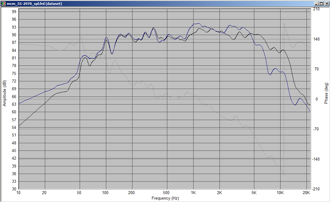

Below is a comparison between the traced curves of MCM 6.5" and 8" models 55-2970 and 55-2971 . Definitely something funky with their measurement setup! I'm not sure why they would post such horrid looking measurements when they could put them in a standard box with an IEC baffle and post comparible measurements to everyone else!
Blue is the 8"
Tony.

It's probably just quick measurement from the "QC" pass/fail setup (..which is usually just clamping the frame and running free-air with a very near-field measurement). The T/S and Impedance trace is really the most important part of the data for most woofers/applications.
I wouldn't be at all surprised if many fullrange measurements from non-pro manufacturers just use as simulation for the lower end of their freq. response graphs. Of course many in the pro industry that actually do fullrange graphs are using a vented box as spec.ed at the bottom of their graphs.

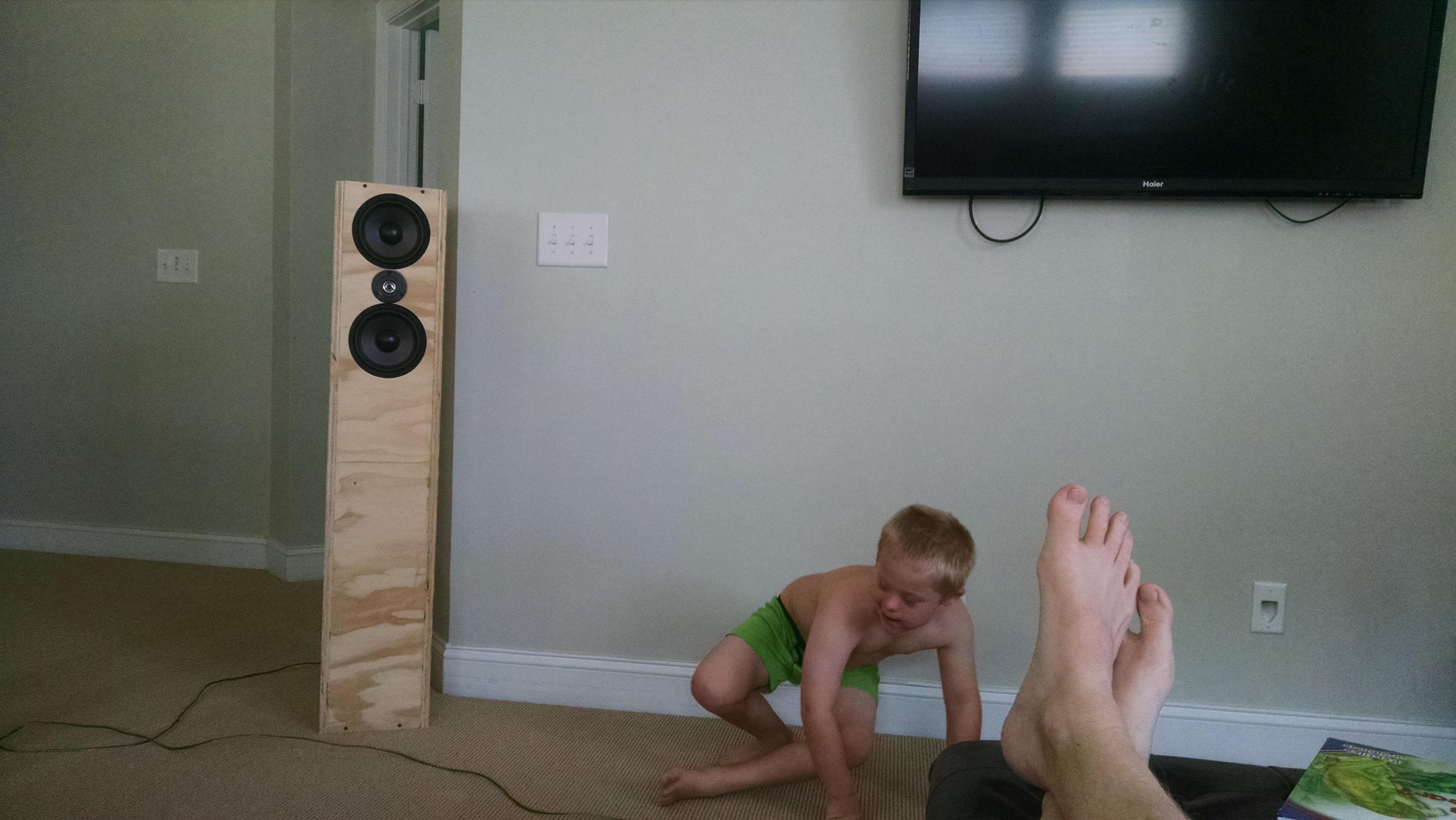

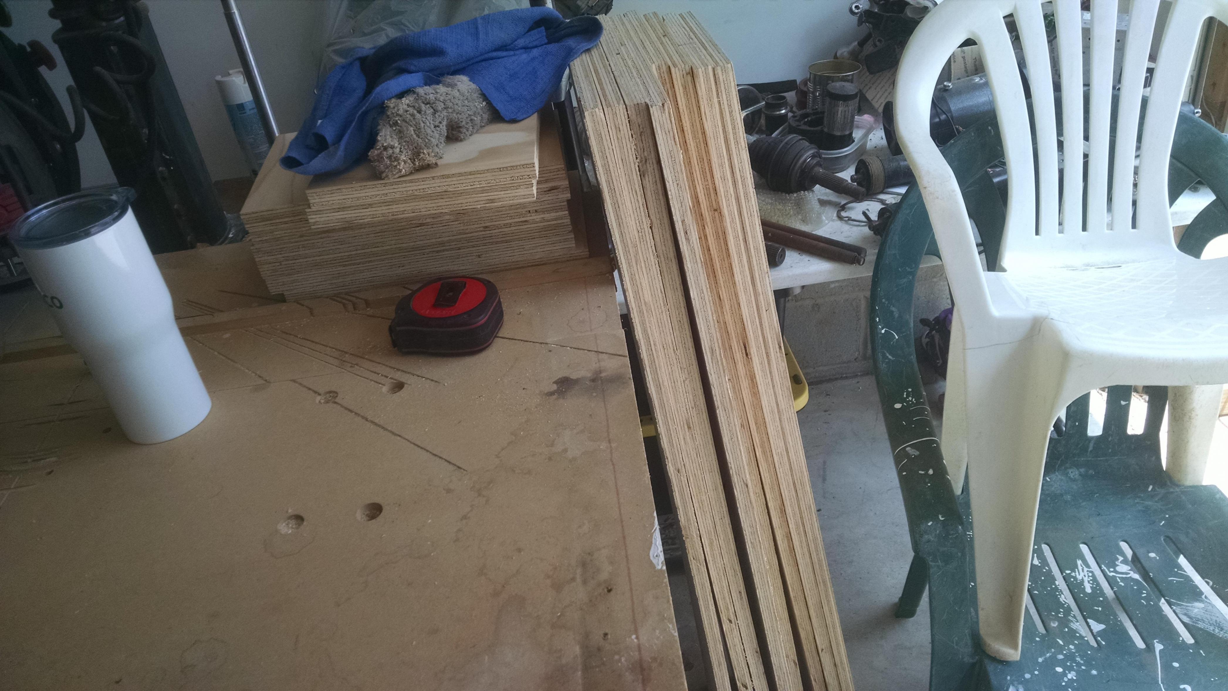

I started cutting wood! Even with the 100 degree heat index... Got as far as ripping the tall panels and cross cutting the tops and bottoms and braces. No router action yet. These are apparently going to be 4' tall yellow speakers since that is what my son chose...

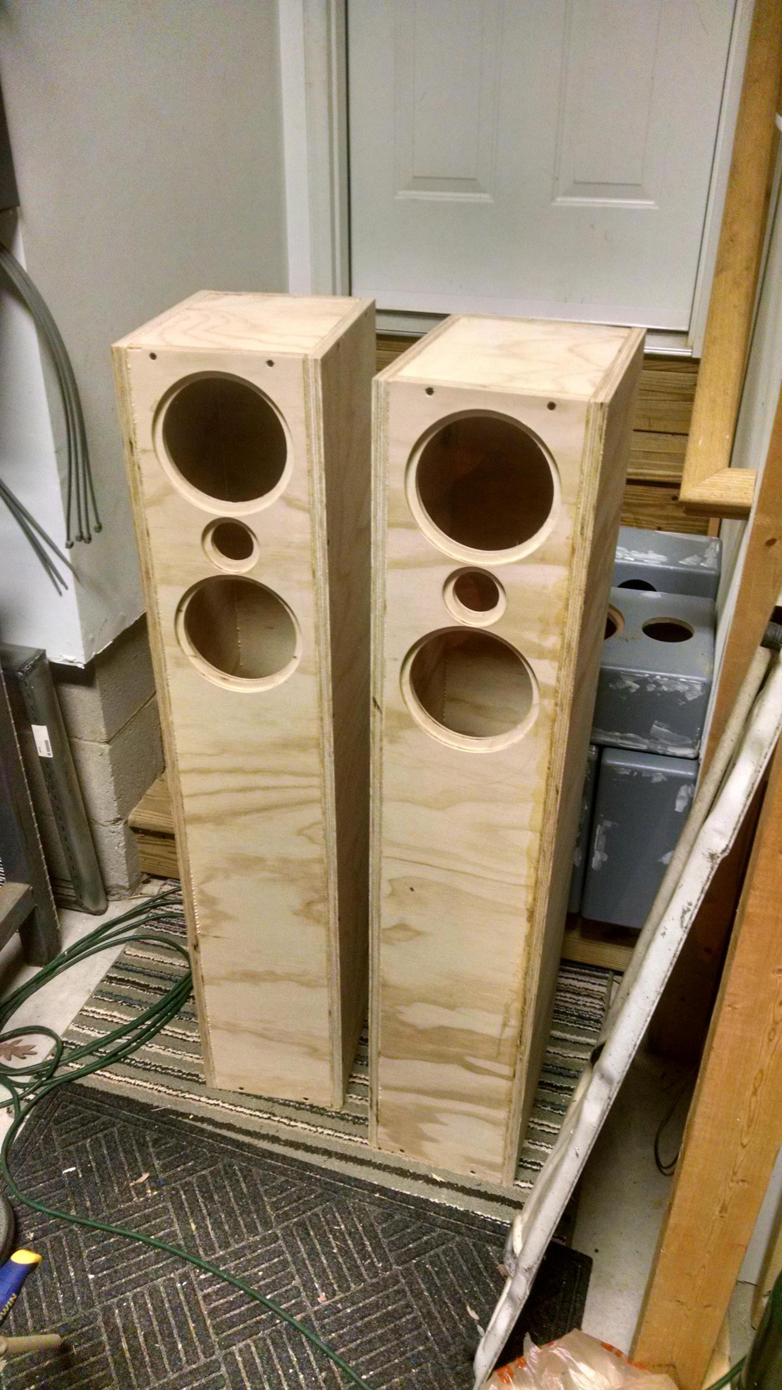

Today I got 2.5 hours to throw the pieces I previous cut together with some glue and temporary drywall screws. I also routed the face, and immediately screwed up and did the tweeter to the same depth as the woofer. I will have to glue in a spacer ring to bring it flush with the face.
I also still need to cut the holes for the ports and terminals. I am going to give them a listen with just a 3.3uF cap on the tweeter just for giggles / to get a baseline measurement which could count as a contest entry I suppose!

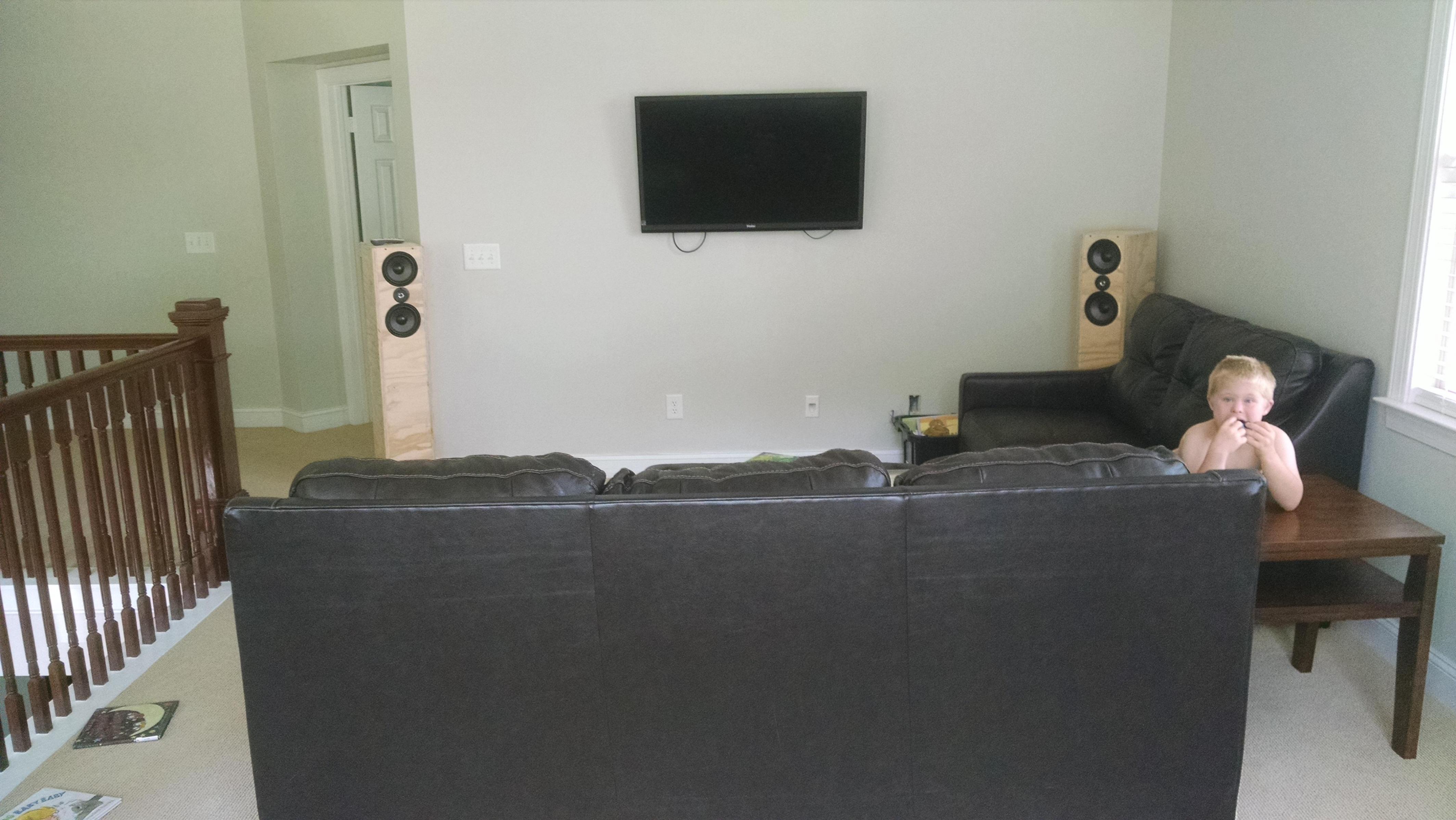

First listening. I did not round over any edges yet, or do any painting, and the crossover is a single 3.3uf cap I un-solderd from old car tweeters... I have not added the port yet either. I can tell it is boomy in the 100-120hz range for sure. I would call it a bit fatiguing actually.
Internal dimensions:
46.5" X 8" X 10.5"
woofers in series wired full range, tweeter has the 3.3uF cap.
Next step is to get some measurements, see where it stands, and then decide on the port or not.
Please ignore my eldest of 4 kids in photos, they were having a dance party. Listening area was impromptu set them up in the loft, which is about as 'prepared' of a listening setup as I will ever have lol.

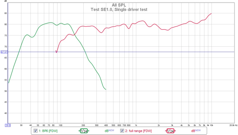

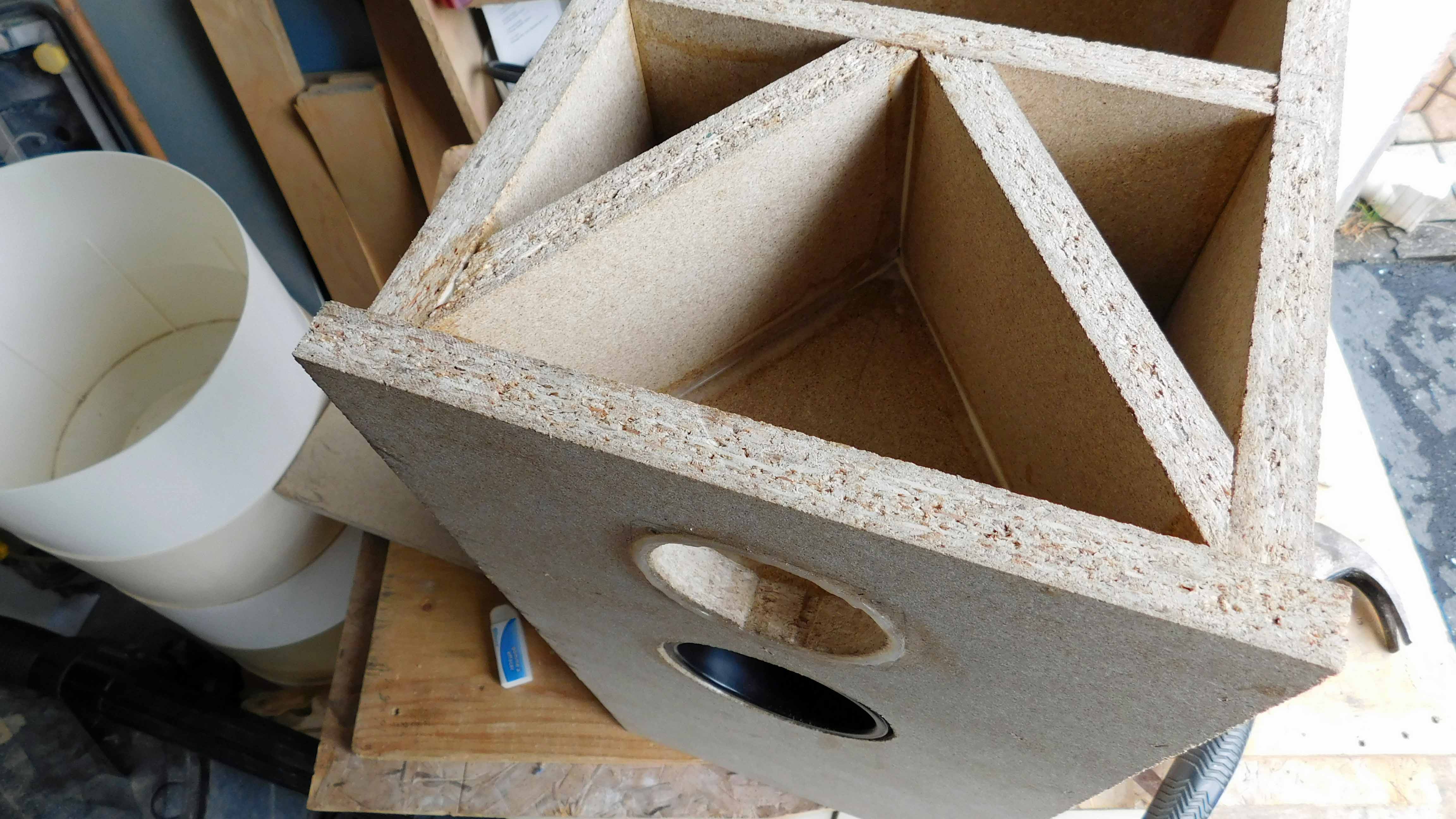

I thought I'd try a design using an acoustic cross over. There's a 6.5"woofer (TC-6028 for $12) in a BP6 config and a small 3" full range (PC83-8 for $10) in a sealed chamber.
Some assembly pics and the initial separate driver tests.
