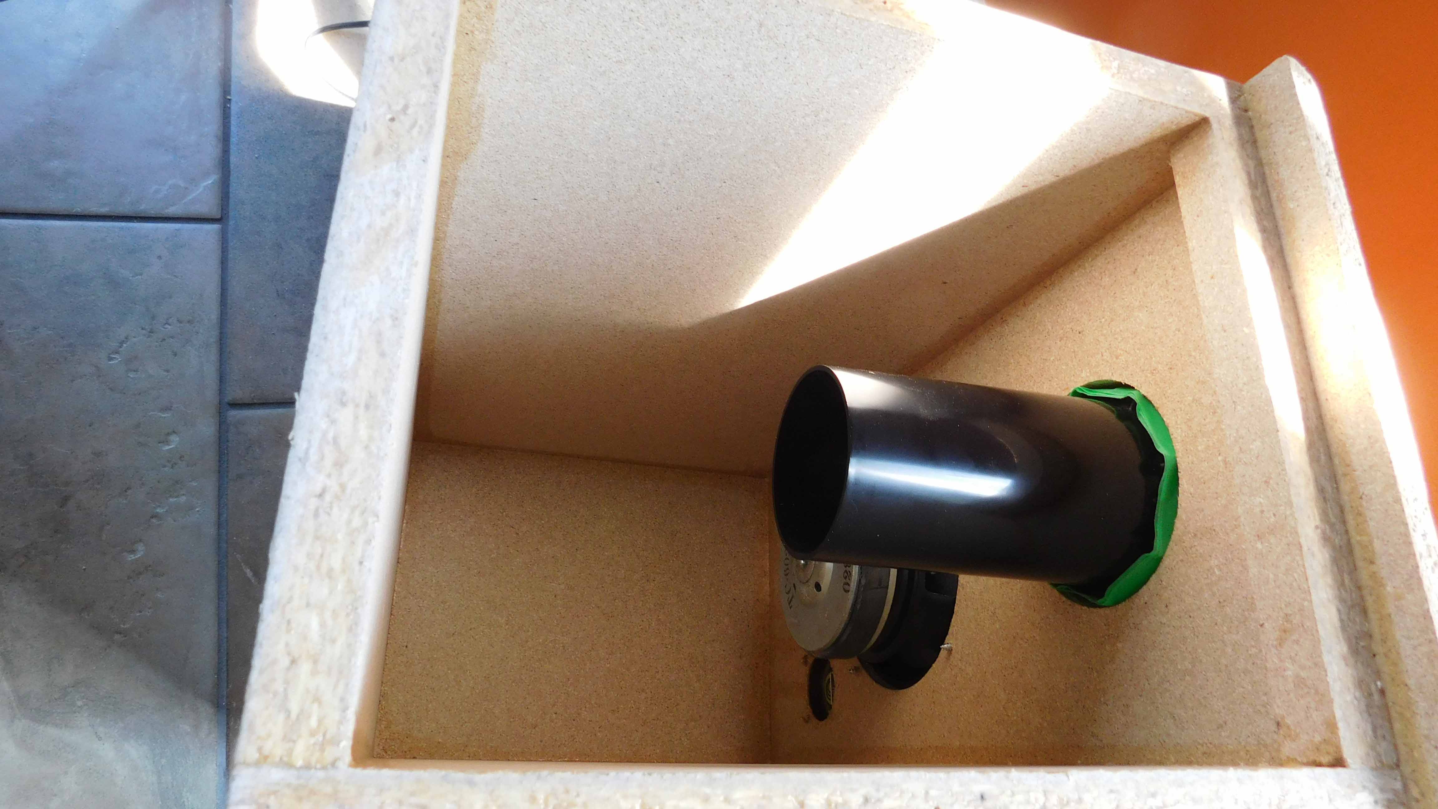

I settled for a single FR driver in a small ported box. Perhaps I could have done better with some of these TM designs?

Those measurements were separate driver tests just to verify the enclosure was sealed and leak free. The rolls off points and slopes were checked against the HornResp design and it matches very well.

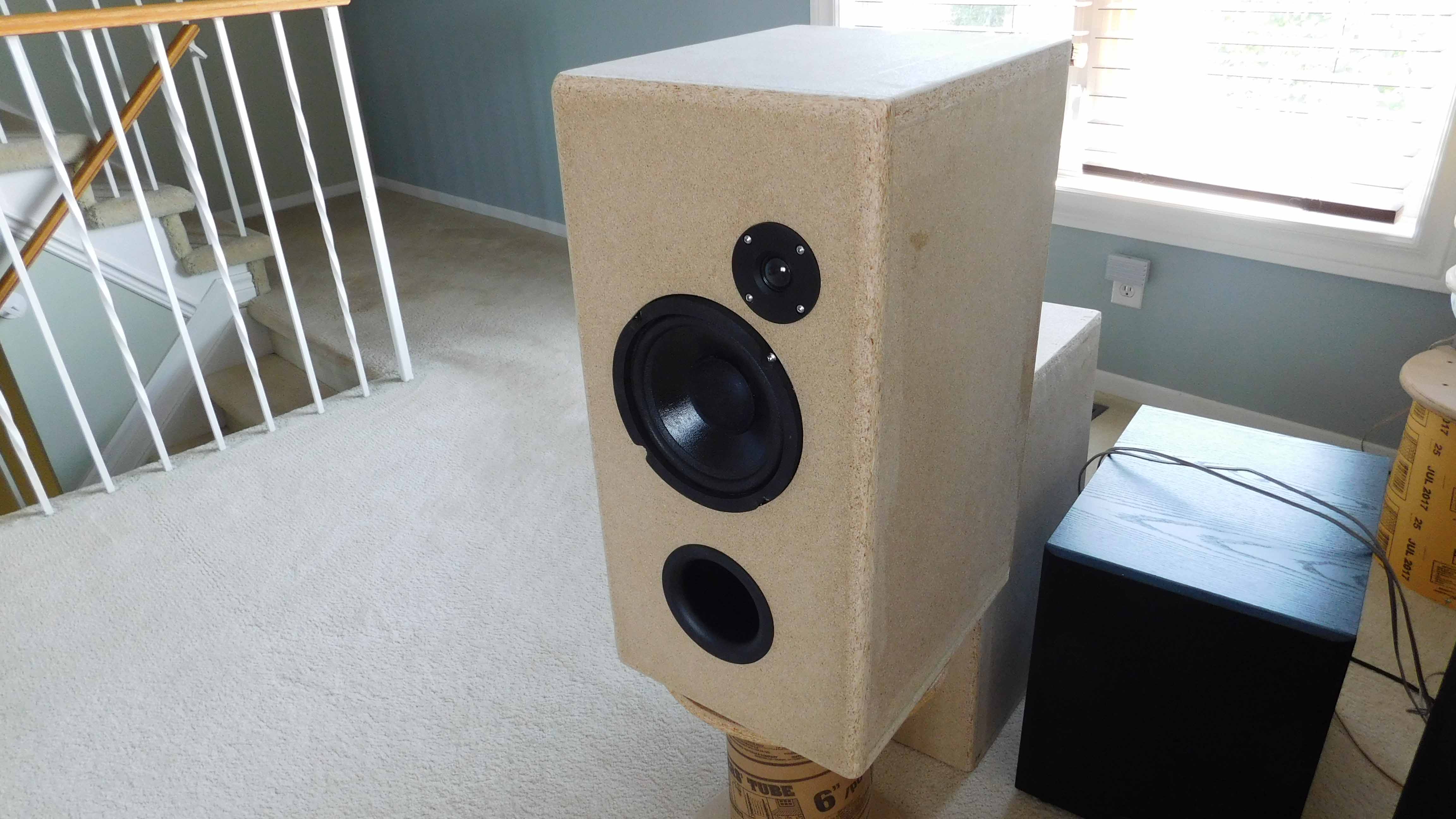

Traditional 2 way

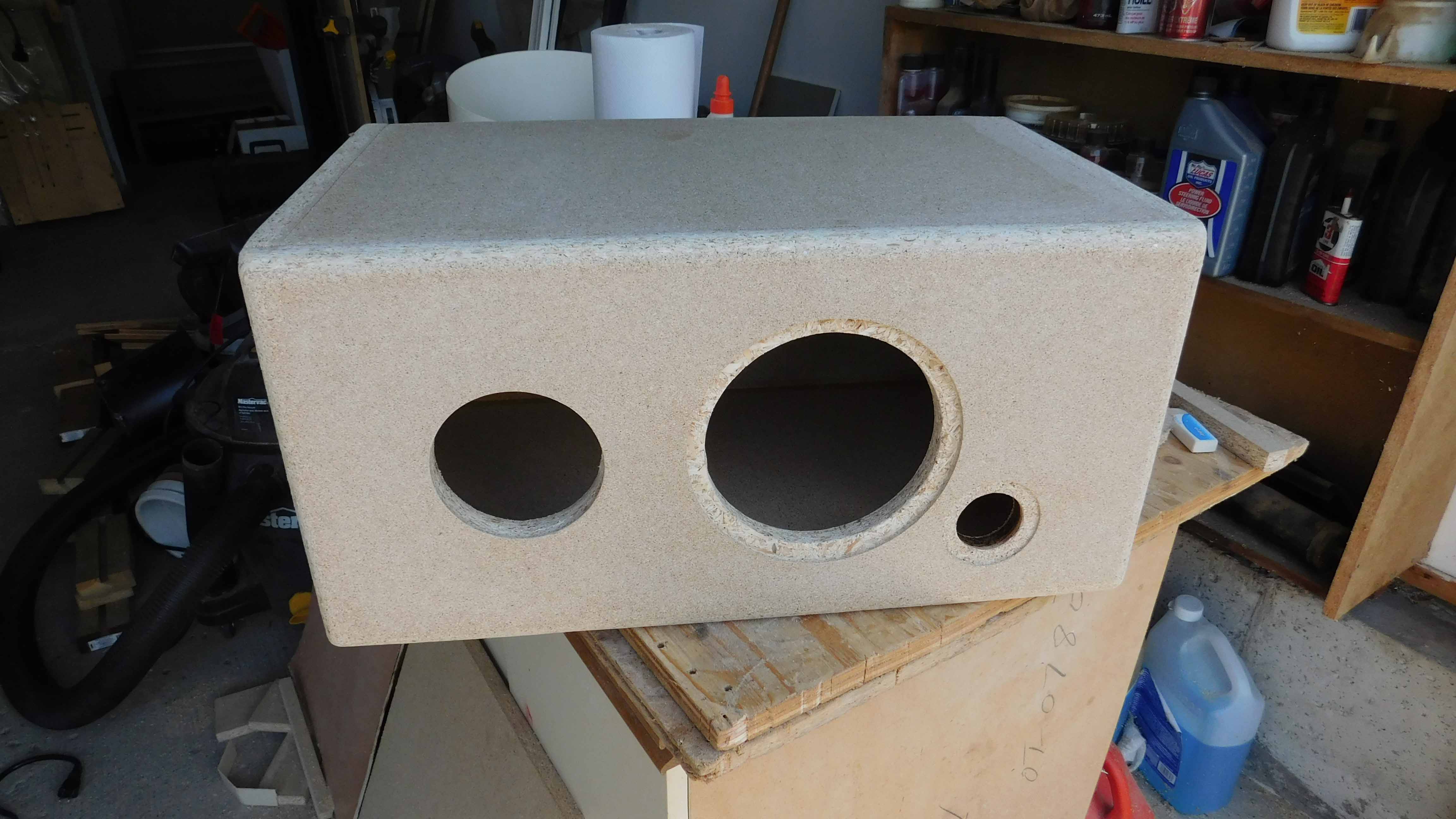

This is my second, a more traditional bass reflex design. It uses a 6.5" woofer TC-6028 ($12, same as in previous BP6) with a small tweeter TD20F-4 ($8) leaving me $10 for XO parts (still waiting for parts delivery ).
A few construction pics.

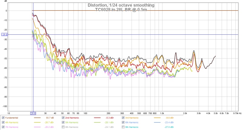

Thanks. The drivers have to be pretty cheap for me to take a chance on them when basic data is missing. The reviews and ratings seem to indicate people do like these, and at $12 it's less than lunch :). I have no complaints so far about this driver (TC-6028).

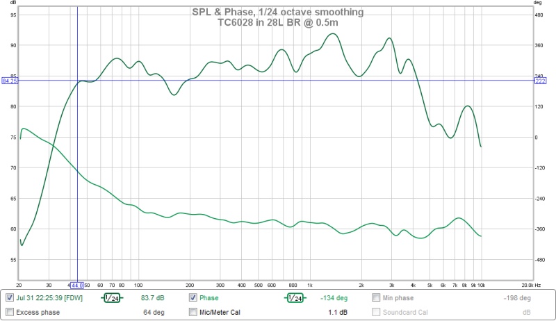

I ran a few tests to check the box tuning and the driver. It's pretty close to the HornResp predictions using the average T/S parameters that I could find. Since the port is out the front, the response is for both combined at 0.5m. I think it's a little bumpy because there is no fill in the cabinet. I needed it to hit 3Khz for the XO to the tweeter and it just makes it :D. That's a bargain for $12.

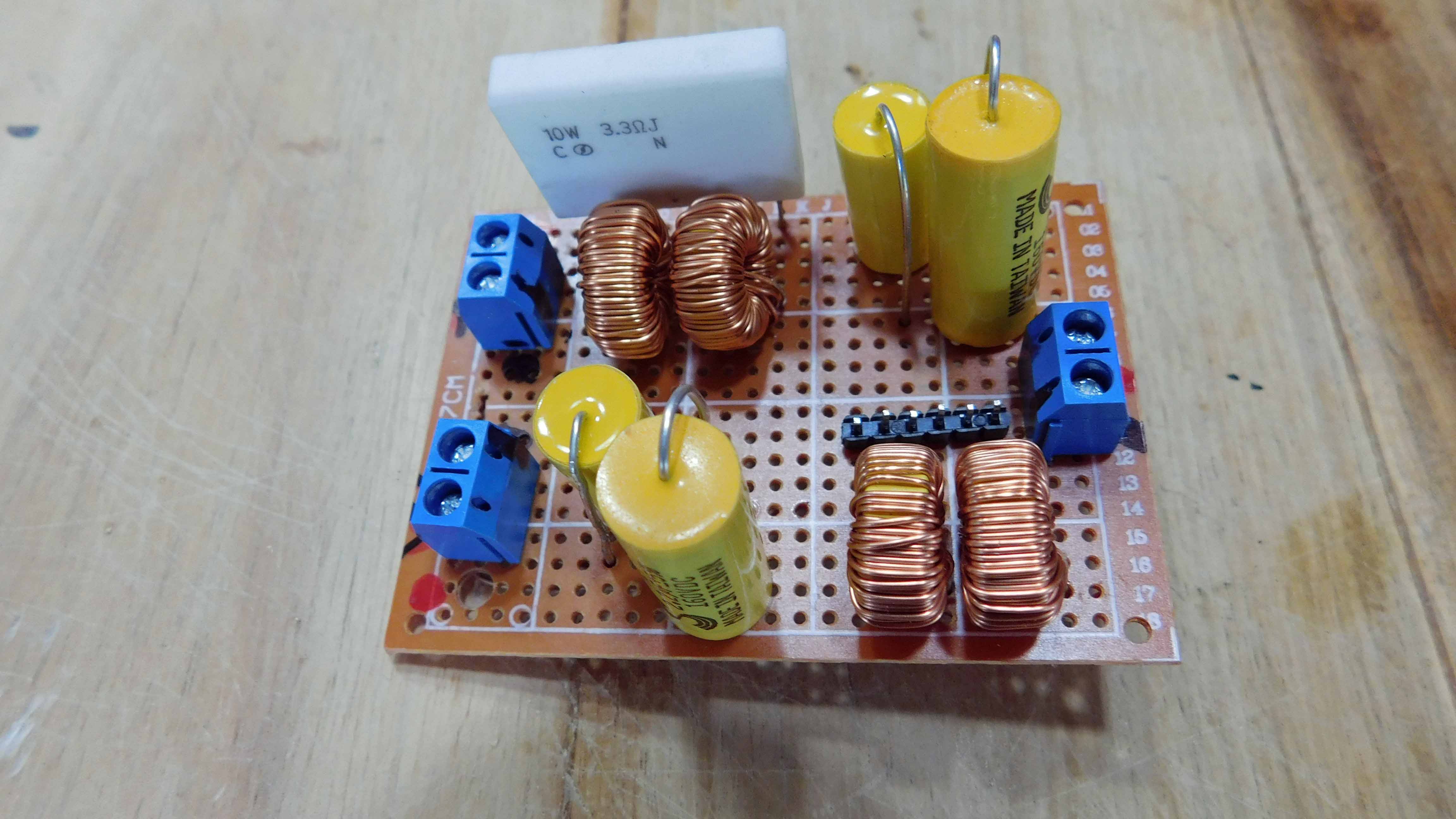

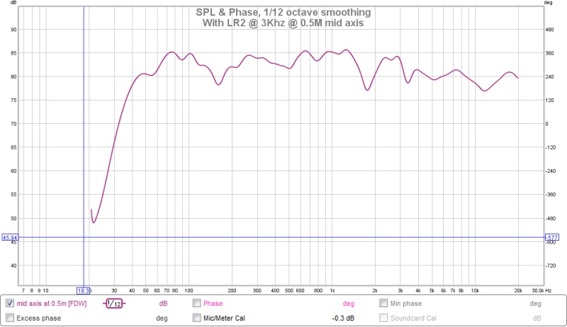

I received some parts and scrounged others to make up an LR2 @3Khz.
I was looking at these really low cost inductors typically sold from the far east. There are no specs other than the inductance. However they must have high magnetic permeability cores in order to get that much inductance in a small low cost package. I prefer air core inductors, but these were cheap enough to take a chance. :) Pic#1 shows them.
The tweeter is attenuated to remove a rising HF curve and produce a flatter but attenuated curve. Graph#1

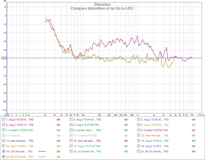

The downside. The cheap inductors are in series with the woofer and cause a significant increase in THD (100Hz-2Khz, graph#2). I added the woofer's THD curve without XO as a reference point. The distortion can be noticed, as some passages of music have less clarity and detail. [sigh]. On the upside, it sounds more complete (full) with the tweeter running, and THD is not included in the contest :D

They look like the sort of inductors used in cheap PC power supplies. Quite a substantial increase in distortion for sure. I always thought that distortion with cored inductors was a problem if they were saturated, but this would suggest (at least with this type of inductor) it's not the case!
Tony.
True, they are usually used as filter chokes in power supplies. Mine will eventually find their way into a power supply filter but I thought I "might" get away with it on this LR2 . I suspect its the usual hysteresis and eddy current losses that are a poor choice for an speaker filter. It's very unlikely the core is saturated, I use low power for testing. It would be interesting to test the saturation effect idea to see if distortion gets worse with increasing power.
Thanks for the links, its a good idea. If I can find a donor I'd give it a try.

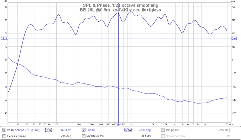

Another XO + fill for the BR 28L
This is an attempt to smooth the FR out a little more.
I created the FRD and ZMA files (REW export) for the woofer in the cabinet. Loaded them into Xsim with the files for the TD20F and played with the XO points until I got it as smooth as I could.
I also went in and added acoustic tile to the back (behind the woofer) and fibreglass fill to the bottom (port is not blocked) to dampen internal resonances and reflections. It had very little effect.
Included is the Xsim prediction and the actual measurement. I think that's as good as I can get it. Suggestions welcome.
