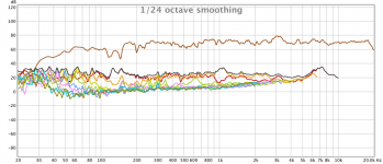

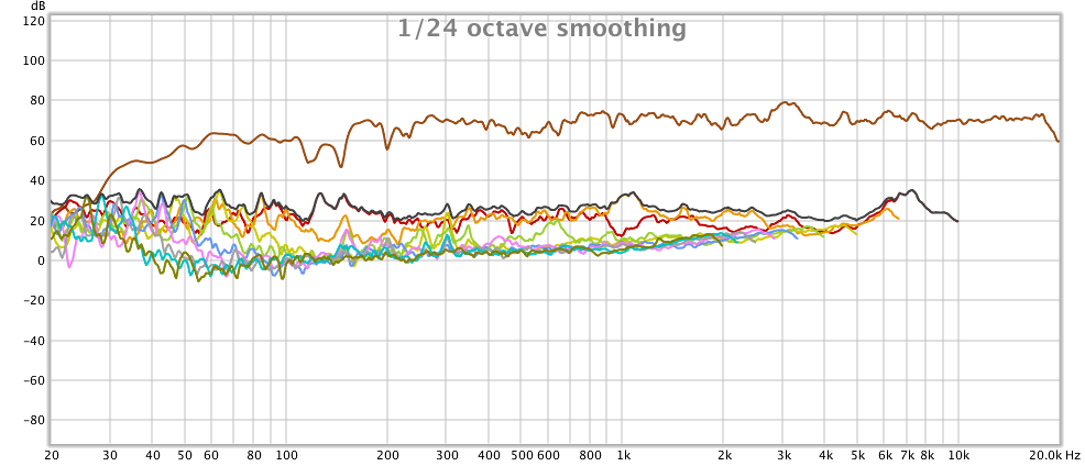

So I figured out the boominess on mine was the home theatre receiver I was using had a loudness, aka +10db at 100hz turned on which could only be flipped via the remote. I decided to get a measurement before I added the port. This is a single 3.3uf cap on the tweeter as the entirety of the crossover. 1/24 smoothing.
I am tempted to run the woofers in parallel instead of series.. not sure the tpa3116 amp I use for testing will like that though...

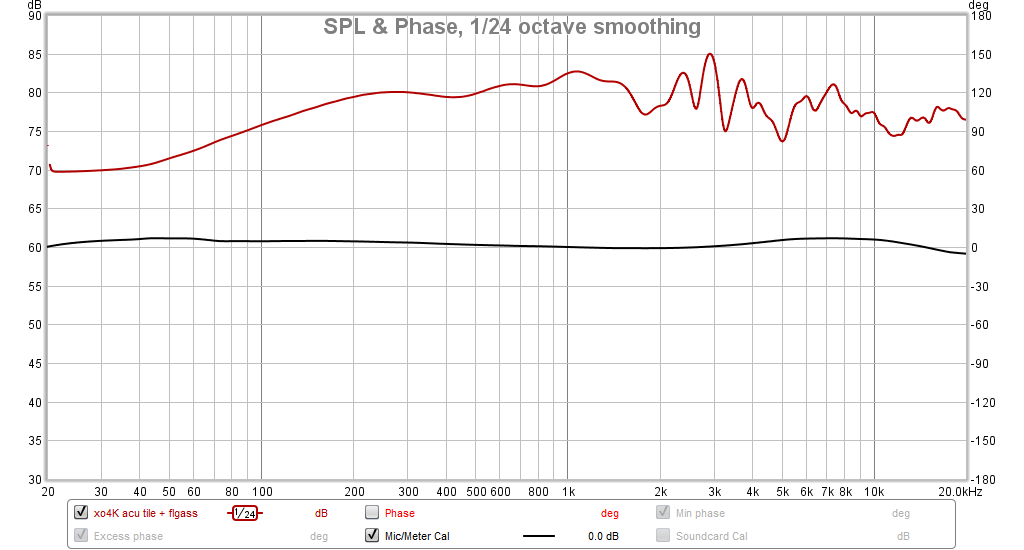

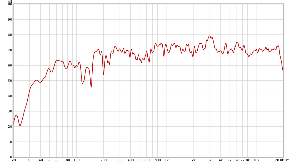

This is an attempt to smooth the FR out a little more.
I created the FRD and ZMA files (REW export) for the woofer in the cabinet. Loaded them into Xsim with the files for the TD20F and played with the XO points until I got it as smooth as I could.
I also went in and added acoustic tile to the back (behind the woofer) and fibreglass fill to the bottom (port is not blocked) to dampen internal resonances and reflections. It had very little effect.
Included is the Xsim prediction and the actual measurement. I think that's as good as I can get it. Suggestions welcome.
Was the actual measurement the in room measurement? It seems that the low end is showing room modes, that weren't in the crossover modeling. Could you post a gated measurement?
Tony.
Tony.
When I measure the driver in the cabinet (for Xsim) it's near field and gated to exclude the baffle and port. My speaker in room measurements are gated [-50/100ms and 8 cycle FDW] taken at 0.5m to include the port effect and baffle that's why you see the LF extension. Limiting room modes is difficult but I have a measurement placement and arrangement that controls them to a large degree. I'm now thinking it could be box resonance, the baffle or floor reflection that is causing that bumpy response.
Could you upload the raw REW measurement? I would set the window to -50/3 or 4 for in room with no FDW!! I'm pretty sure your lumpy response is from room modes!

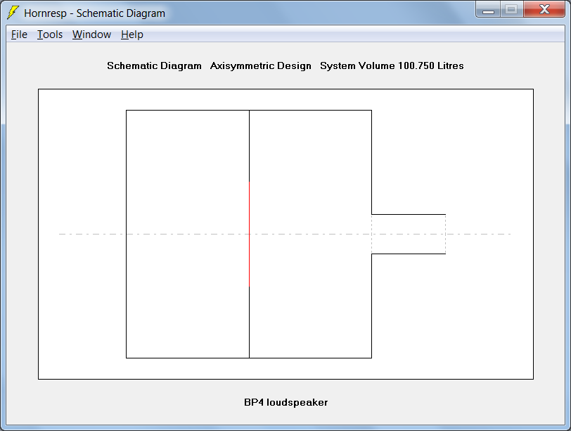

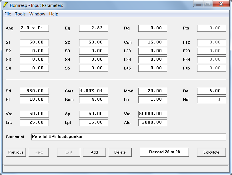

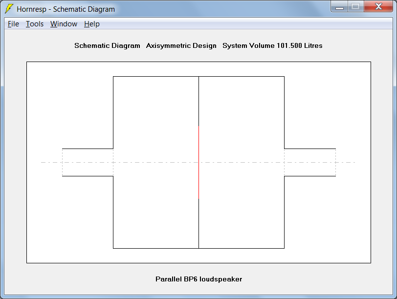

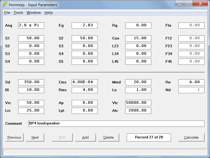

how does one quickly simulate BP4 in hornresp? (the input option doesn't have BP4 nor parallel BP6)
Hi freddi,
BP4 and parallel BP6 configurations are not included as input options because they can be readily specified using the standard "building blocks" available to the user.
Attachments 1 and 2 - BP4
Attachments 3 and 4 - Parallel BP6
Kind regards,
David

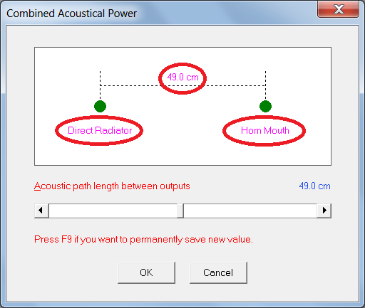

(you can tell how lazy I am - ) Thanks David. I'll do a few of those til it gets in my head. Another question - when simulating a back loaded horn, I assume center of the mouth to center of the driver distance is used for the summation (?) - this is an eyeball guess for JBL's "Harkness"
Hi freddi,
Your assumption is correct :).
Each output is treated as a point source, so the centre to centre straight-line distance is the one to use.
Kind regards,
David

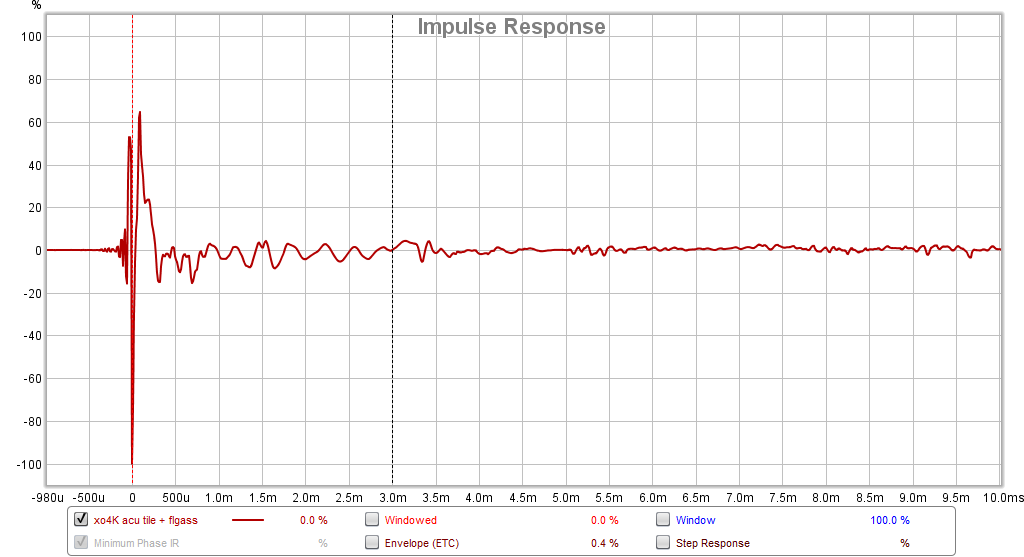

Thanks, another set of eyes on the problem is always welcome.
Even a single measurement record exceeds DIYaudio download size limit, so here is a MS onedrive link to download it https://1drv.ms/u/s!Av9kEnUVCPEugmahR5OBitqJMBlw
Pretty sure your measurement has a lot of room influence. The impulse is flattening out by about 5ms, BUT It still looks pretty choppy even with 5ms gating. with a 3ms gate (which means only the curve above about 350Hz is really valid) it takes most of that nastiness out between 300 Hz and 2K. I suspect it is more representative of the quasi anechoic response.
I suspect you had some objects pretty close to the speaker when you measured? If I'm measuring inside I try and get the furniture all moved to one end of the room, set the speaker up in roughly the middle of the room, with the speaker and mic axis not parallel to any wall. If you are measuring at 1M distance then you ideally want at least that distance between the speaker and any other object as well.
Tony.

Thanks Tony.
I had a chance to think about your testing approach and its given me a few ideas to try. With a short gate time (using approx 3ms/m) I should be able to move a single piece of furniture and see its effect. Also by sequentially stepping back measurements from near field to far field I should see more of the room appear. It'll take me a day or so and I'll post the results.
