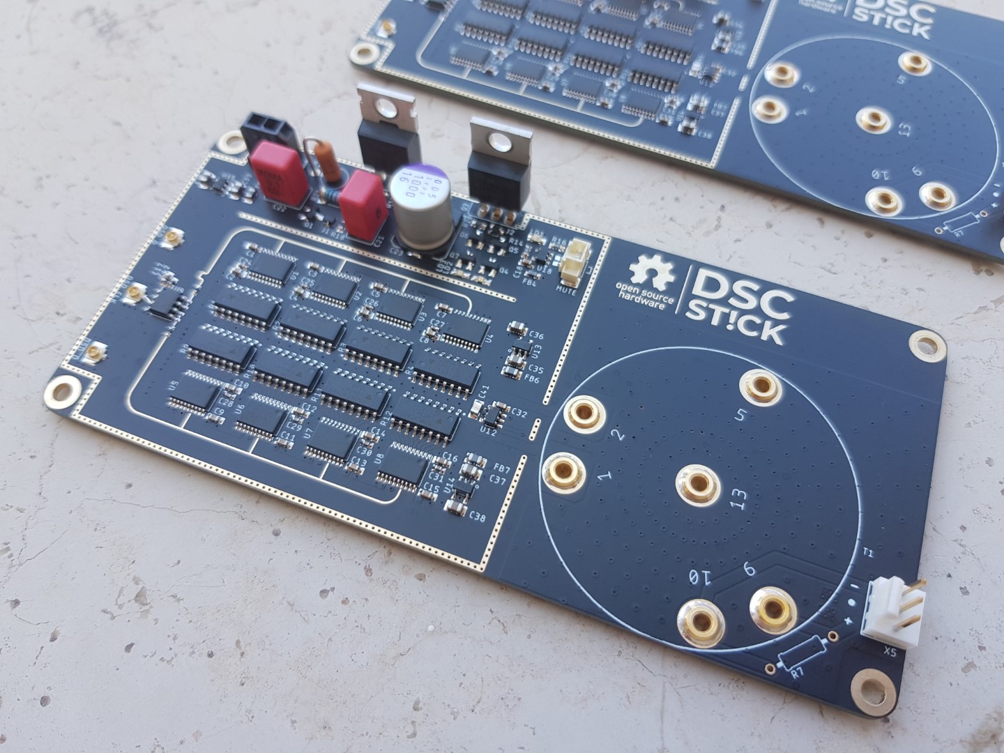

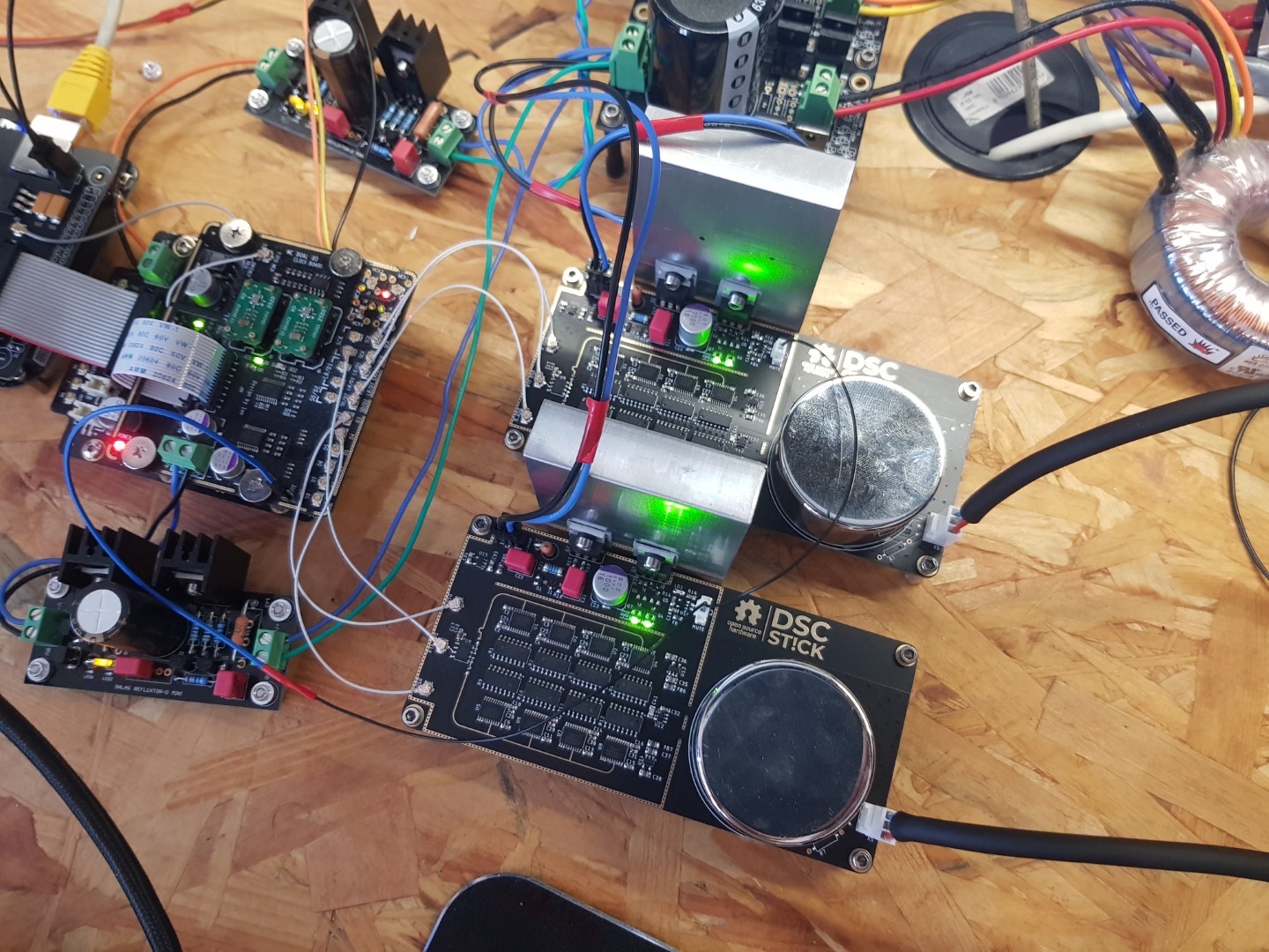

Well,
a little late on my self-imposed schedule.
Sticks are assembled and tested inside and out.
They are running fine, simple and exceptional.
Now its time to take care of the docs...

Well,
@gionag : I cannot see it well in your pics, what is the oscillator solution you are playing with ? Is it something that you have also developed for the DSC ?. It looks super neat :)
