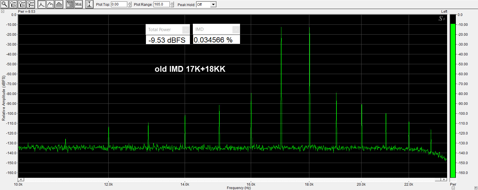

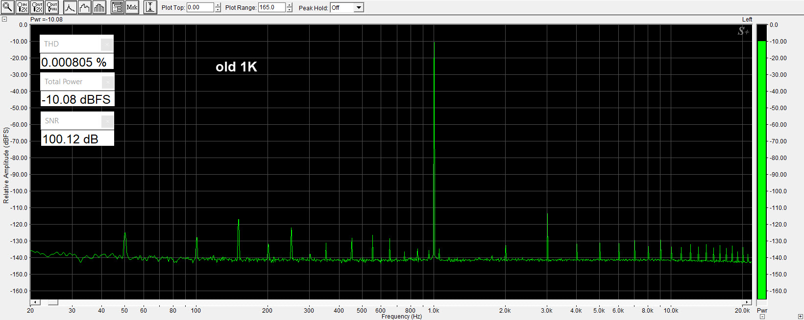

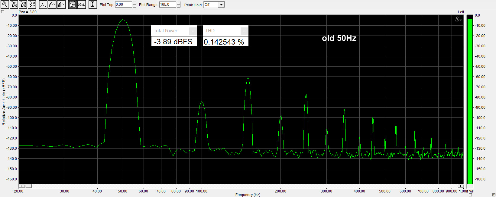

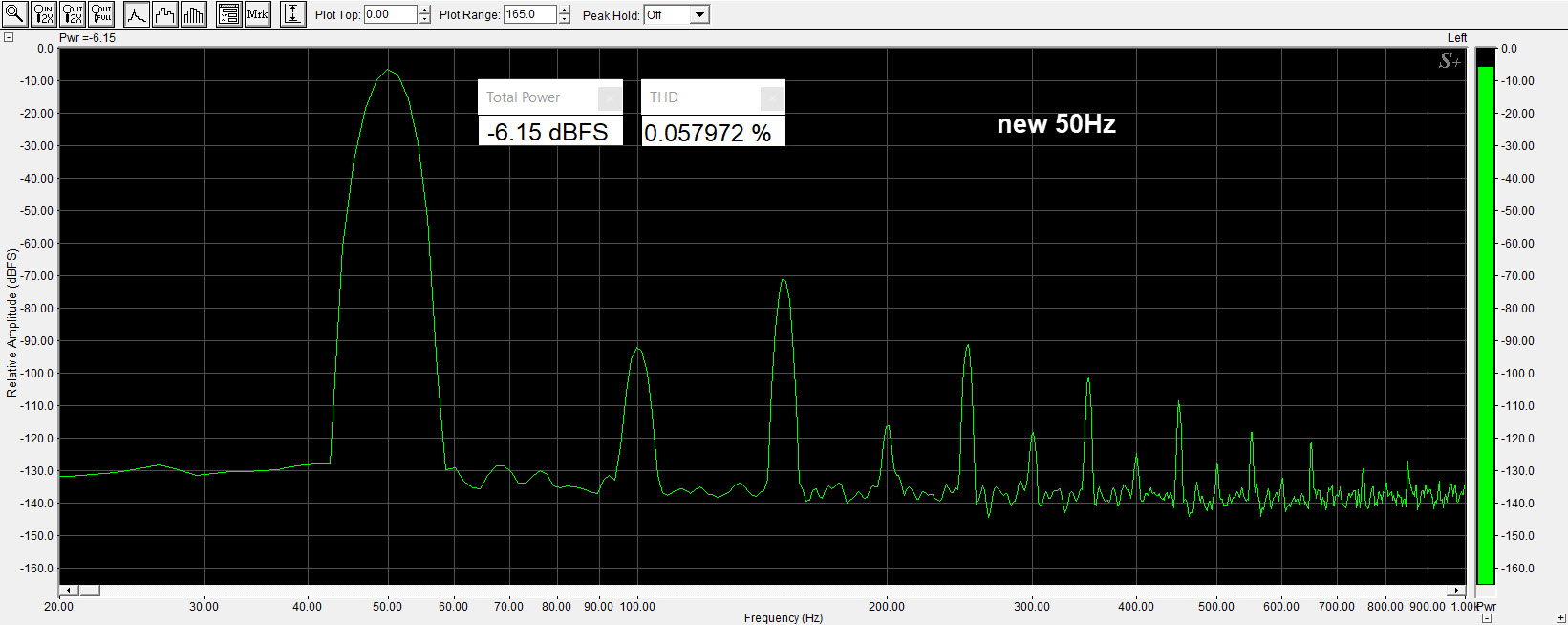

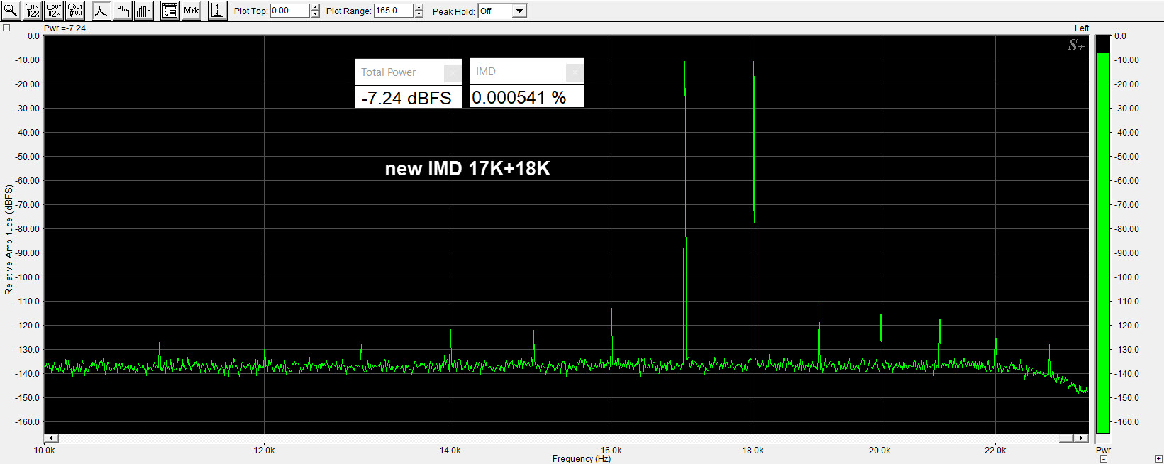

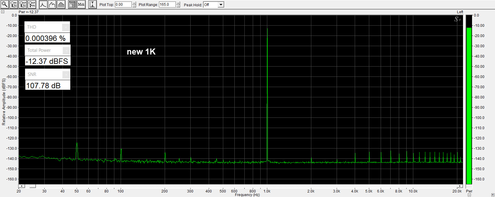

Newer versions of transformers sound very good. And their measurements are also very good. This is practically the limit for my E-MU 0204.
