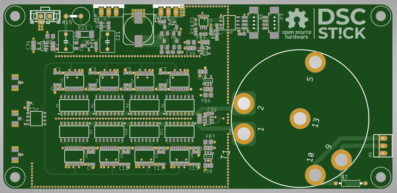

currently working on not-so-original rendition of the dsc.
"dual mono" with shunt power supply.
uses the Mcfifo as reclocker/isolator/buffer.
differential signaling generated at the source (in my case a BBB).
timing and impedance correct (i hope...)
for the moment i have put the OpenHardware logo on it... but i have to triple check before thinking to release it because uses a well-renowed topology for shunt and i guess it infringes some policy. If i can't i will release the project without the power supply on it.
keep you posted.
attached a very early prototype that needs much more work at the moment, just to tease and start some more inspired people than me to comment on it and maybe shout some suggestions

what kind of screw will be mounted ? i guess till M4 we are fine with the already available pad.
just out of curiosity... have you kept the delay track between the ShiftRegister-Clock and the Storage-Clock ?
never experimented with them, but i have a 2.6.2 without them, and a DSC2 with it.
both worked fine.
have you kept them or you have straigt-shorted storage and SR clock (like 2.5/2.5.2/2.6.2) ?
thanks
Ivan just confirmed that there will be an internal nut M3
both worked fine.
Right. I also see no reason to delay. Datasheet 74LVC8T595 allows these inputs to be used simultaneously.

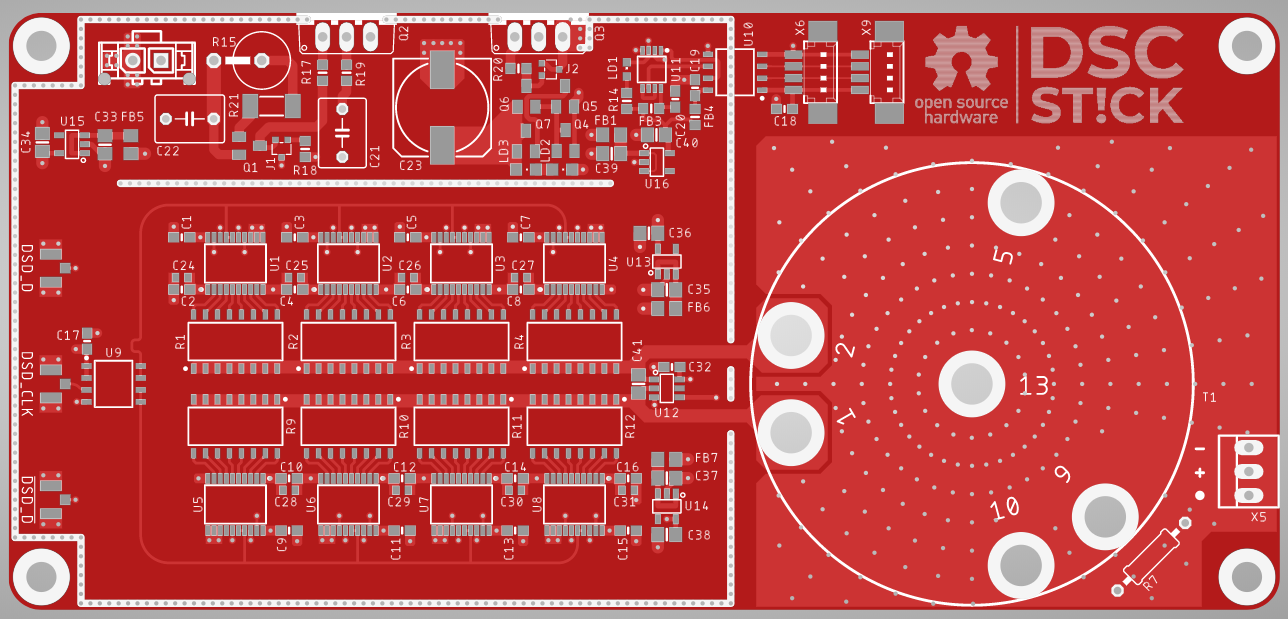

some minor tweak... i am proceeding with the protype

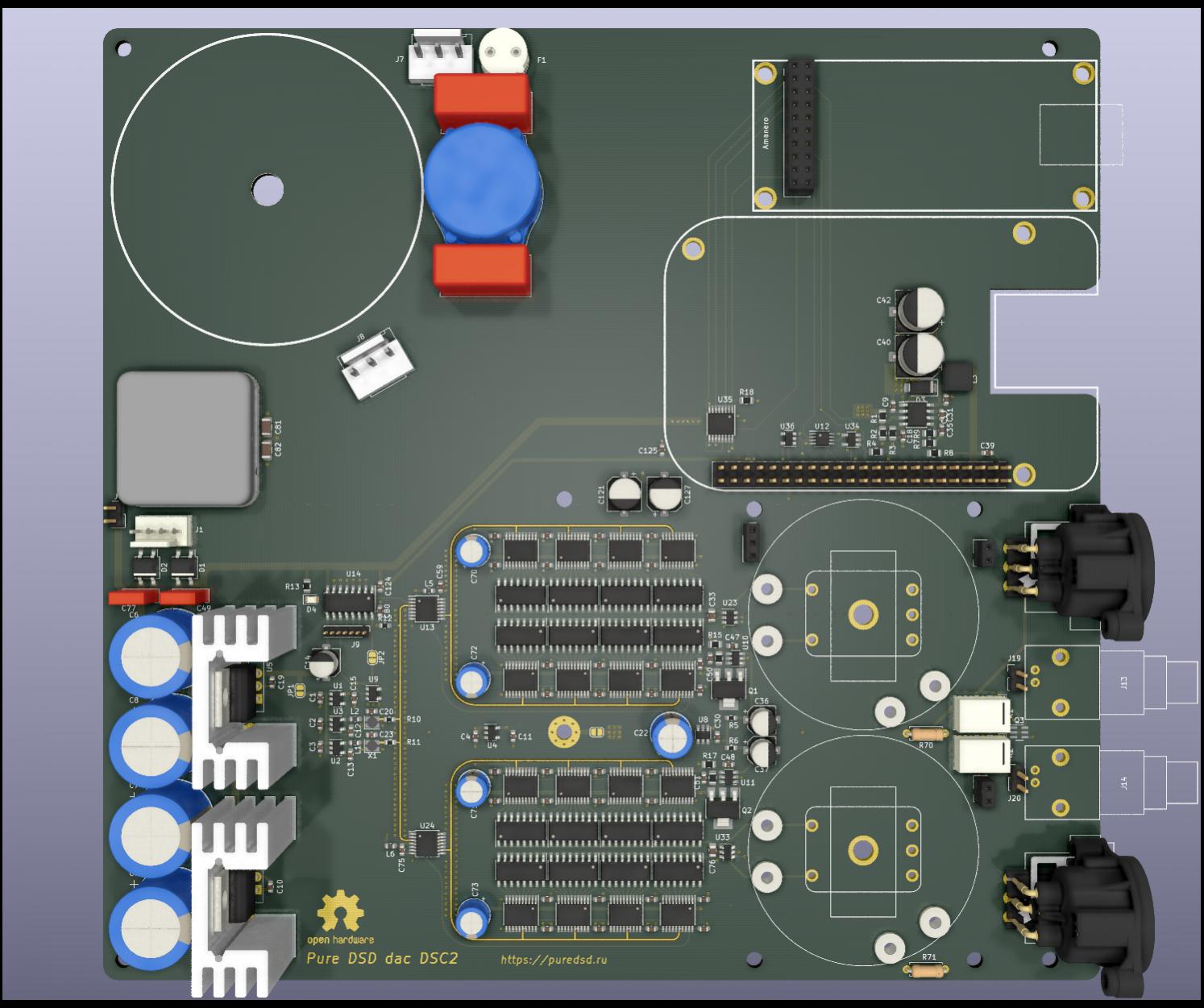

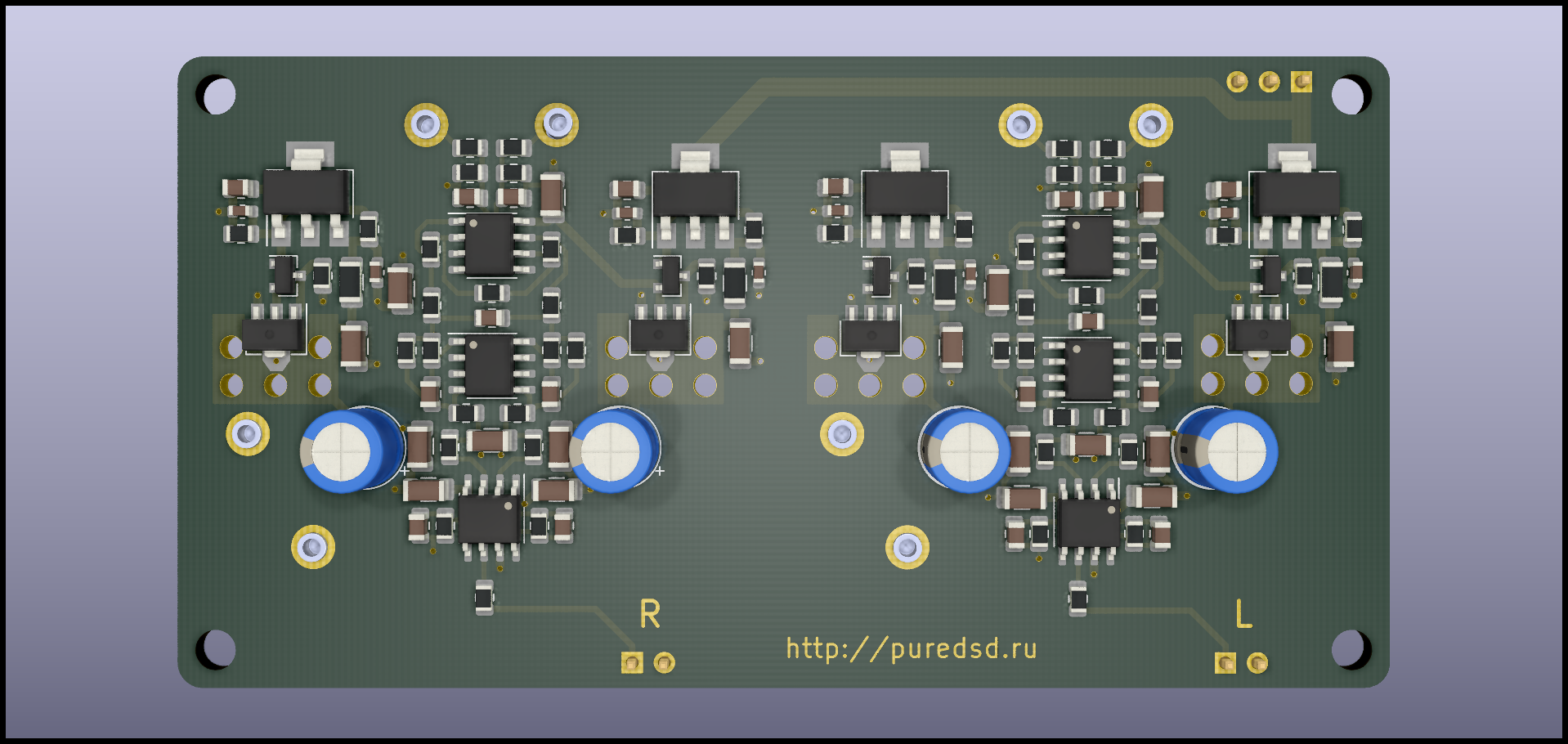

I decided to stop working on the DSC2 project.
The development of the latest version of DSC2 is completed. But not yet implemented as real PCBs. I hope someone can bring this version to its logical end.
I offer a complete set of project files in the KCad format - http://puredsd.ru/dsc2expra_rel.zip.
The project documentation and source code is published on an “as is”.
The project consists of two parts:
  1. main - main PCB DSC2 with transformer output and Open Hardware License. Interactive BOM for KiCAD
  2. output_nazar - active output PCB for replacing transformers. Circuit decisions are taken from open sources. But do not support Open Hardware License Interactive BOM for KiCAD
Thanks to Jussi, as the author and everyone who helped to develop this project.
