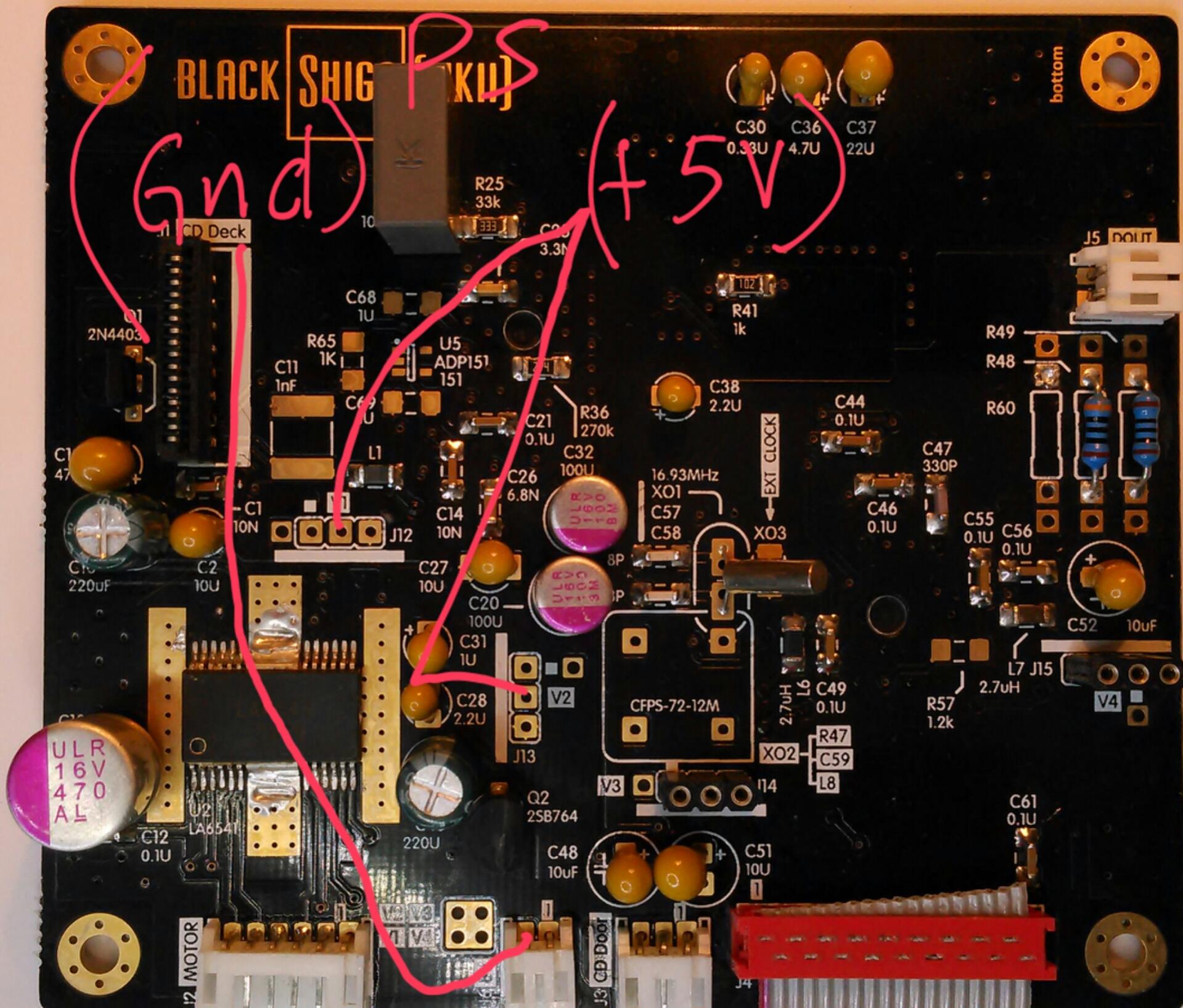

v1 and v2 ps

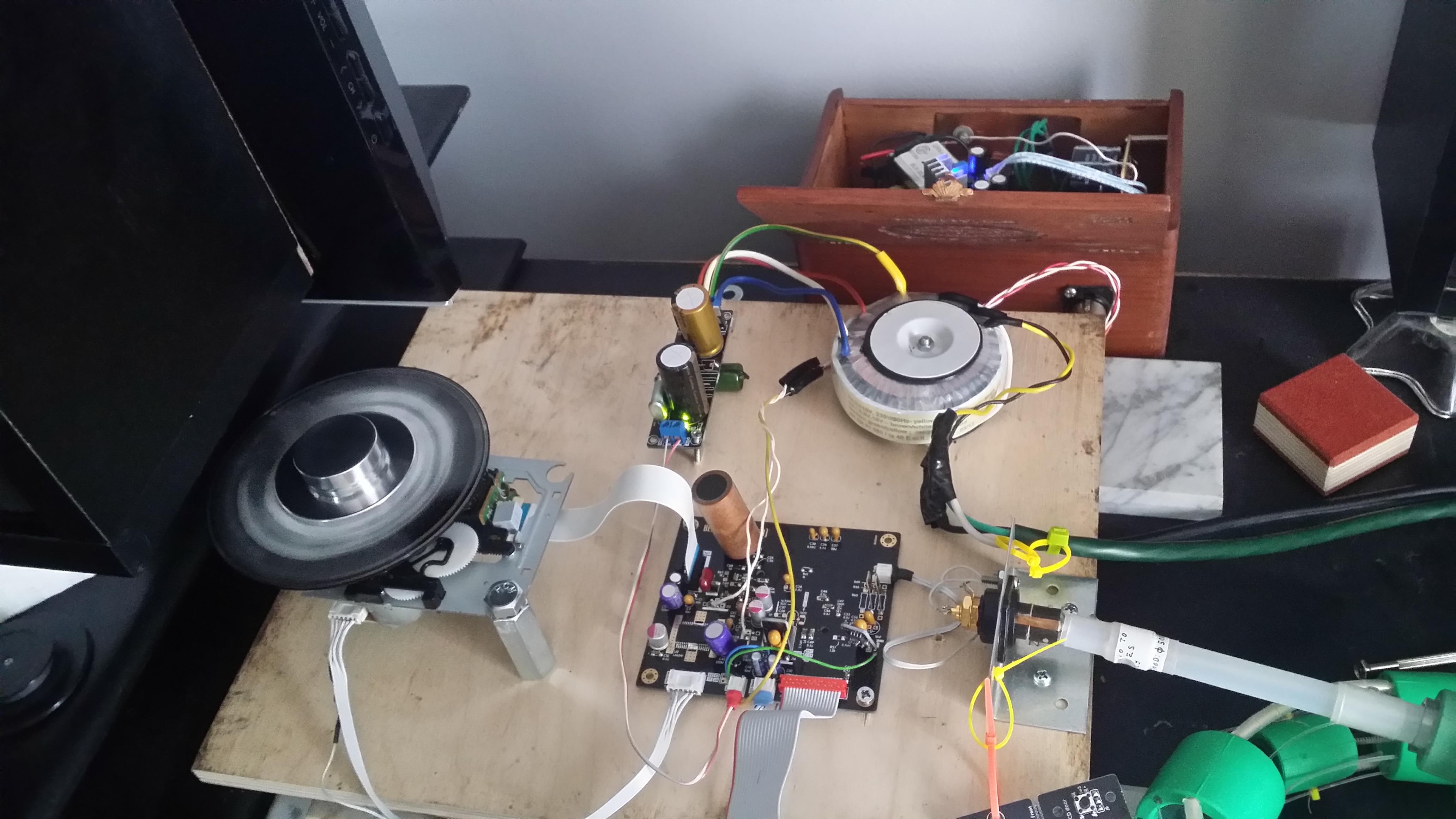

hi tibi,
before i make a big mistake, please verify on the pic attached that im doing the right install for v1 and v2 power supply.

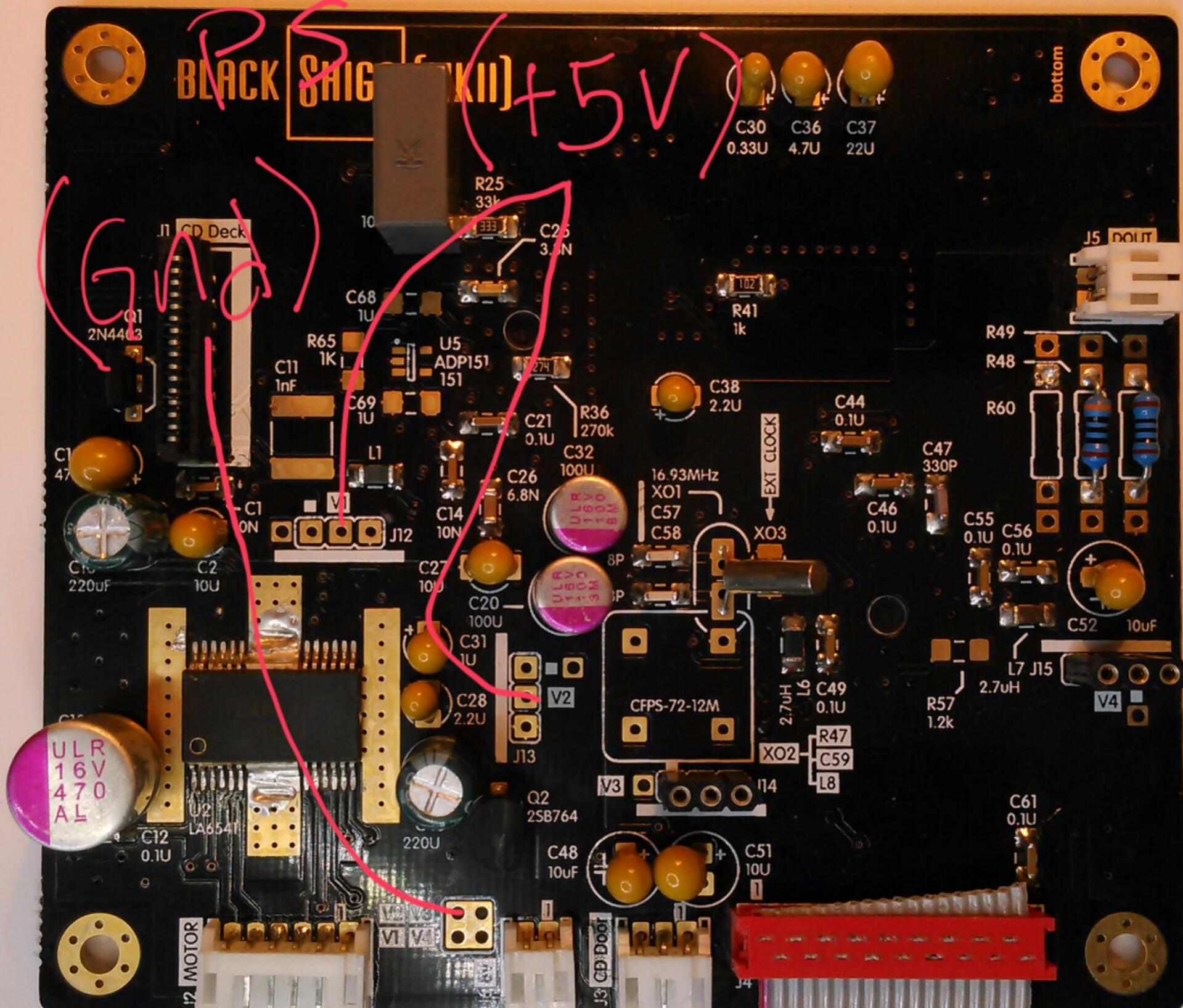

hi tibi,
or this one? just making sure im doing the right install.

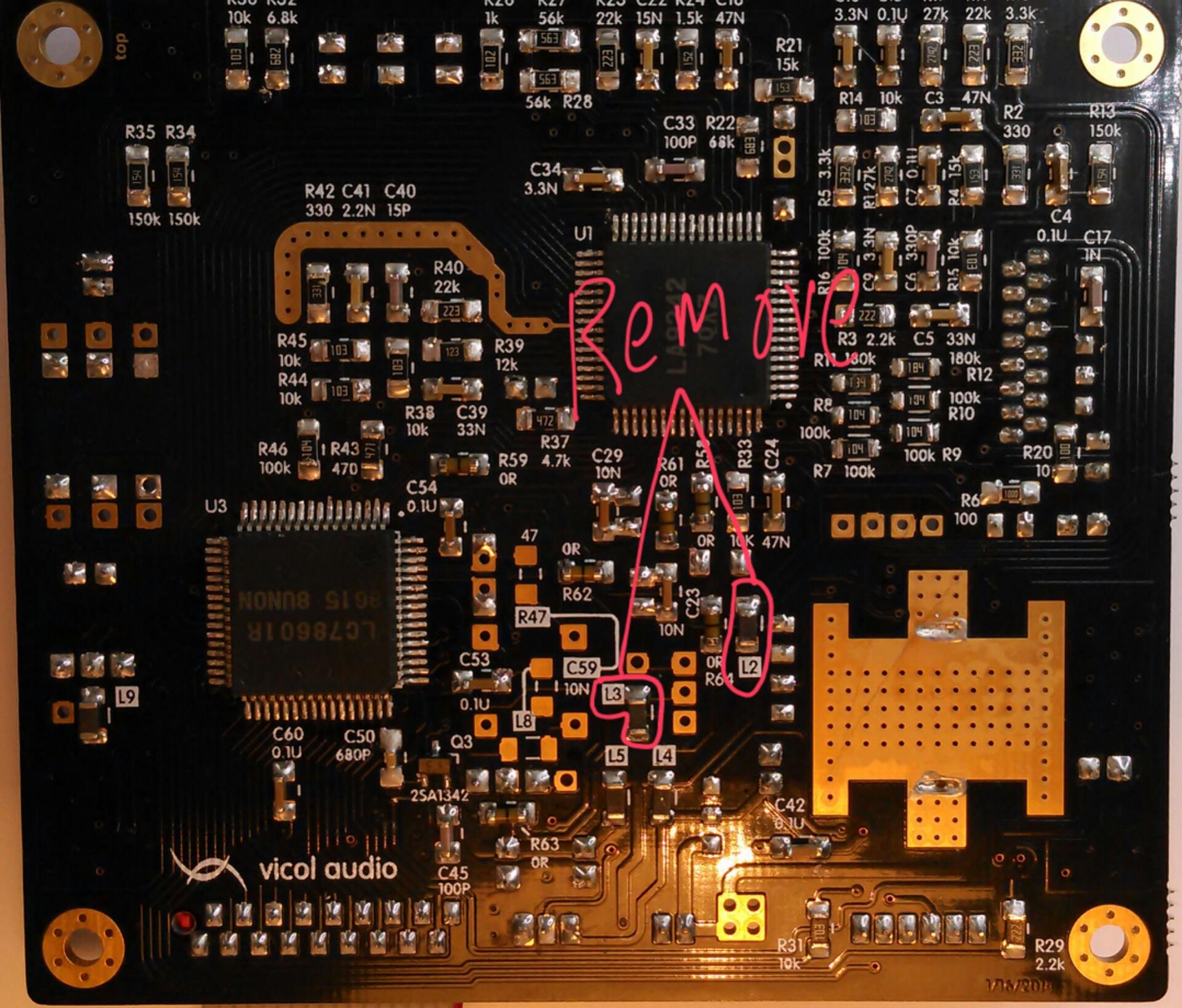

Yes, this is correct. For more detailed info related to miniregs pin assignment vicol audio : Low noise LDO mini regulator
V1, V2, V3, V4 is 8V pad not GND. Anyhow you'll not use this as power input, due your super-regulators will need a higher power supply above 8V depending on the type you use - refer to manufacturer super-reg datasheet.
As mentioned by Danzup, in case V1 and V2 are mounted, respectively L2 and L3 must be removed.
Tibi

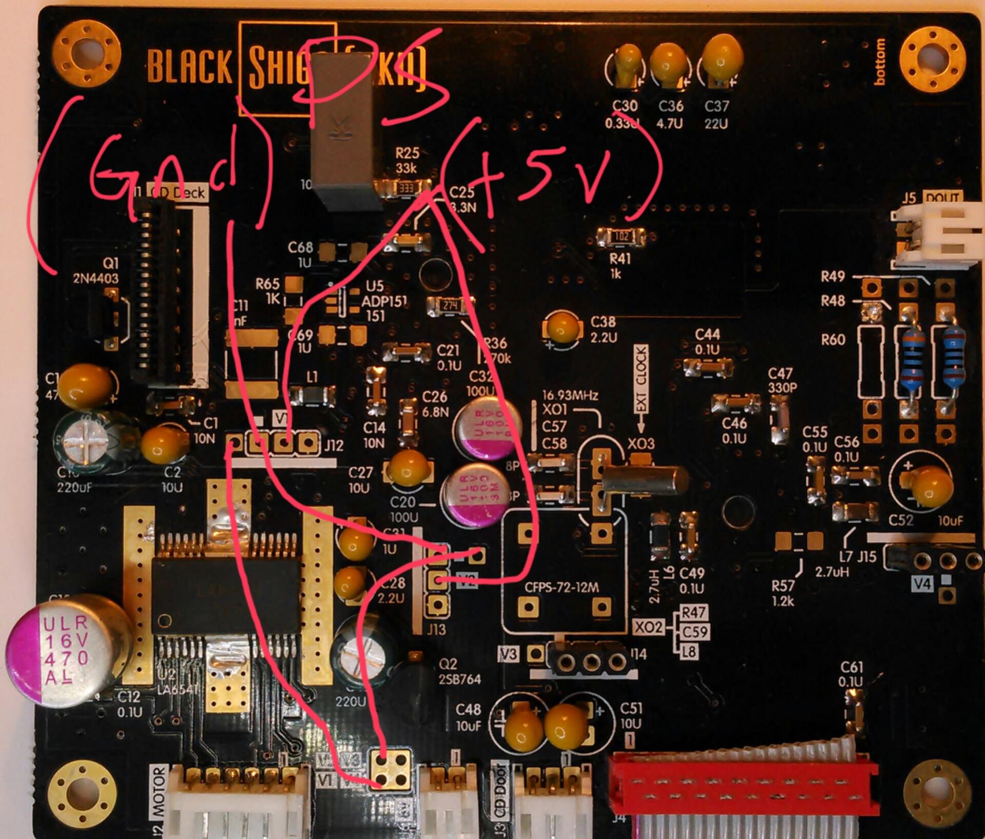

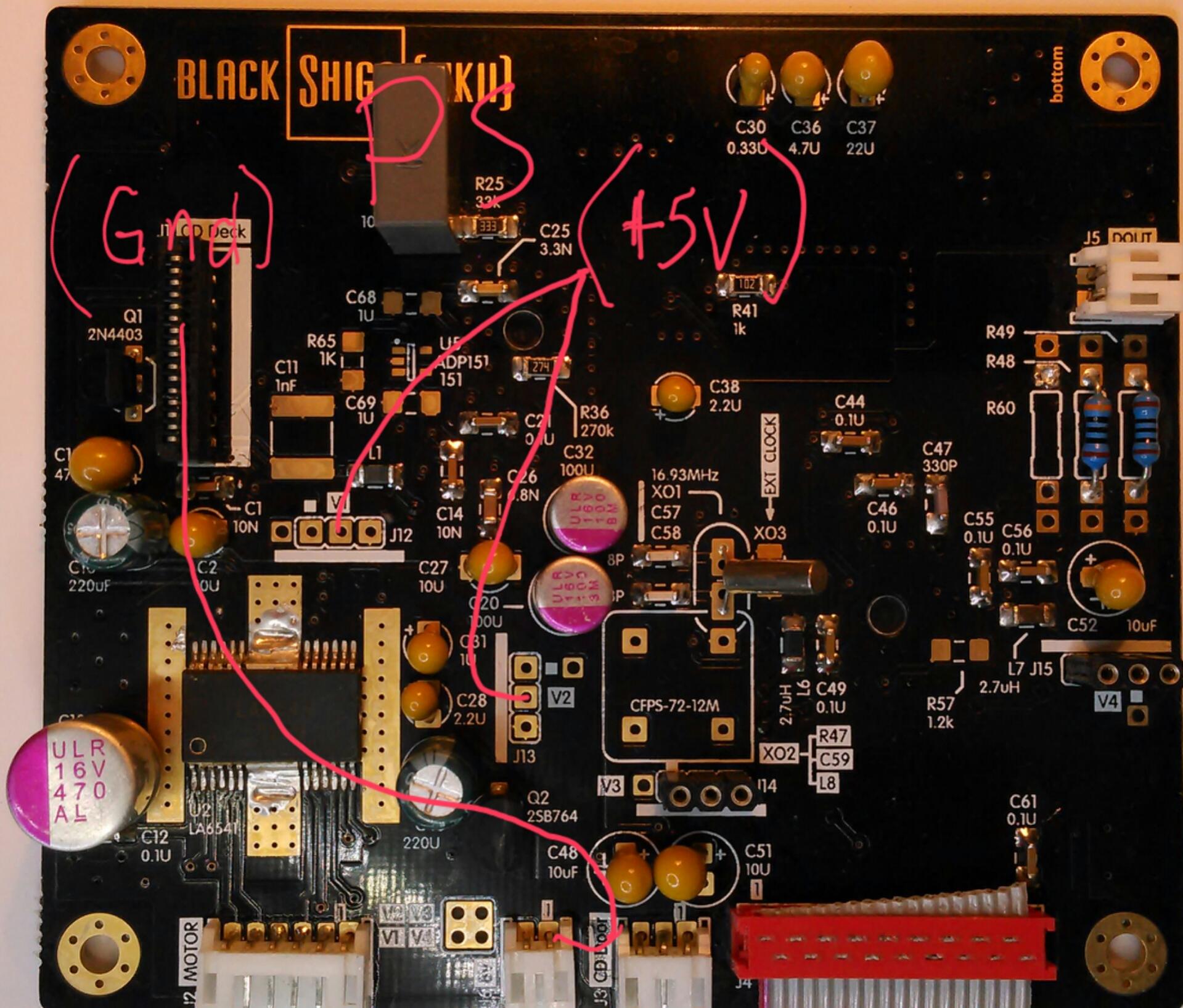

hi tibi,

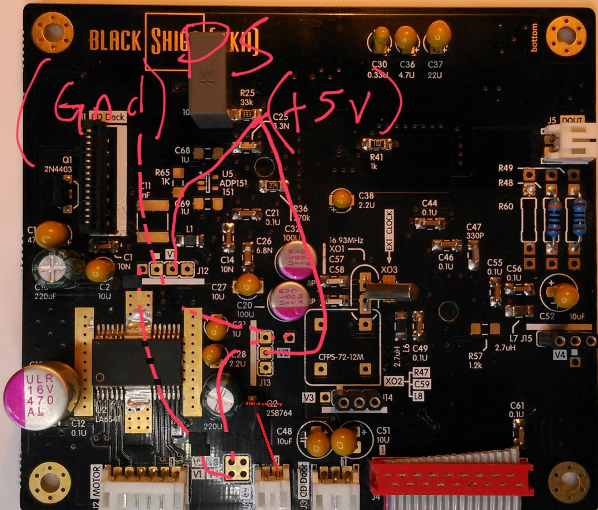

Pin1 of J6 is GND for your superreg !!!!
Middle pin of V1 and V2 print on Shiga is where you connect +5V output from your superreg . Remove L2 and L3 .
Attention !!!! This voltage ( delivered by superreg ) must power on and power off at the same time with V3 and V4 .
Failing to do so and Shiga will not work .
See attached corrected picture .
Use that pin for GND of superreg (pin1 of connector J6)
do not connect other wire !
If you do not understand please take pictures and ask here if connection are correct prior to power on Shiga.
