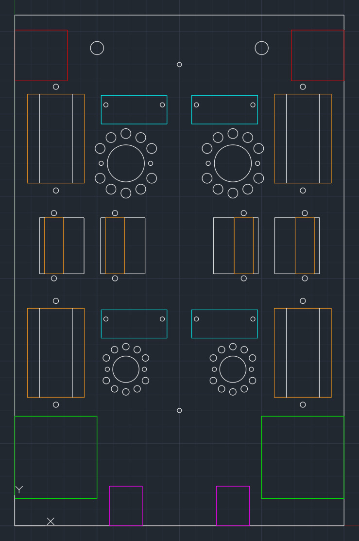

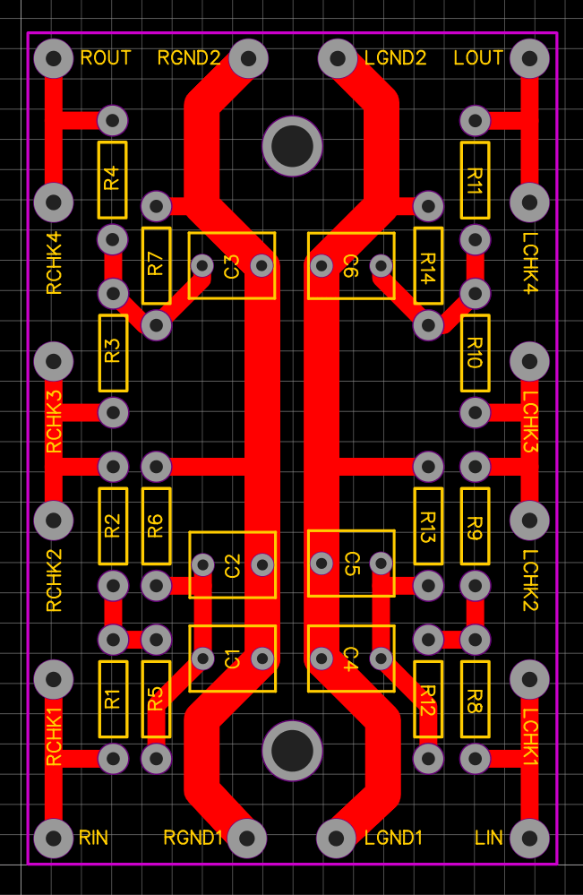

Here's my first draft of the signal chassis layout, top down view, dimensions 15.5" x 10" x 3.25". I measure all the major parts with an electronic caliper and build them all out in AutoCAD for my layouts to make sure everything will fit. Planning to put the heater regulators in the power supply chassis (there will be four of them). I'll run the outputs of those through the umbilical and have some high and low frequency decoupling at each tube's individual heater. For the B+ regulators (Maida style) will run the choke-filtered raw DC through the umbilical and then have the Maida regulators right at the input of the umbilical (red blocks). I need to design a small PCB for the remainder of the RIAA filter components that will mount in the center of the LCR chokes. Signal flow will be front-to-back: 3-pin XLR inputs (magenta blocks) > MC SUTs (green blocks) > D3a stage > LCR RIAA > E55L > RCA outs.

Yes but how do you deal with input capacitance of that tube? Running the needed high bias will create more noise in the first critical gain stage. I am thinking about using this srpp + 12au7 + 20k600 combination as the input. It makes a lot of sense to me if you can swing the additional 20k/600+the H-eql (I'd say Hashimoto iron). Not sure what the (para) means...the two triodes in a tube in parallel?
The traditional Shishido with 6dj8 uses big caps which I am not a fan of. Anyways, that's all for future planning. First I want to complete the Salas valve itch.
