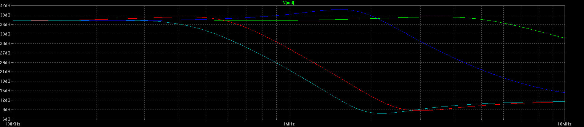

Hi euro21 - thanks! The purpose of the 68pF capacitor is to limit HF bandwidth, less chance of an oscillation in the CCS, recommended to me in the past and have had success using it so far.

Sample: simulated CCS loaded D3a, CCS paralleled capacitor:calculate its size and bandwidth limiting?
Green: 0pF, blue: 68pF, red: 680pF, light blue 1n2.
