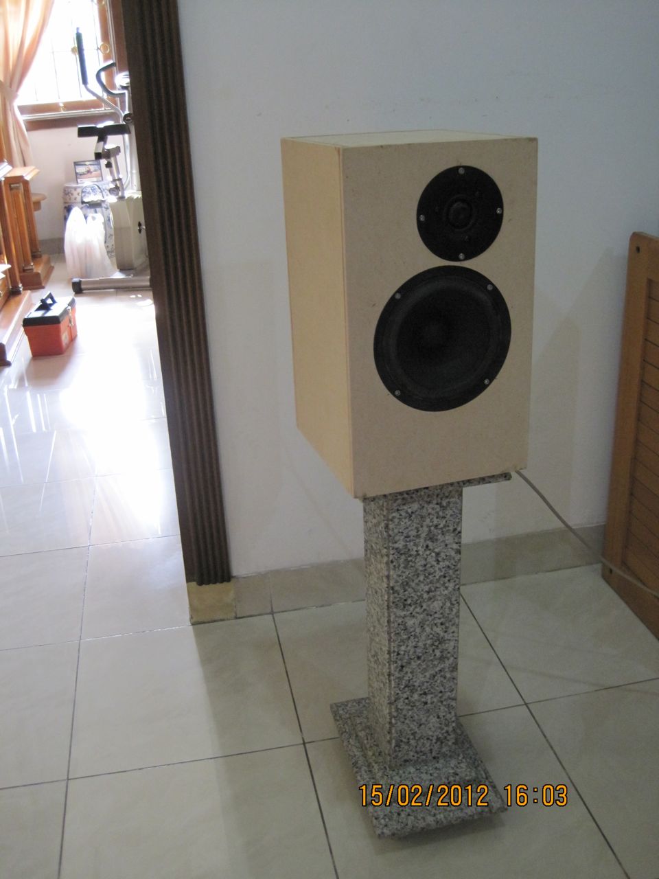

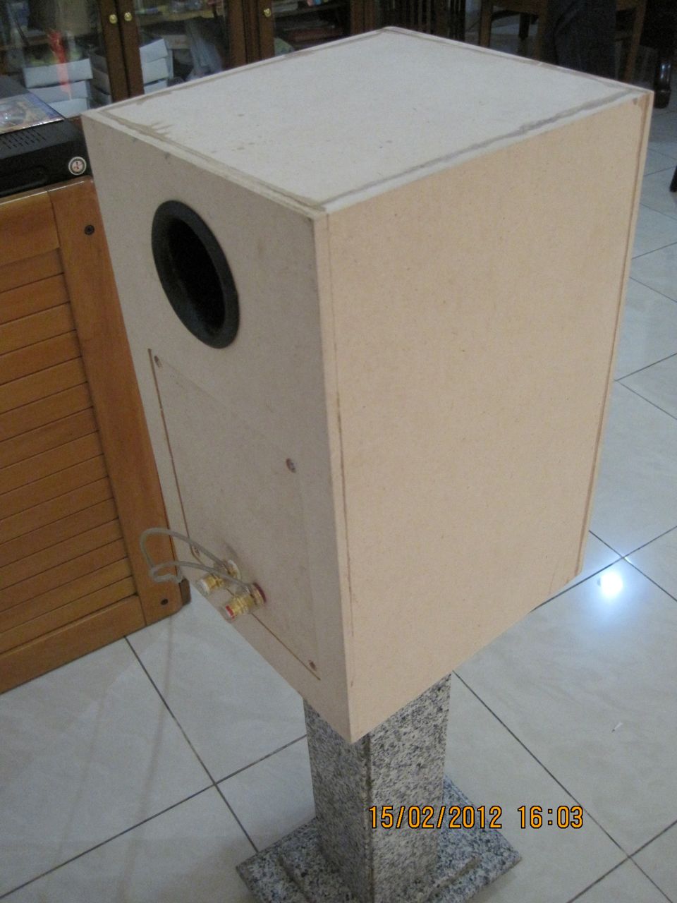

sb17 & sb29 w/ series xo
well i just finished the sb acoustic 2 way w/ series xo. playing for 20mins now, i must say these are very very good drivers. i hear no harshness from the suspected large cone breakup.
i m using L1 0.15mh 14awg, series R 3.3 and 4.7 MOX 10w, and L2 1.0mh 14awg.
its tad on a bright side, tried placed it nearer to the wall, bass improve abit, doesnt effect midrange much. i either need to attenuate the tweeter or put bigger R1.
cheers
henry

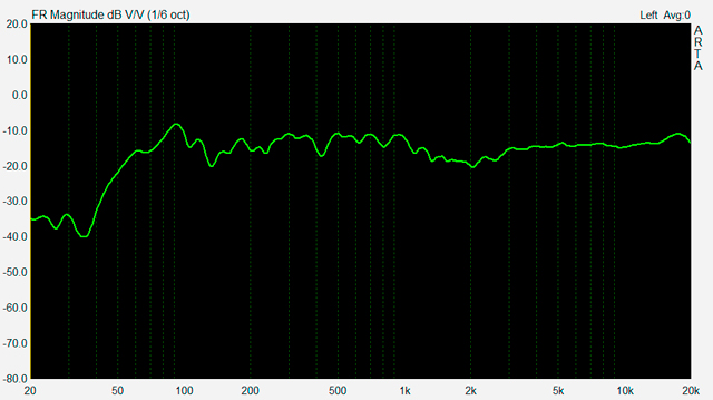

I'm trying right now this AR XO, after looking the web for some info and doing some simulations on Lspcad, I have it playing in my XT25BG60 + SS8545 monitors. Sounds great so far, two coils (0.1 & 1.3) and one resistor (8.2ohm). I was thinking about trying the SS 9500 tweeter instead but I'm not sure it will be worth.
Here's the measurements in my less than anechoic small room:
Your measurements look much like mine. However, the purists who see them may poo poo that minor dip at 2 kHz.
That dip is caused by a phase problem at those frequencies but I guess with 2 coils and one resistor there's not much we can play with to avoid it, anyway it goes away once I measure them on their usual listening position.
Others may observe that it is similar to the so-called "BBC Dip"...
