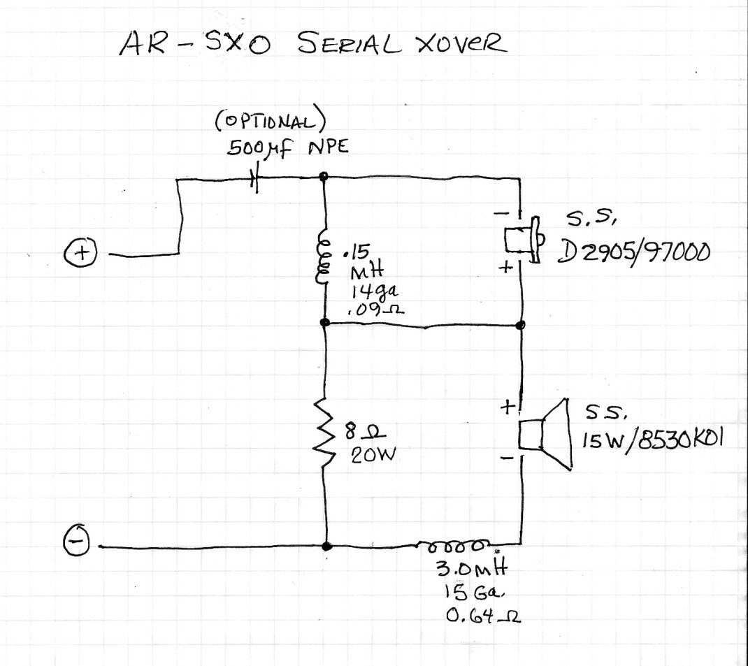

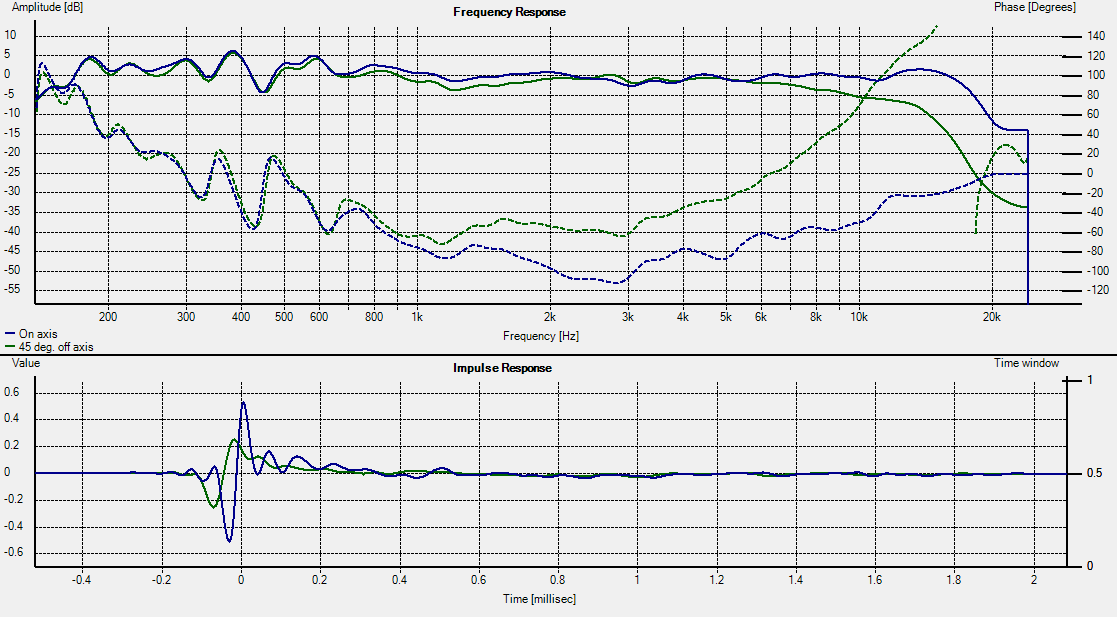

I think you probably have the SS Revelator 15W/8530 K01. With that woofer in a 15L box vented (2" dia X 9" L) coupled with a SS D9500 tweeter you can get very good performance with the below schematic and response result shown using the AR SXO topology. Acoustic Reality's site doesn't seem to be up lately. Are they out of business?

Hi Speakerdoctor, yes it is the Revelator 15W/8530 K01 woofer. I have been playing around with the box and one thing I noticed is the driver does not have a chamfer at the back side and the woofer looks like it may have a hard time breathing. I have been trying aperiodic damping by removing the terminal plate and adding some resistive material and the results were encouraging. I am going this route because I am not crazy about vented speaker sound. I have always liked the sound of a closed box speaker better and this may be a solution.
So, to move along, this cabinet was designed with a front port that is approx. 1-1/2 inch diameter and about 4 inches long, which I have sealed. I have also removed some of the fill especially right behind the woofer to give it some air. The results are the bottom end has more dynamics and the speaker plays louder without bottoming. On the down side the bass takes on a hooty character on some notes. I am going to keep experimenting with the box. I am going to pick up some crossover parts from Parts Express to try your and Rabbitz Series Crossovers.
Also on a side note, I have the 3/4 ScanSpeak Classic D2010/8513 20 mm Dome Tweeter . I wouldn't mind trying the above tweeter but at $180 a pop I think I will use what I have.
