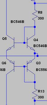

GeneSiC SJT Class A Audio Amplifier using GA10JT12-247
This is continued from thread " Semisouth goes Dodo ; what now ?"
Attached is the circuit diagram - change the output transistors to GA10JT12-247, instead of our obsoleted GA03JT12-247.
Also attached is the PCB picture.
in the zip file are all the CAD/gerber files.

I was mistaken - the design in post#187 above is NOT a Class A design. It is a "dynamic biasing design" (I have no idea what that means). It is supposed to give a Class A performance (linearity) without the power dissipation of a Class A.
Anyway, it is a preliminary design only - should not stop you from coming up with your own pure/optimized Class A design.
I will try to edit my previous post #187 now.

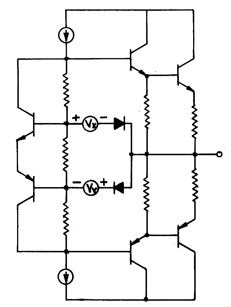

While related, it leans more toward the circuit that Cordell used in his amplifier.
Attached are the front page image of my 1976 patent, and the central portion
of the one you posted. There are similarities between both, but the central
intent of mine was continuous forward bias of the output stage, and Cordell's
was output stage error correction.
