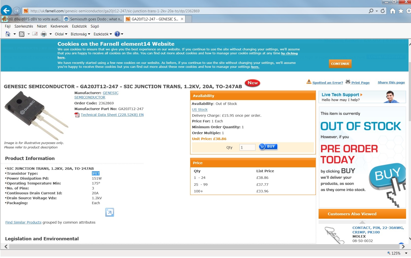

Is there a proof, that the company ever claimed, that these devices are MOSFET or J-FET ?
I'm pretty sure Nelson Pass is just preparing his next design with it ..
Maybe it's only a mistake by me and farnell:
