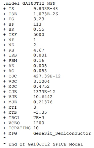

This part is a BJT.

Sure. If you do not understand/care about semiconductor physicsThis part is a BJT.

This device is quite unique - it cannot be classified in the traditional NPN structure, or like a FET. It switches like a FET (purely capacitive); but has current gain (which if you think about it a JFET also has a finite current gain). In terms of temperature dependence of on-state and switching characteristics, it is a FET-like behavior. The physics of operation is NOT bipolar, and that is why we do not refer to this device as a "bipolar" transistor. It is not just a marketing game - there are good reasons for this nomenclature that many "experts" did not understand.
