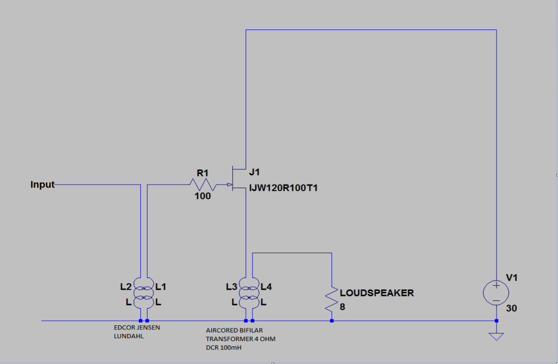

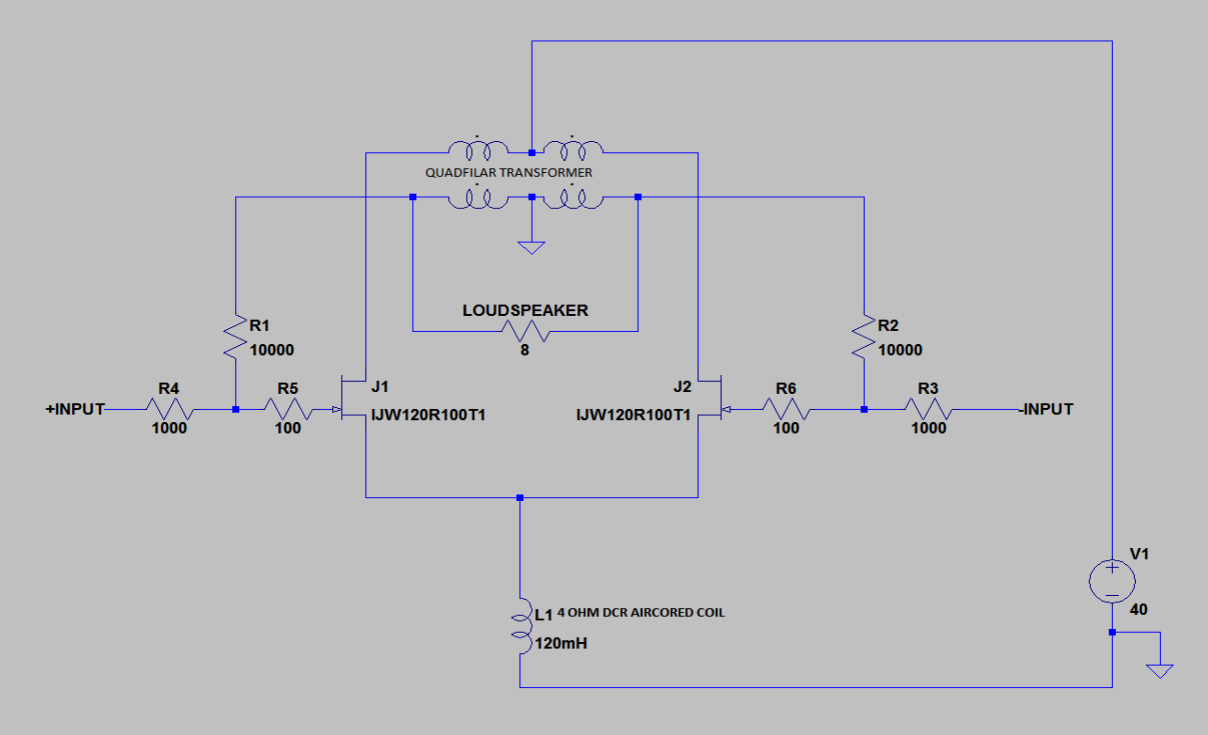

The Infineon IJW120R100T1 offers some rather unique possibilities with their large negative gate voltages Vgs for 2 amperes of quiescent current.
It enables a simple way to get DC-coupled inputs on a SoZ v.7, since it will accommodate the constant current source or large air-cored coil "below" the Vgs of the Jfets. With an output transformer with trifilar or quadfilar windings (SoZ v.7T) it would enable DC-coupled inputs and a very easy DC-free SUSY feedback arrangement.
There are many more unique opportunities with this extremely large negative gate to source voltage.
Johannes
Johannes

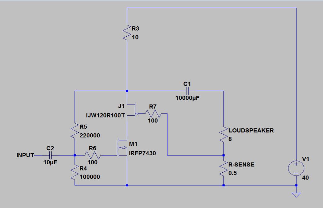

What I like about large negative Vgs is that it makes for good simple cascodes,
as the voltage across the cascoded device is high enough that its capacitance
is brought down to lower values and its transconductance will be higher.
Also, it provides room for plenty of degeneration, improving the impedance of
simple current sources.
Here are two possible uses of the large negative Vgs of the Infineon IJW100R100T or similar SiC Jfet.
The modulated cascode would be quite useless with a normal "pentod-ish" mosfet since it does not care much for any voltage-variation on the drain. Within the ohmic linear region of SITs Triodes or large-ohmic-region devices like the IRFP7430 you can use modulated cascode and similar cascode-feedback techniques to explore your load-line just like Nelson Pass does in the Zen V.9 (Lovoltech power-Jfet).
The aircored output transformer is quite obvious. The output transformer can be an simple single winding large inductance, a bifilar 1:1 transformer or autoformer or an tri/quadfilar step-up aircored transformer or autoformer. In some examples you will need an output DC voltage blocking capacitor.
Just some ideas for those of you who wants to play with these exciting power-Jfets but feel a little put of by their large negative Vgs.
Johannes
This was my idea I wrote about yesterday in this thread (SoZ V.7-T)
I just wanted to post a simple schematic to better explain my idea.
Sadly I don't own any of these devices (yet) so this is just some theoretical unique possibilities these devices presents with their large negative Vgs.
Johannes

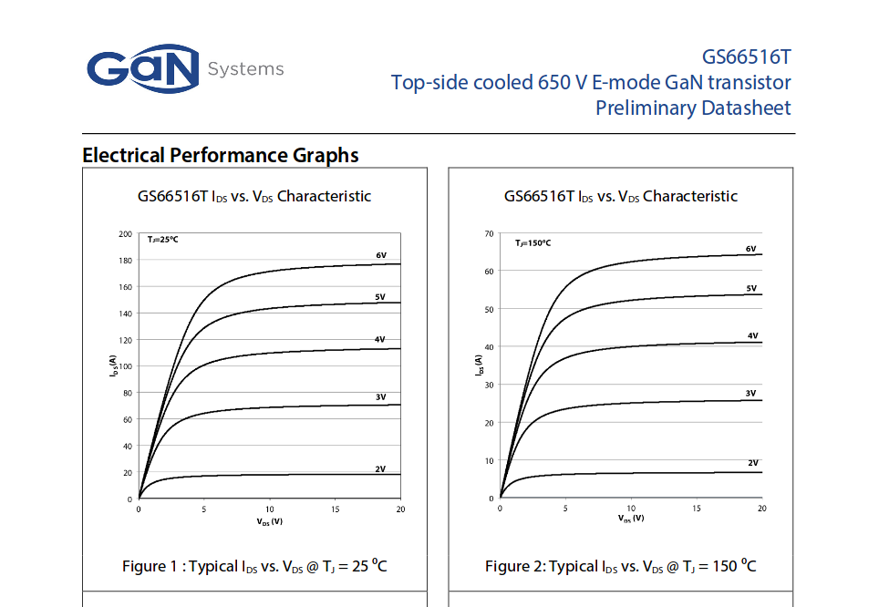

I have been eyeballing these for some time now:
http://www.mouser.se/pdfdocs/PreliminaryTO220GANDatasheetPGA26C09DV.pdf
Gallium Nitride semiconductors seem to have huge amounts of transconductance for very low amounts of gate capacitance. Every transfer-curve I have seen is shows a very high tranconductance and linear device.
http://www.mouser.com/ds/2/692/GS66516T%20DS%20Rev%20160318-913407.pdf
I am very tempted to buy a few of these and clamp them to a solid block of copper, to see what can be done with these small surface-mount parts.
They have quite spectacular electrical properties.
Johannes
A GaN GS66516T (link in previous post) has a low Ciss of only 520 pF, a thermal resistance from junction to case of 0.3 C/W and seems to have transconductance around 50 S. A 9 x 7,64 mm surface area is not very small compared to a TO-220 package. With such a low thermal resistance I guess we can run it with a continuous 20 watt heat dissipation if clamped to a solid copper bar or block.
Perfect for Schade Feedback (low Ciss enables usable feedback resistor values) and cascoding for more power.

The High transconductance/low capacitance is both a blessing and a curse. GaN HEMTs make wonderful microwave devices - they already have a significant niche in that market. Getting them to shut up in an audio context might prove difficult, like those tubes that are rumored to "oscillate in the box". I would love to mess with some of the GaN mosfets from EPD, but they are in these horrible flip-chip packages that make them almost impossible for amateur use. They are probably finding a home in high density, high frequency DC-DC converters
The GaN GS66516T is not a HEMT. It is "normal" enhanced mode Mosfet. Iwould probably start with a 0.25w metalfilm 1000 ohm gate-stopper to play safe.
