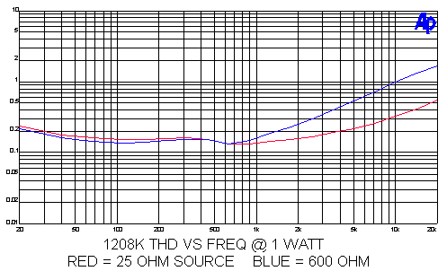

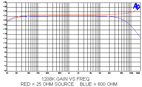

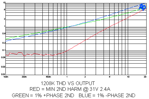

I did test these, and I liked the UJN1208's particularly, and so far they appear
to be the best depletion mode power JFET I have, by a small margin.
Here are some curves operated Common Source into 8 ohms, with Vds at 32V,
and 2.3A bias.
The distortion vs amplitude shows three bias settings, with +2nd harmonic,
-2nd harmonic, and suppressed 2nd (the lowest).
The distortion vs frequency is seen with low impedance vs high impedance
sources as are gain/frequency response.
:cool:
