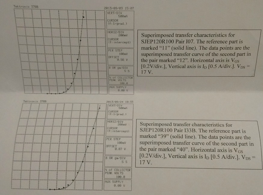

I hope to use these one day.
The big challenge I can see for the solid state 6L6GC replacement is packaging for a decent power dissipation in the challenging thermal environment of your average amp and still being plug-in compatible, which means also being able to fit in the socket spacing of yr usual amp. I don't know what the optimum bias is, but it would probably have to dissipate at least 20-25W in close confines without going ballistic. If optimum bias is lower, then the rules change, but the amp would then probably require servicing to adjust to the new operating point.

I'm thinking of running a separate transformer purely for setting Vgs at around the -3.5V region, I don't want to use resistors on the source this time around.
Also if I can't get the R085 device, I'll just get the Infineon parts and cascode with an N-channel lateral mosfet
