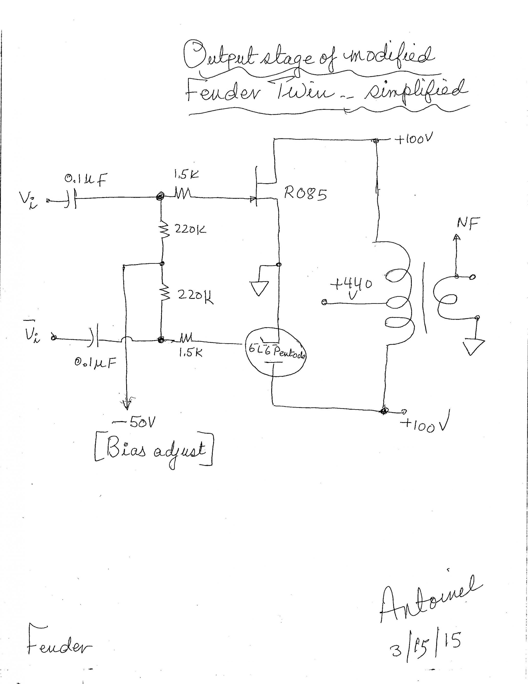

Please find attached [per the teaching of Dr. Mazzola] a simplified output stage of a Fender Twin guitar amp using one 6L6 and a solid state substitute by iMPOWER Systems for the second 6L6. Curious questions for R085 are like those for 6L6:
1. What are its idle and peak currents?
2. Is Vds at its cutoff =~+450V
Best regards.
