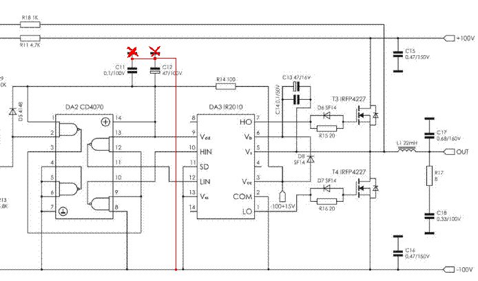

I do not understand, why there can appear 3V at amp output appear, but it makes no sense anymore, since you solved the problems with POP and startup
Probably problem of deenergizing arises because of different speed of recession of feeding pressure for the amplifier and the separate stabilizer on 12V for the driver and logic, it would be interesting to see your variant of the scheme of deenergizing of the driver, it is possible on contact@svpremvs.ccI think it is needed to generate the shutdown signal for IR2110 driver. For example, if the -V source is less than 15-20 Volts, then generate shutdown. If you need an example circuit for it, I try to paint

The scheme for a unipolar PSU I will draw a bit later, I can send to you on usual email.I suggest, that you try to paint the schematic for unipolar amp yourself first, and I will try to find errors then
It is not needed to deenergize the driver, it is needed to shutdown it, using SD pin of IR2110.

Hi AP2, The scheme will be a bit later if I have cleaned short that T2, the making impulse of start and has connected Vb the driver to +Vc through the resistor 200K.Hi Vogor,

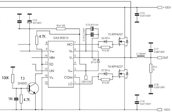

For "smooth" deenergizing of the amplifier it is strong necessary to switch off at first the driver and then other power supply, it is possible to see an example of simple realisation of the given decision?It is not needed to deenergize the driver, it is needed to shutdown it, using SD pin of IR2110.

It is here After switching the amp ON, two resistors (100K and 4.7K) will produce about 0.8V at T3 base. T3 will open and remove the SD signal from driver. Amp will start. When switching the amp OFF, the -V voltage will slowly fall down, and at about 15-20V transistor T3 will close again and produce the SD signal. So the driver will be disabled, when the power supply will be 'deenergized' to about 15-20V... Maybe it will be needed to vary the 100K resistor between 150-200K to get the desired effect
Thanks for a good and simple example, I will try. But it would be desirable to understand all the same because of what there is an impulse, after all a driver PSU falls down almost as smoothly as well as the main voltage?It is here After switching the amp ON, two resistors (100K and 4.7K) will produce about 0.8V at T3 base. T3 will open and remove the SD signal from driver. Amp will start. When switching the amp OFF, the -V voltage will slowly fall down, and at about 15-20V transistor T3 will close again and produce the SD signal. So the driver will be disabled, when the power supply will be 'deenergized' to about 15-20V... Maybe it will be needed to vary the 100K resistor between 150-200K to get the desired effect
The impulse is generated, because opamp is switched off before driver and mosfets are 'deenergized'... for example at +/-10 volts the opamp wil get too low voltage through 1.8K resistors and will not work anymore, although there is still a lot of energy at output mosfets. Oscillation stops and since the output can be only in two states (-V or +V), the strong impulse is generated.

Ok, I in an amplifier PSU have two "banks" - 47000mFx80V, ballast resistors now for opamp - 2x2,7K/2W and for a PSU of the driver and logic the separate stabilizer 7812+200mFx16V, will try reduce condenser capacity (200mF) can driver will be closed faster and will not be output impuls.The impulse is generated, because opamp is switched off before driver and mosfets are 'deenergized'... for example at +/-10 volts the opamp wil get too low voltage through 1.8K resistors and will not work anymore, although there is still a lot of energy at output mosfets. Oscillation stops and since the output can be only in two states (-V or +V), the strong impulse is generated.

You can try it, but I think this will not help, because the driver will stop work LATER than opamp anyway.
Also, do not forget about the error with caps (see my previous post).
