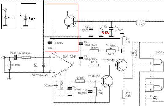

Yes, scheme that I have resulted in the thread beginning, a power supply voltage +/- 65V
I have really burnt three dynamics from for constant voltage which appears and then at repeated inclusion it is not present also the amplifier normally works, I think that a problem in transient at start but I do not know as it to eliminate. Fuse did not use.
Here is how I recommend to change your power circuit for input stage (see image attached). Sure, it needs to be done for both +5V and -5V sides...

Why was you needed to increase the supply voltage for opamp to +/-15V ? Most of them are working fine with +/-5V also... And altering the supply voltage of opamp you need to alter the resistance of R9 too! So I recommend simply change it to +/-5V back...
Connecting Vb of the driver to +65V will kill your driver immediately! You can only tie it to +65V via a small resistor (about 50-80K) and connect the 15V Zener diode parallel to C13.
The 'transistor on + conductor' will give you more stable voltage for the input stage. The same needs to be done on '- conductor' too.

I increase the supply voltage for opamp to +/-15V because have assumed that its speed thus will increase, what value of resistance R9 in this case is necessary?
Vb to +65 I planned to connect through the resistor 100-200к, whether it is possible to expect normal start without an output impulse (If to remove T2)?
The ' transistor on + conductor ' will increase stabilisation factor? It is possible to see a variant for a minus conductor?

It is not necessary to have a high speed opamp at the input in this selfoscillating amp... So simply replace Zener diodes with another 5.1V
I think it will work...
For a minus conductor it will be the same, but the transistor should be of other polarity (NPN/PNP)

The amplifier works and starts now normally! but at deenergizing there was a small impulse (2V) that it and how it is possible to correct it, can switch off at first the driver and then other power supply? At a +/-100V I am going to use on exit IRFP4227 (on Vds and a Id approach) with them as think it will give out 1000W or there is other reason limiting capacity? What on yours difficult in transfer of the scheme into the bridge? I plan to add one more driver and pair mosfets, but whether will be still necessary levelshifter if to make unipolar power supply?
Which changes you have done then?
Do you get this impulse immediately after switching amp off, or after some delay (3-5 seconds)? If you do not connect anything to the amps input, is this impulse (2V) still there after switching amp off?

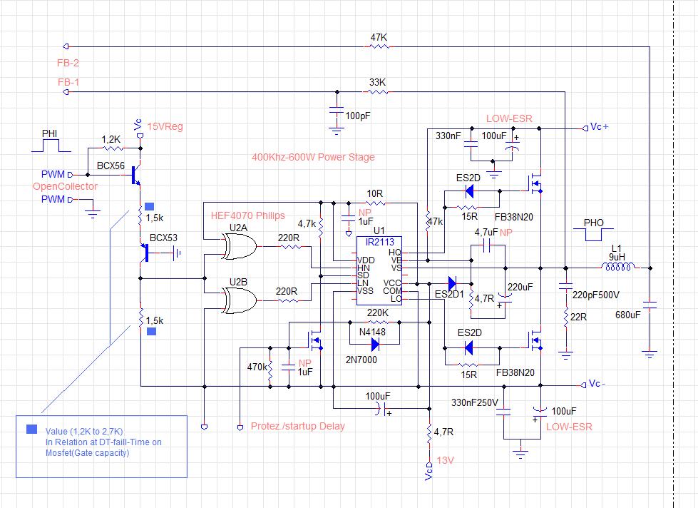

This is the output stage of my old project (2003).
component values are adjusted to obtain a good reproduction even at low audio frequency (40Hz) at power, and less noise as possible.
also the resolution at high frequencies sound is excellent.
nothing special, with this driver (IR2110 I used). I think they are all similar.

But this is NOT for unipolar voltage source? At least I see GND, -v and +V here...
