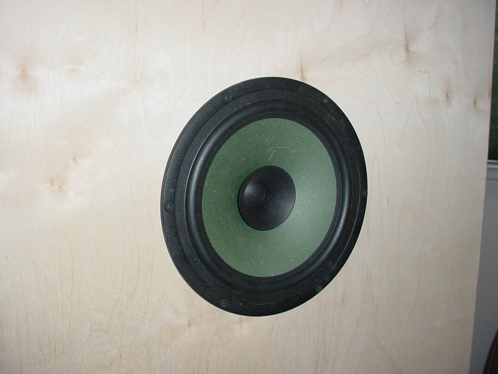

I'd suggest starting off with a 90L floorstander as outlined above
and filling the bottom third or so of each cabinet with sand for
checking out the sealed alignment, vented would then be easy.
rgds, sreten.
A very good suggestion i will try this.
i started out whit a 60L closed because i had this lying around from a previous prosject.
I must say i sounds very good already real nice vokal and nice bass respons
it is a real promising driver in the right enclosure.
it has a sweet sound that makes me wanna listen to my entire record collection
Nice thanx for the link. Interesting to see some measurement for this driver.
I feel there is many roads to rome, an i am not shure where i end up.
But i am shure it's gonna sound great after what i have heard tonight.
Eariler today i got my hands on a 92L net volum bassreflex enclosure
tuned to 32hz. I know it should be 28hz but it has a built in port so it's a bit harder to change it.
I will come back with a report as soon as i have listened to it for a while.
And write some word on the differences between the two enclosures
32Hz is very ballpark and 28Hz was only a personal suggestion.
FWIW you can experimentally detune ports by lining the port walls
with thin porous foam, I do (well did) this a lot for room matching.
rgds, sreten.
Good idea i will try to tune it tomorrow
Today the loudspeaker has made some noise in a 90L bass reflex enclosure.
It has a sweet tone to it a nice clarity and very nice and precise sound stage.
I would personaly like to get more live sound in the bass region. So i guess a horn construction is more my cup of tea. but other than that it's a great loudspeaker.
what difference on bass br vs closed ?
in a closed box the bass respons get a little weak for my taste. so too compensate for that you would have to dampen the speaker as shown in the seas app notes.
but when i did that i lost some of the live feeling.
in the bass reflex box the bass got better and fuller but i feel it is more to this driver so my search goes on
