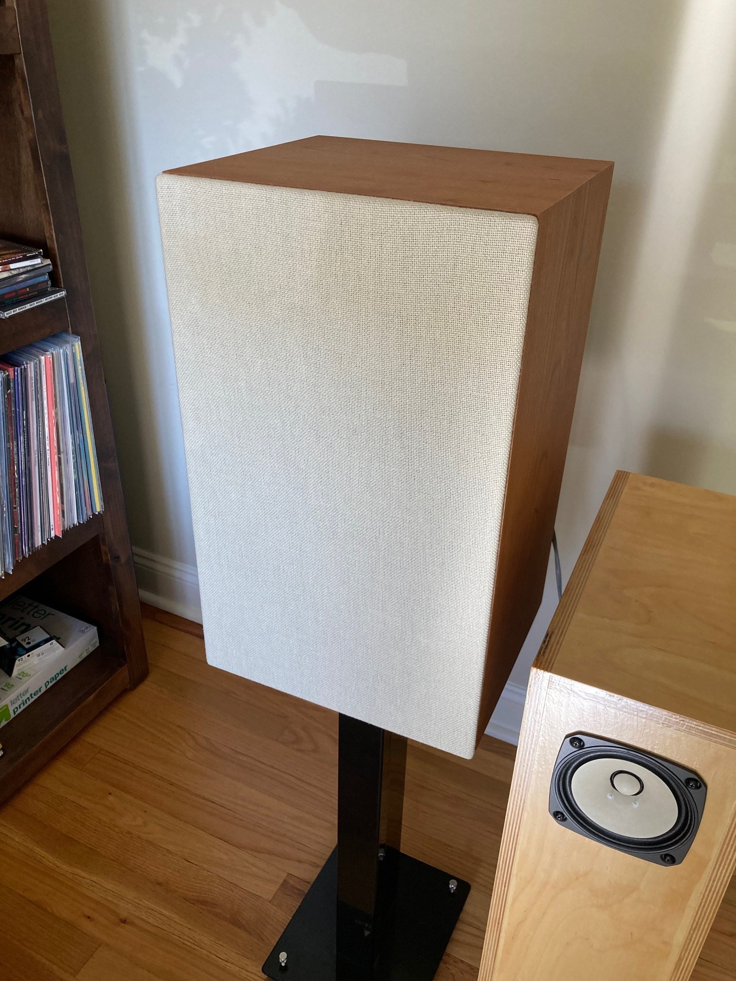

I've purchased the A26 kit from Solen here in Canada. I've deviated from the design as I've decided to clone the A35 as opposed to the A25. I am very happy with the sound and I've experimented a bit. Now the tweeter, well I'll tell you straight out I love it. Not sure if it's the tweeter, the implementation with the SEAS A26RE4 woofer, or the cabinet size, etc...but I find it detailed, smooth, not tiring (as opposed to other speakers I've owned) and very well integrated with the woofer from the A26 kit. I had cabinets build out of birch.Since there were many uses of seas A26 kit I would like to know more about the sound quality of the Tweeter T35 used in it. Can anyone please give a review of that tweeter.
I am listening to music as I type this (Luna).
Playing around with my A35 clones (A36), I come to the conclusion that I'm happy that I stuck with the dynaco cabinet dimensions to a T; even if my tweeter is not in it's optimal position. I implemented them with the 3.3 uf and 10 ohm resistor supplied (I could upgrade the cap in time).

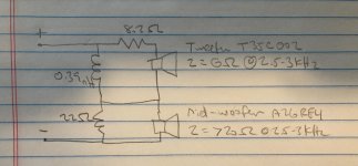

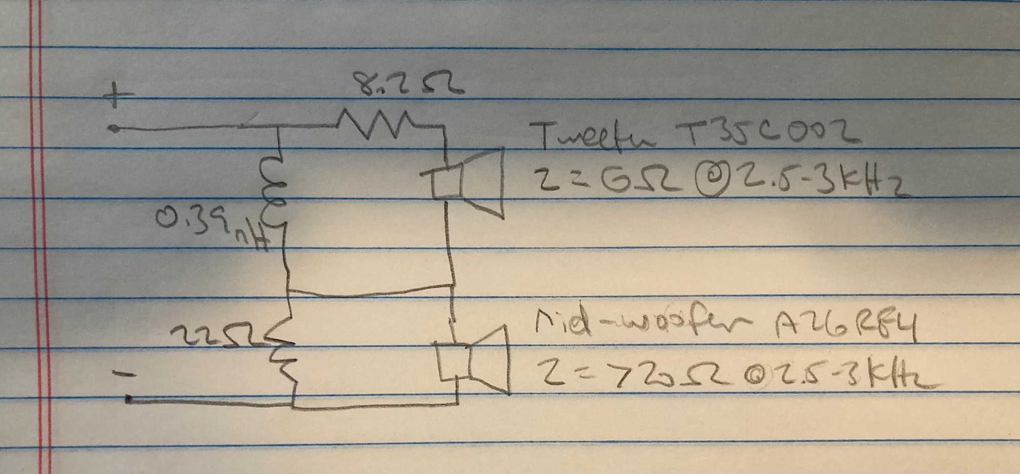

I've been playing around a bit with an F1J clone, which is a transconductance amplifier, and my Seas A26 2-ways. The single pole series crossover design below sounds pretty good to me and hasn't blown any drivers. It's two resistors and a coil instead of the single resistor and capacitor of the standard single-pole parallel crossover.
The tweeter is crossed at ~2.5kHz using a single parallel coil of 0.39mH, and padded down with an 8.2 ohm series resistor. I thought the tweeter level sounded better a bit higher here than with the standard 10 ohm value as used in the parallel crossover. I also tried crossing the tweeter a little higher at 3kHz with a 0.33mH inductor, but preferred the sound with the 2.5kHz crossover point. Per the original parallel crossover design, the mid-woofer is not crossed, but running it full open produced a muddy / floppy bass which, while fun and bold and not that offensive, seems to be improved a bit by some damping, hence the 22 ohm parallel resistor.
Offering this up in case anyone else has been curious if a current source amp could be made to work well with these simple 2-ways. The sound is addictive- the swing and punch of records with a lot of dynamic range like some of the recent jazz reissues really comes through. This system reproduces vinyl better than any iteration I've tried so far.

J-jees! Absolutely!With your permission i will add that XO to the document i have been making.

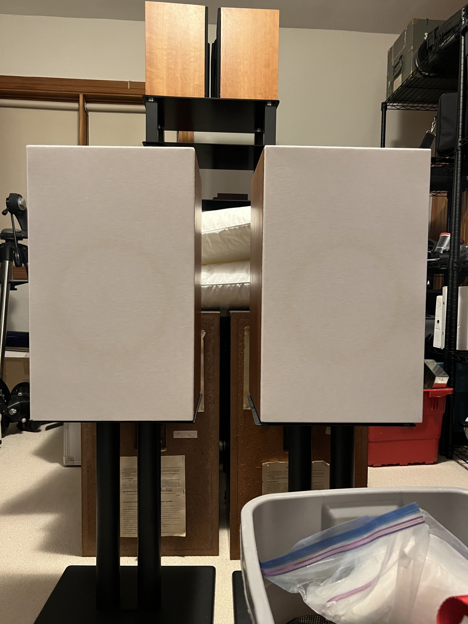

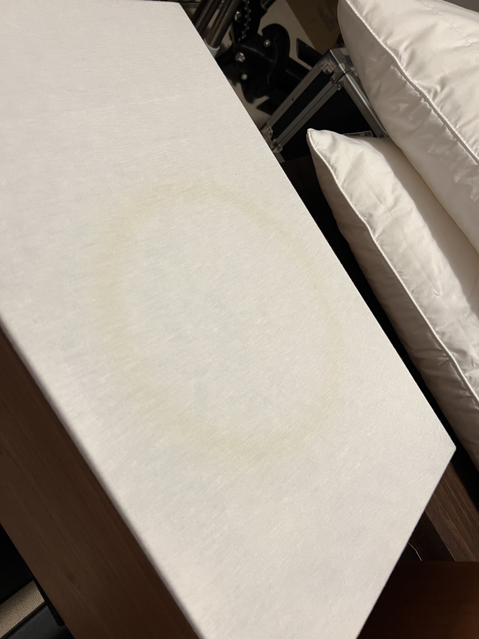

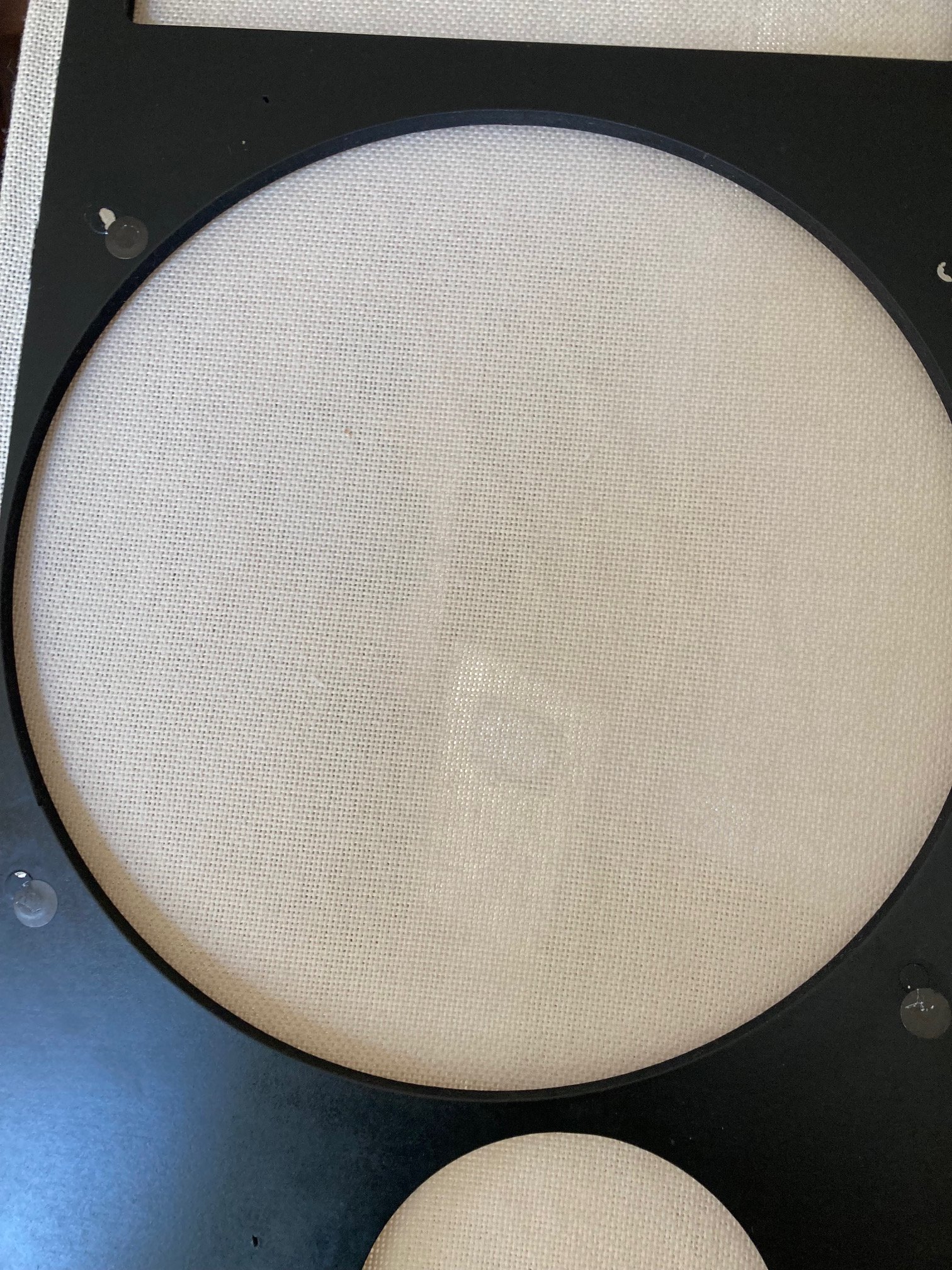

Since this is an A26 kit thread (I wouldn't want to steer the conversation in a different direction), does anybody who built the A26 kit from Madisound with pre-built 1 cu-ft boxes have a case of the white grille material becoming yellow where the woofer surround comes in contact with it?
I don't have a photo right now, but on mine the outline of the woofer surround is visible on both grilles as a yellow circle...

@christiang
looks like maybe a air quality issue, woofer moving air in/out rapidly……do you smoke in the house, use a woodstove, or fry alot?
