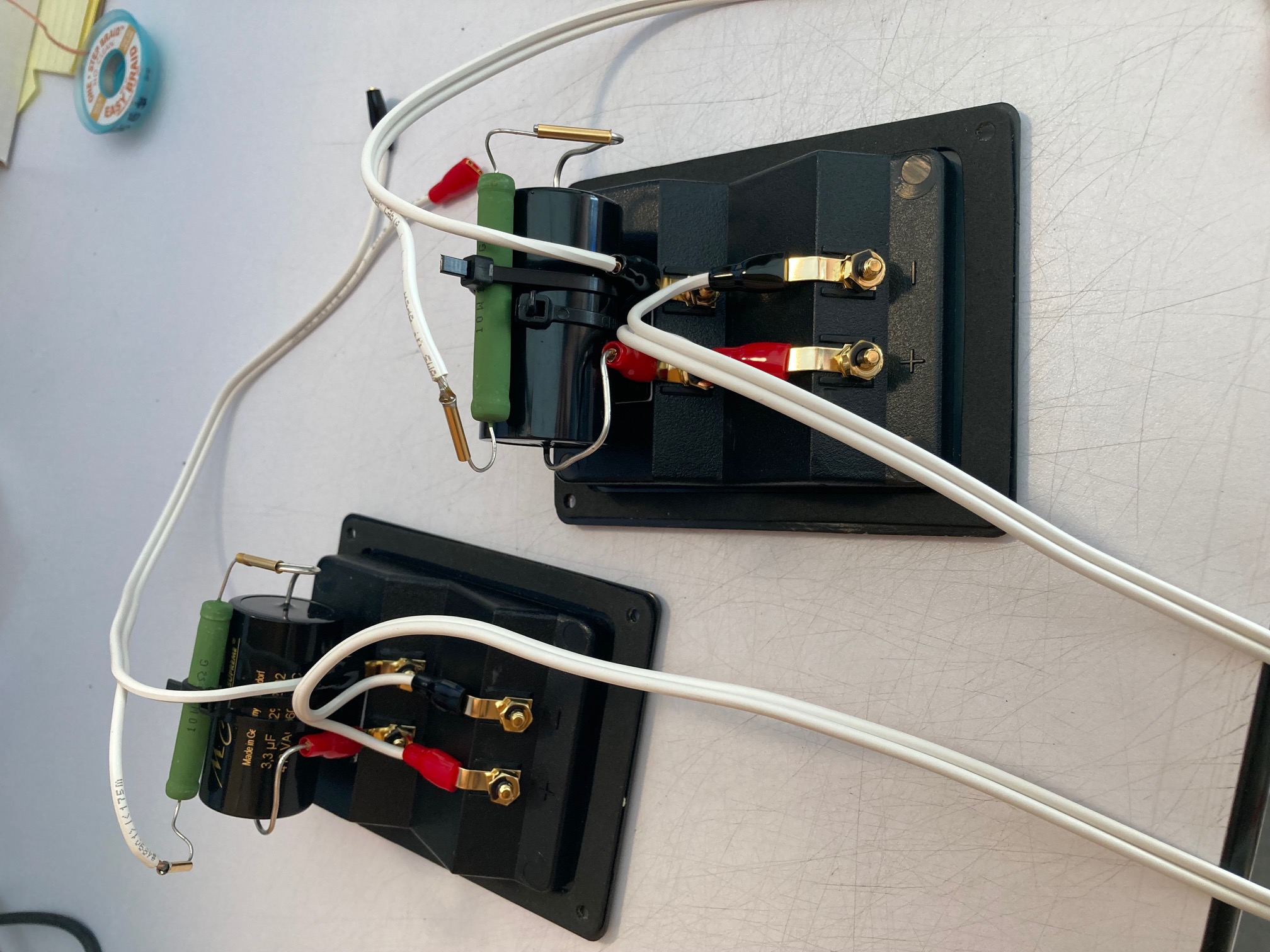

I believe the tweeter in my Decapos are the 29TFF. I find them bright and detailed; they have been great for watching TV and for parties. I find it is too much of a tweeter for quality music listening: adding a sub to the Decapos really allowed the soundstage to open up. My take is that it is a lot of tweeter and not the most refined sound wise (but awesome for the price)....and I'll go into details.
I recently built my A36 clones (based on the A35 design) with the SEAS T35 tweeter. At about the same time, I landed a pair of Dynaudio Special 40s. What I found with the newer tweeters in both speakers is a much more refined sound; detailed; non fatiguing. If you like to sit down and just listen to music, yes they are expensive, but like anything of quality these days, you gotta pay.
Having spent the extra $$ on the T35 for my A36 clones, I have no regrets. The money is spent and I enjoy them.

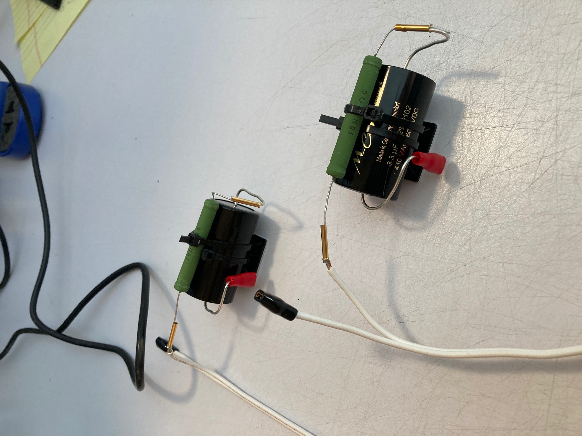

As for getting the right capacity value for the job, my kit from Solen came with a 3.3 uf capacitor and a 10 ohm resistor. I went with that and it just works well according to my ears. My Decapos should have a 5 uf cap (I'm using 5.1 uf), no resistor...but I think it should have one! LoL.
If you read up on WD designs A25 clone, the designer keeps referencing phase accuracy at the crossover point between the woofer and tweeter: I guess this is key.
Have you thought to trying a variety of capacitors and resistors to see what works best? I know it is not the best way to go about it, but in the end it will give you the chance to evaluate the variety of combinations.
Best of luck with your decision(s).

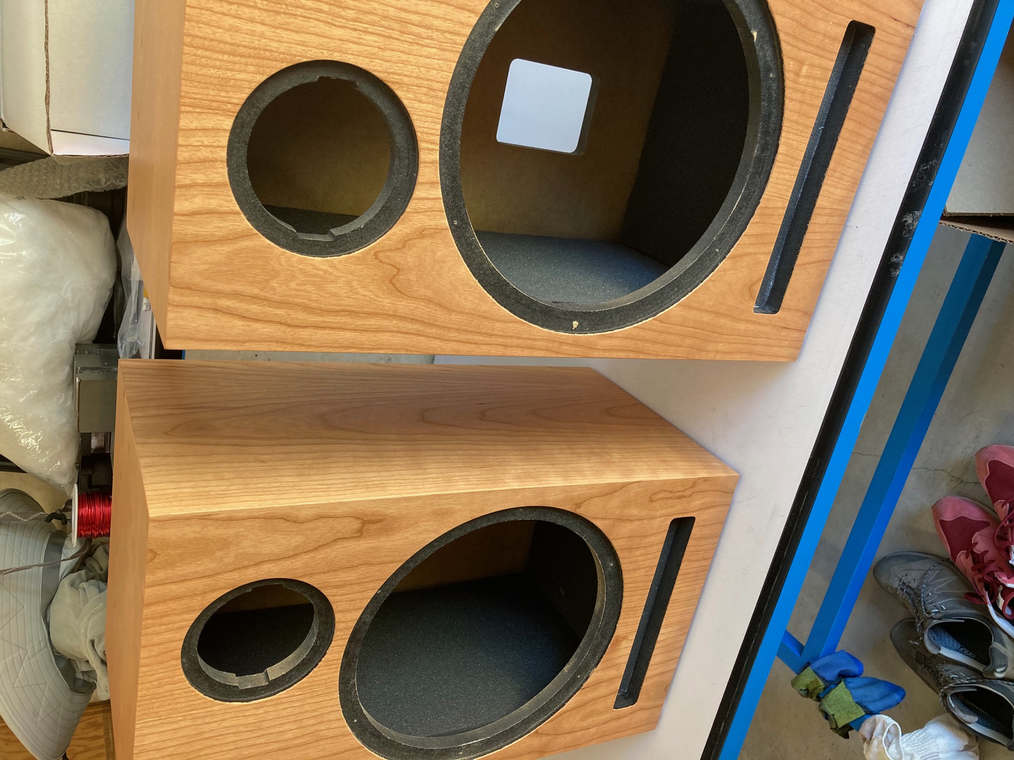

A new pair of Seas A26's enters the world
I built the Madisound Seas A26 kit a few weeks ago as spec'd: T35C-002 tweeter crossed with 3.3uF Mundorf Supremes and 10R resistor in series, no cross on the A26RE4 mid-woofers. The 28L cherry veneer cabinet has no internal bracing- I contacted one cabinet maker to see if they would make ones per planet10's plans but I got no response. The cabinet has the aperiodic vent which I sealed with the same foam that I lined the cabinet with, per Madisound's instruction. Crossover mounted on the backs of the input cups as planet10 suggested, but there is no foam lining on the back of the cabinet- the kit didn't come with enough to line the backs.
Compared to the Klipsch RP-150M bookshelf speakers I was running, the sound of the A26's is far more detailed, with better soundstage and balance. Vocals are a touch less forward but that seems reasonable given the better overall perceived frequency response. Jazz and instrumental music sounds superior. I drive my system with a single Pass ACA and was worried that the lower sensitivity of these speakers compared to the Klipsch would present an issue, but not at all- my volume settings are hardly changed. I also don't regret hardwiring the 10R resistors in the crossover as I don't think the treble response needs any changing. Highly recommend to anyone considering this speaker.
I have built the A26 kit with the T35 Seas tweeter and its pretty amazing sounding for such a simple design. That's probably why its so good. It just sounds correct and musical without a trace of listening fatigue. The cabinet tuning is a bit lean on the low end, but getting them closer to a boundary helps alot. I run them spaced only 1 ft from the rear wall. No issues with excess lower mids.
The Dynaco A25s were stuffed to the gills with thick fiberglass batting, sides, top, bottom and back. Granted chipboard rather MDF, and slightly different dimensions I believe. You could give it try, cheap tweak and see what you hear.
