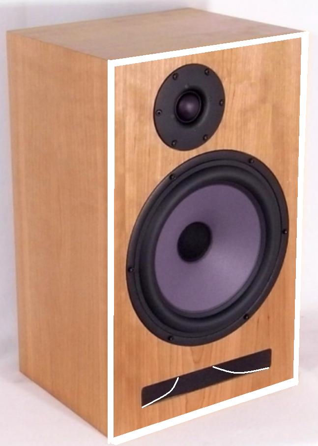

The box needs some upgrades -
Rounded or beveled edges
Maybe flare the ports :smash:
A pricey build, however, if you jump in, go for the better tweeter.

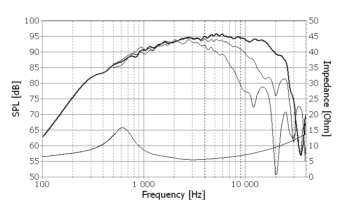

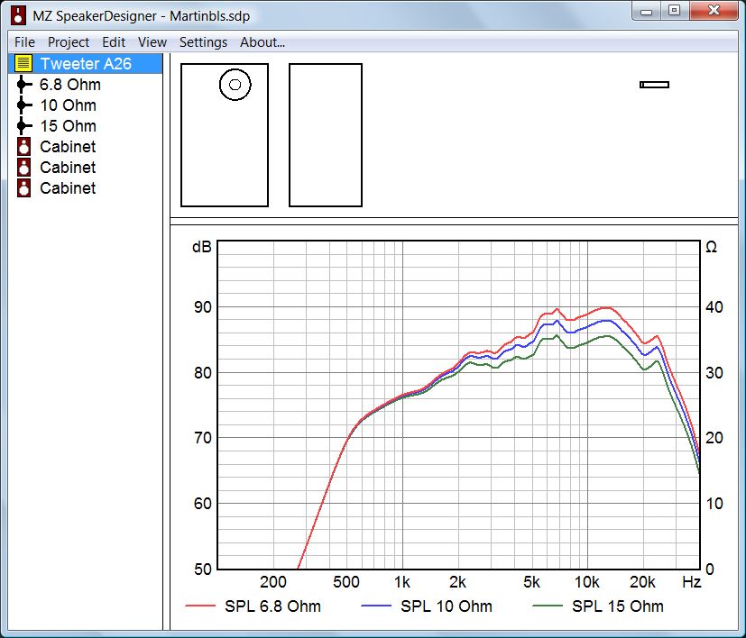

The resistor affects mainly the high frequency response of the tweeter and has little influence at the crossover frequency:
attachment.php

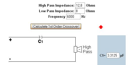

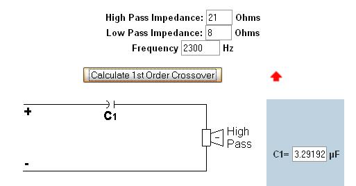

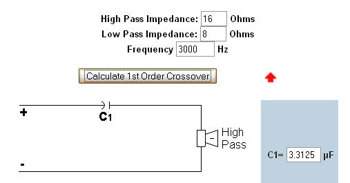

Example: Have a look at the attached pics below.
1. Tweeter + 6,8R, C1 = 3,3uF
2. Tweeter + 10R, C1 = 3,3uF
3. Tweeter + 15R, C1 = 3,3uF
Ignore the low pass impedance.
Now, have a look at the changing crossover frequency.
And compare this with the frequency response of the Seas kit...

The increase in resistance to be seen by the crossover should be usually reflected by a reduction in the cap value to retain the desired crossover frequency. However, adding a bigger resistor would pull the whole tweeter freq. response graph down, thus shifting effectively the crossover frequency so you may want to increase the cap to keep the crossover where it should be. 3.3uF is a small value, perhaps the change in resistors is compensated by retaining the cap value ( instead of reducing it to offset the higher impedance ) so crossover remains where it is supposed to be by the initial design.
Assuming a constant tweeter impedance of 6 ohm is an oversimplification. Actually the impedance is 8.5 ohm at 1000 Hz and 16 ohm at 600 Hz!
Yes, but in the range of the effective crossover frequency (according to Seas: around 3000 Hz) the impedance of this tweeter only varies from 6 to about 8 ohms. Over the whole range from, say, 2000 to 6000 Hz these variations can not be responsible for compensating these different loads the capacitor "sees".
Perhaps I should write to Seas about that. I don't want to make it overly complicated, but really, I don't get this, and I want to know because generally I like the sound of this particular crossover arrangement for a few suitable tweeters (e.g. Seas 27TDFC).
looking at the cabinet drawings from Seas. One thing they say is that "adding internal bracing to stiffen the cabinet is a good idea for the advanced builder and will further enhance performance". Not being an advanced builder I am wondering what internal bracing might look like? Any thoughts on this...
Martin, there is nothing wrong with your understanding of the formula. You are right about the effect of resistor to Fc. What you may not understand is the implication to the situation (LP slopes remain at 3000Hz, HP slope changes but is padded down, slope is very gentle at 6dB/octave, no drastic phase change, etc), which is not as severe as you might think.
