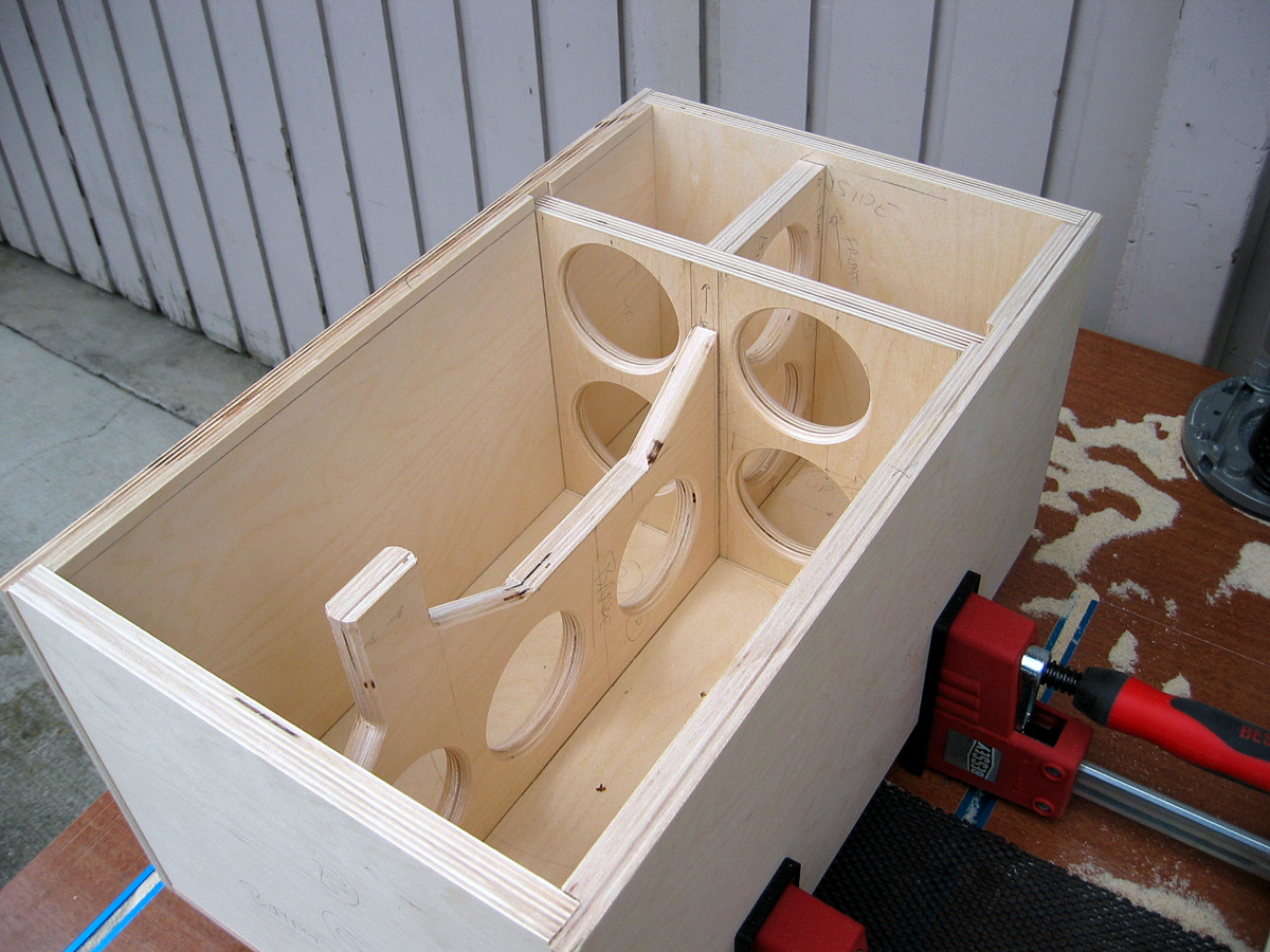

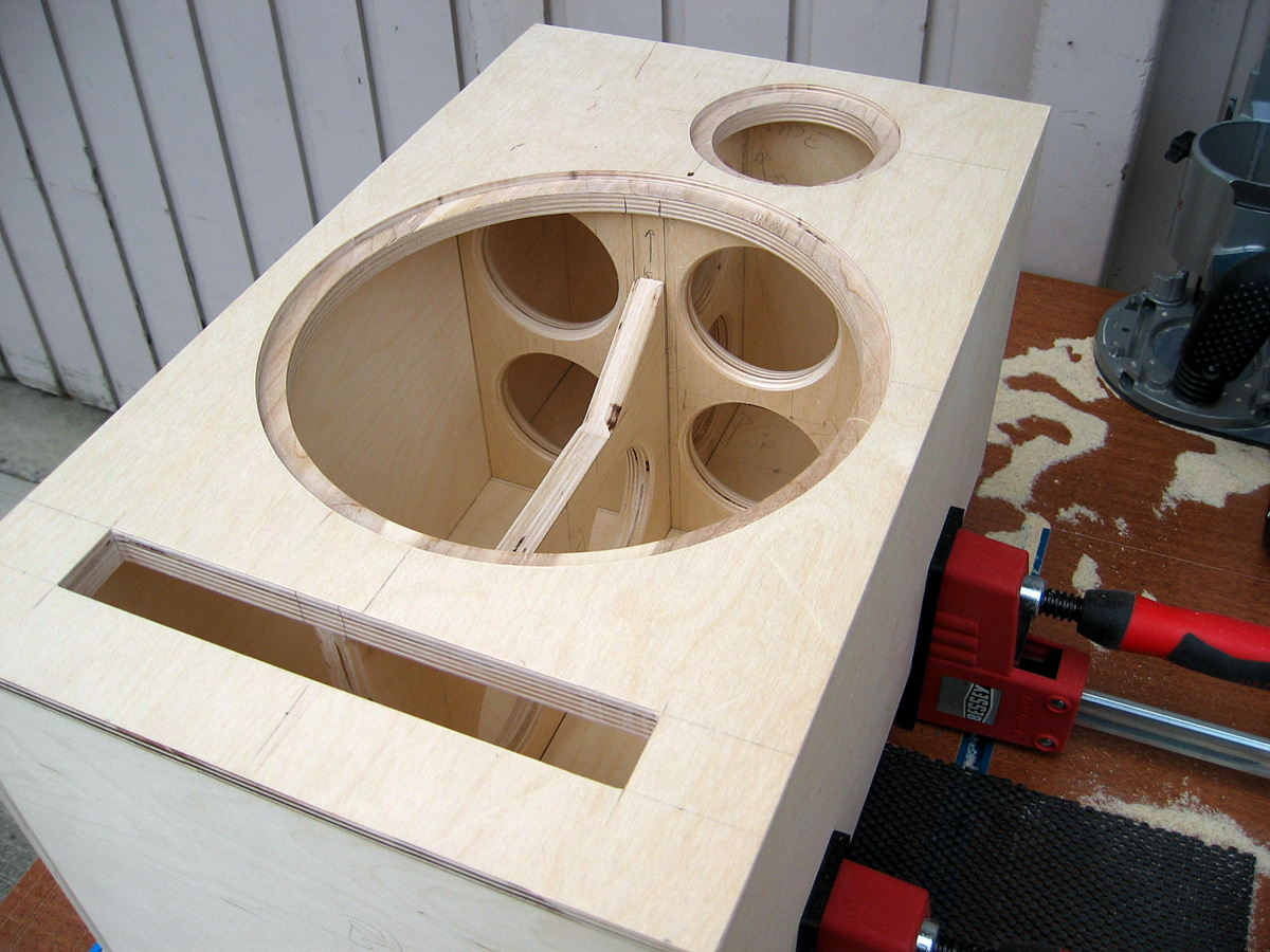

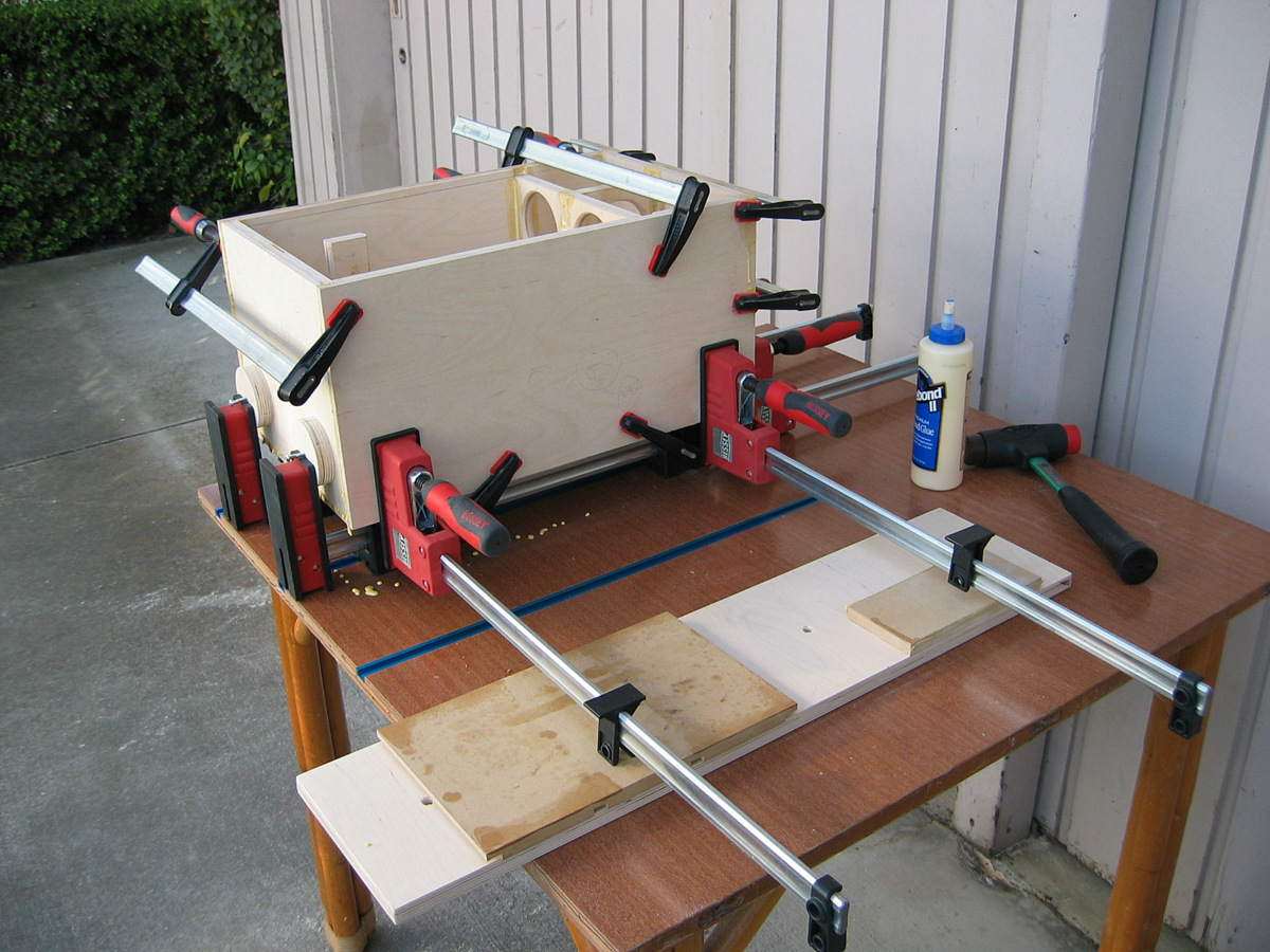

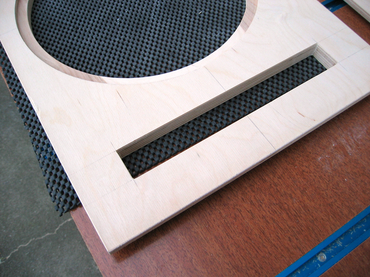

Made the important baffle cuts. The vent was a bit fiddly, but came out great. Hopefully I can make some progress on the bracing tomorrow.
BK

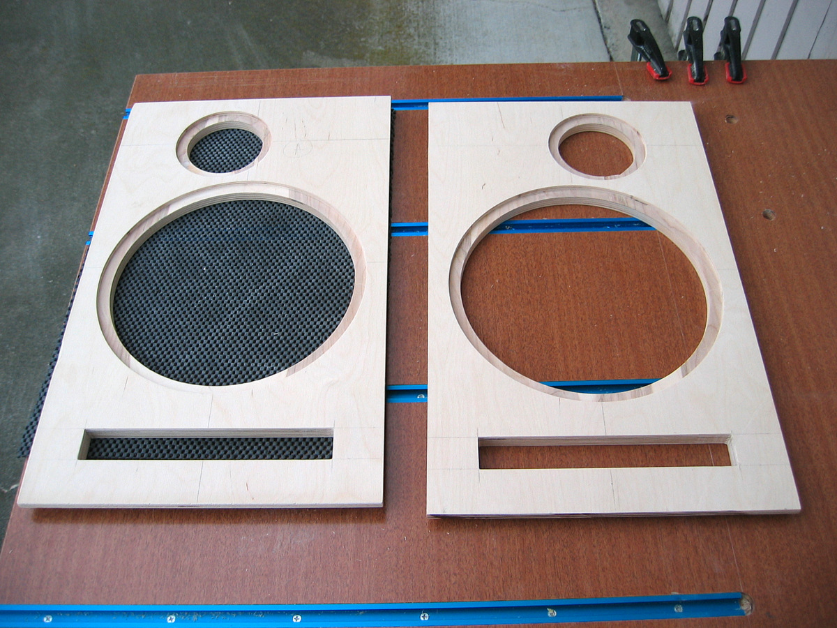

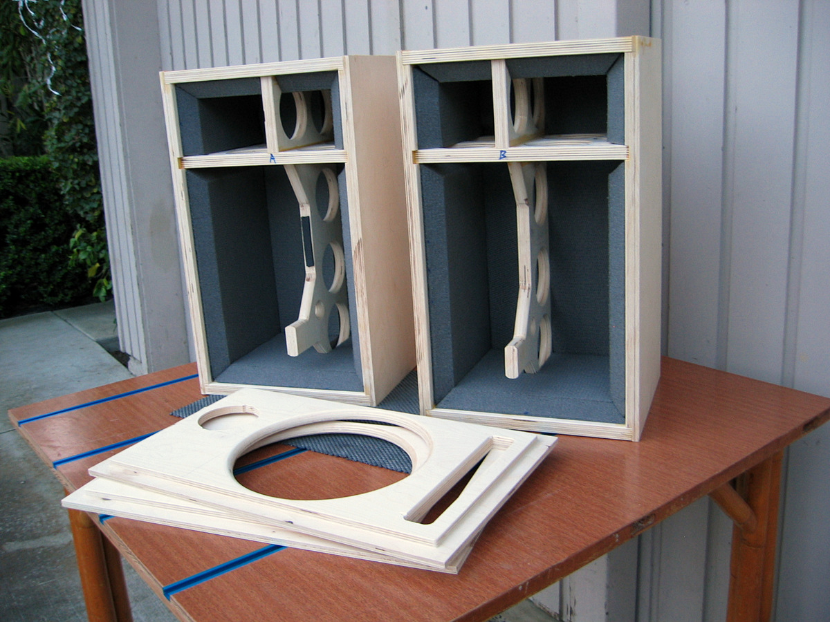

No-Rez foam cut to size and mitered.

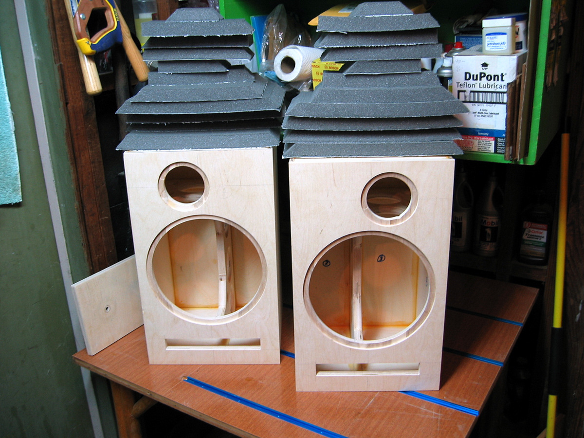

Baffles and braces fine-tuned for fitment. I'll say it again - wow it takes a lot of time to make small corrections, especially with sandpaper and BB ply.
BK
