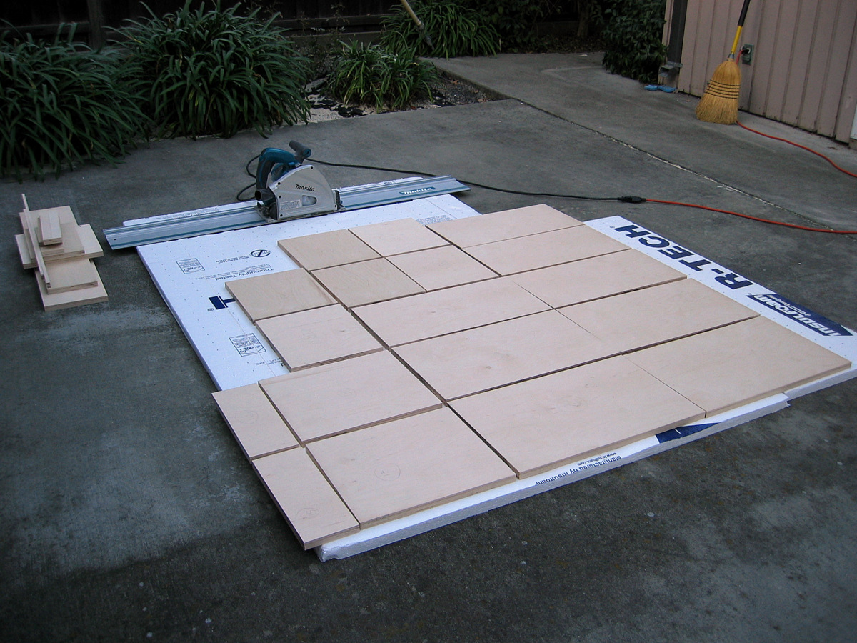

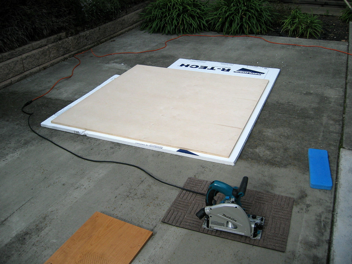

I've built a few other MDF flat-pack kits, but this will be my first kit from a full sheet of real wood. I'm using it as a tune-up for my skills and to get familiar with techniques and tools. I have a new track saw and a router with the necessary bits (no table saw and no elaborate shop).
All the components came from Madisound. I opted for Mundorf SGO caps and will stick with the SEAS circuit values initially. Material is good quality Baltic Birch @ ~18mm thickness and 13-ply. Interior will be lined with GR Research No-Rez.
I'll follow the SEAS cabinet plans for exterior dimensions and openings. Edges will be joined with rebates and then flush trimmed with a router after glue-up.

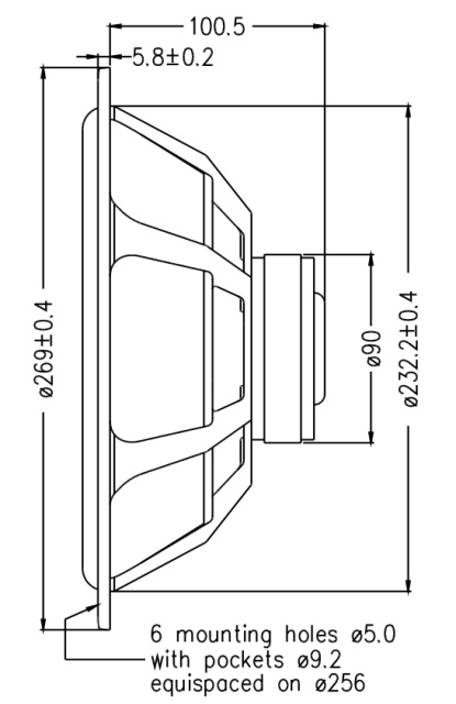

One area I'm not yet committed on is the interior bracing. I know I want some, but I'm not sure of the best approach. I'm tentatively planning to use the "World Designs" method implemented here. This approach was also published in 2006 for the floor-stander WD25T variant by Peter Comeau. Supporting the magnet structure seems like a good idea and is endorsed by SEAS, but the vertical brace behind the woofer strikes me as odd. Any opinions on this?
Some pics of yesterday's progress below. Any hints/tips/recommendations along the way would be appreciated!
BK

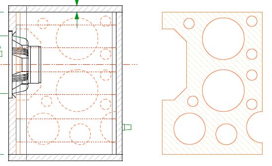

You might want to take a look at the "holey" bracing structure that P10 uses:

Bracing the woofer is a good idea but be careful so that you don't make the brace too shallow as to stress the woofer frame when it is screwed on tight on the baffle. Probably better to keep a few mm gap and then use some material in the gap that compresses as the woofer magnet presses on to it. That way contact is still made with the brace and the energy is distributed.
Also read that vertical bracing is more effective in increasing cabinet rigidity. The vertical brace should be slightly offset from center as to divide the cabinets into unequal sections.

Great idea, Zia. I think with some creativity I can re-work the brace panel I already cut. If not, that's why I brought home three panels of ply when one was "enough" LOL.
Will be tricky to support the woofer magnet and keep the brace offset. Maybe I can add a "side-car" to the brace.
I've read of folks shimming with card stock to get a correct fit between the magnet and the brace. At my skill level, woodworking is a game of "mm's" and not "thousandths" like CNC.

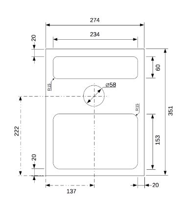

What Zia is suggesting is a vertical brace that runs front to back and buts up against the magnet, a la P10 as shown below on the left.
The WD brace format that you implemented is a vertical brace that runs left to right (and intersects with a horizontal brace). Lower section shown below from your site.
My reservation with the WD brace format is the proximity of the ~100mm (?) tall section immediately behind the woofer, on either side of the circular cut for the magnet bump. I don't know if this is a valid concern or not wrt to reflections and air movement.

I see no reason for concern, my thinking is that the spider frame is rigid and shouldn't move. It's more a question of building tolerances. It's really hard to glue the brace mm-perfect, so I suggest having a little leeway and filling it with foam.

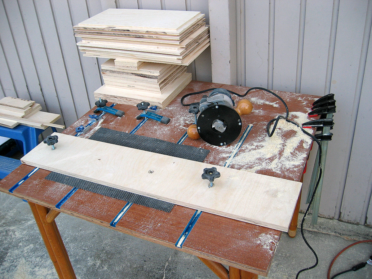

Strained my back a bit working on that 5x5' at ground level. Didn't come on until a day later - not as young as I used to be! Also decided I needed a good method of holding the work for routing. Ordered some gear to build a T-track clamping station out of a beater bench that some years ago was my eating table. With some luck and dry weather I'll be routing next weekend. :D

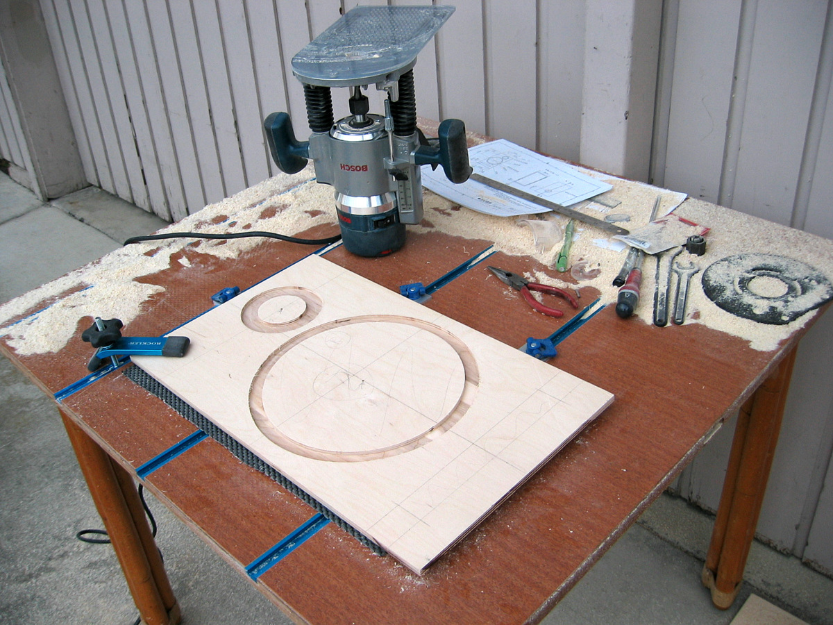

More progress.

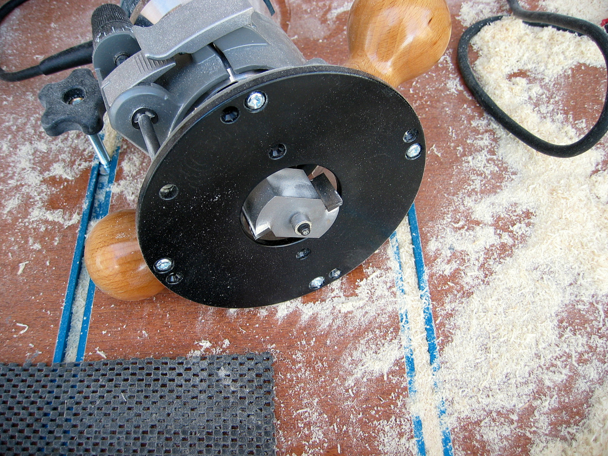

Constructed a sweet clamping station to aid the routing. That table is 3 layers of 1" hardwood ply in most places + a laminate top.
Got all the 3/4" rebates done. Happy with the outcome. Took two passes with the "big bertha" bit. It's a mean chunk of metal! By design there'll be ~2-3mm overhang on most edges that I'll flush trim with a compression bit after glue-up.
Next I'll commit to an internal brace design and add some dados for that.
BK

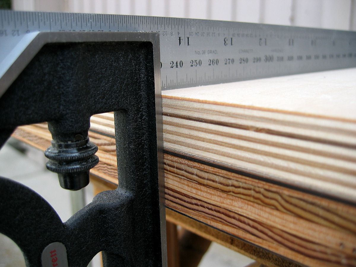

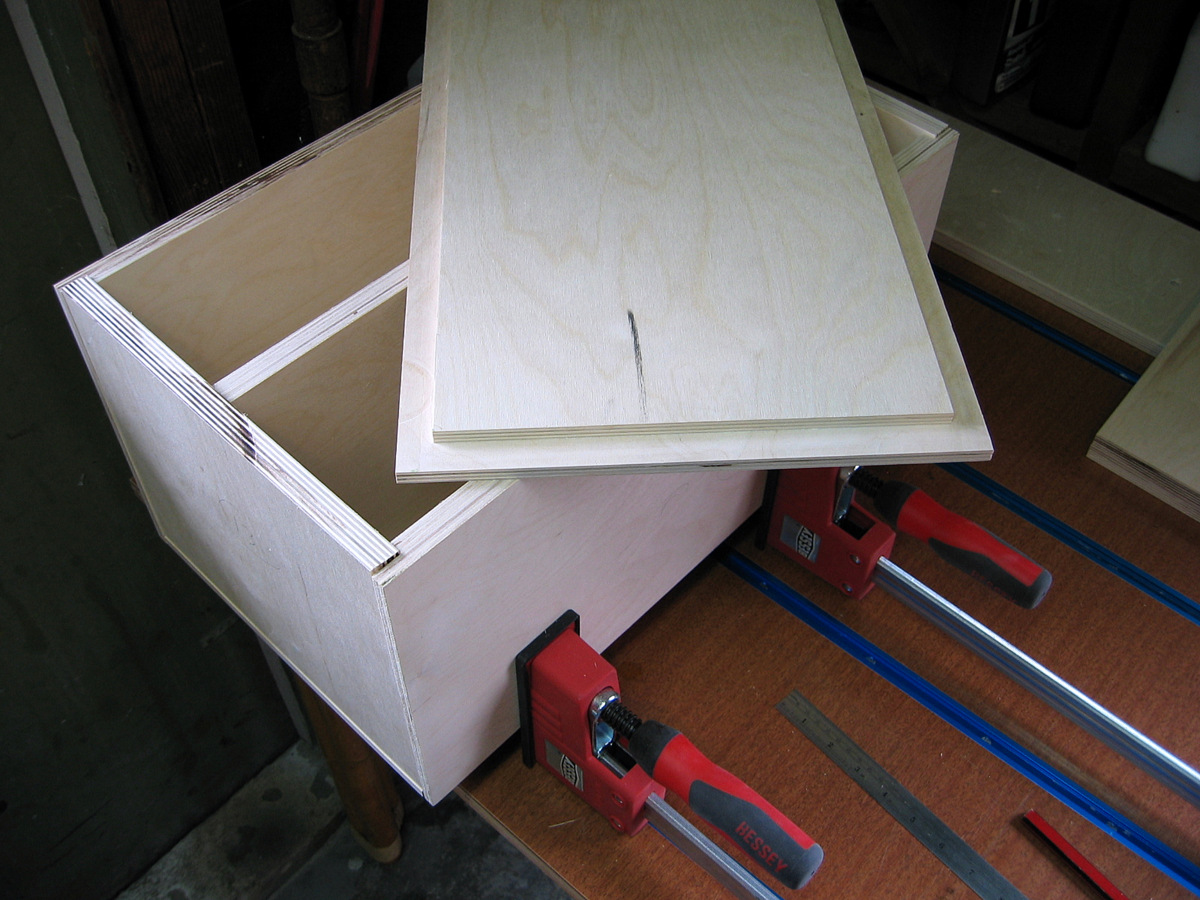

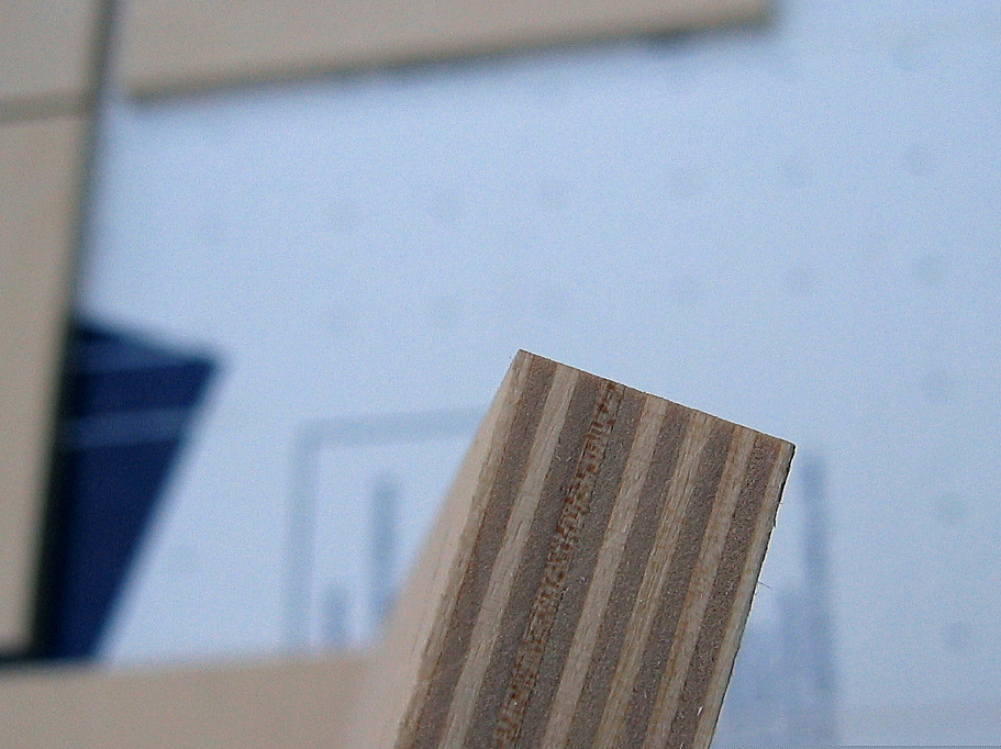

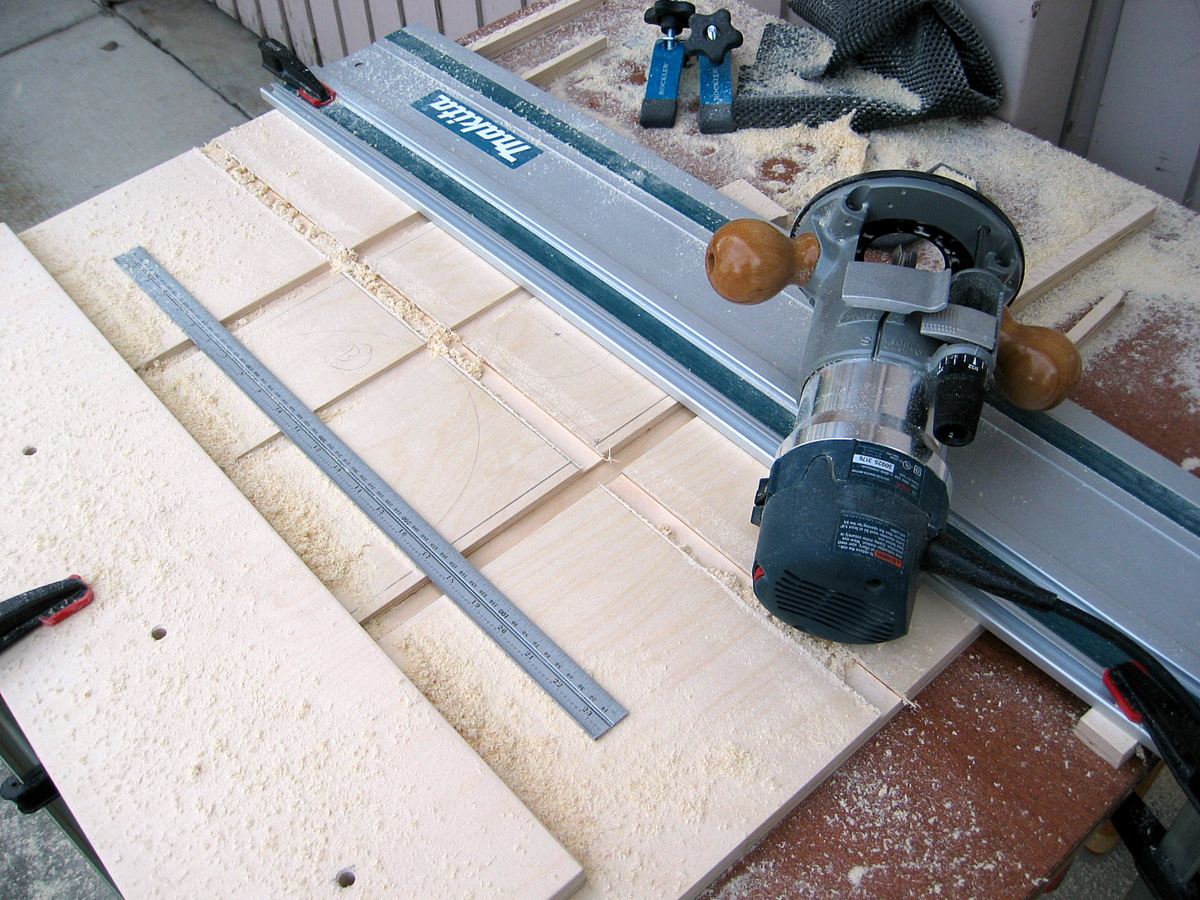

Not much real progress, but I trimmed up some pieces due to a pesky mental math error and got to dry fit everything including the bracing. Looking alright and getting to know my tools. Wish there were more dry days!
Some of the track saw cuts were not as perpendicular as I expected. Hoping I can use the router to tidy those up. Any tricks?
BK

Now have a solid plan to square up the edges - mainly for my OCD. No rain is forecast, so outlook for progress is good.

Squared all the edges that needed it with a poor-man's jointer. Created a razor sharp reference surface on my bench, clamped the pieces down and routed them perpendicular with a large compression bit riding on a bearing. Because even a thin pencil has width, I've now adopted a marking knife method. Below is before/after taking off ~1mm to adjust fit.
Got all my dados precisely cut for the bracing.
Cut the rebates for the drivers - perfect dimensions. Starting to resemble actual speakers! Still pondering how to best tackle the front vent slot.
BK
