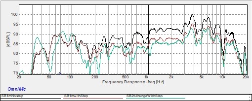

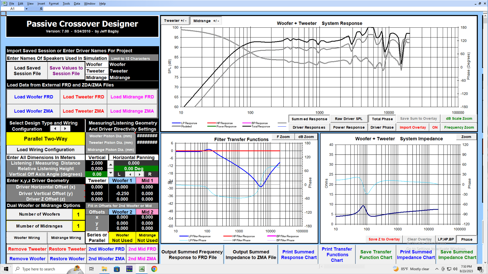

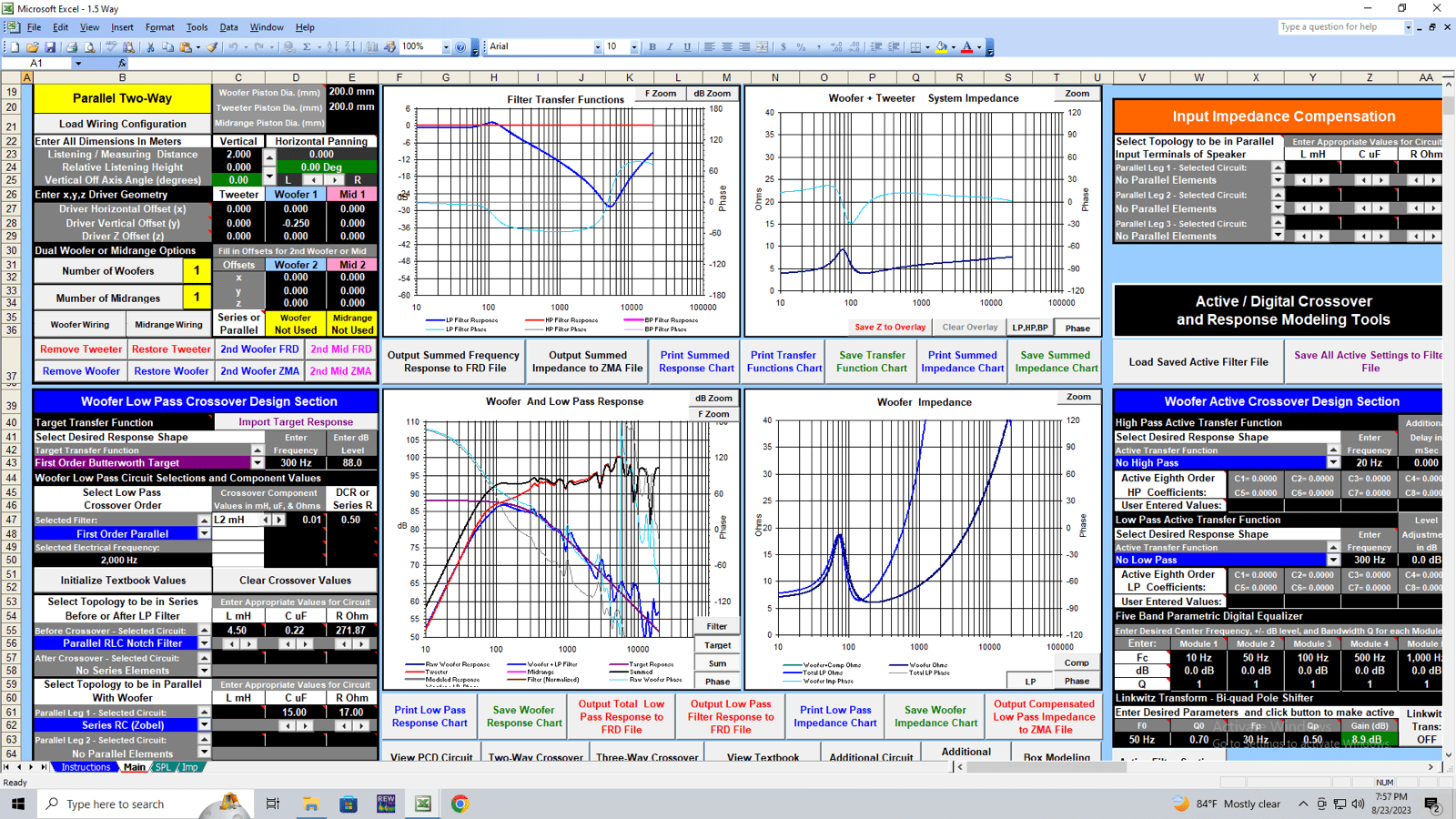

I ran a couple sims in PCD using traced manufacture data if anyone’s interested in seeing how the SB 8 inchers can work together. I also show how just the SB20FRPC looks with a baffle step compensation circuit. Sims, graphs and measurements are about as rare as a Sasquatch sighting in these full range parts, so I thought these might help someone understand what’s going on with these drivers in a real baffle and with various circuits in place. These include minimum phase, baffle diffraction and enclosure effects. The baffle I used is 14.5” wide by 23” tall.
As far as the frequency response graphs go, the top black line is the sum of the SB20FRPC and the SB20PFCR with the SB20PFCR rolled off 1st order. The middle grey line is the SB20FRPC as a full range by itself with a baffle step circuit in line. The lower grey line is system phase for the 1.5-way which has minimal error and exactly matches that of the corrected single driver alone.
The second picture is just to show the filter I used to hit a true first order target for the woofer. Ignore the .01mH value. That’s just a placeholder so that I can implement the XO/elliptical notch shown directly below. I also included a zobel network. It’s not absolutely necessary, but without it, a bit more of the upper end hash of the woofer contributes to the treble.
So, it looks like you can end up with 3-4db higher sensitivity and exactly the same frequency response and phase as a the SB20FRPC with a baffle step circuit. You also get double the cone area for bass, higher maximum output and reduced distortion for both drivers. The minimum impedance is about 4.1 ohm at 165Hz, max is 8 ohm or so and the electrical phase is basically a straight line. This should be a very easy speaker for any amp to drive. The cost of this is about $70 per side, a larger enclosure and minimal additional effort.

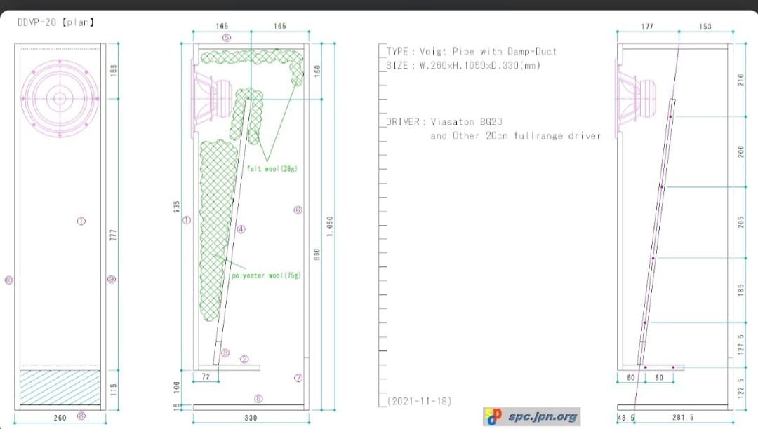

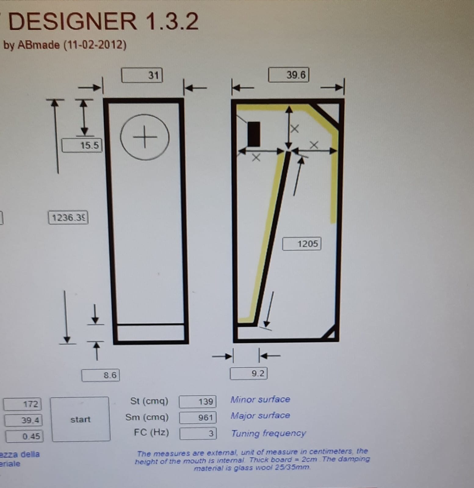

Hello!
I’d like to build a tqwt/transmission line box. If I understood well you are using this design:
In the past I used this simulator and for this speaker I got this design:
Is there anybody that can suggest me if your design or the one got from simulator is better?

If you want to confirm a given design with alternate dimensions then I would suggest to use Hornresp and do the simulation on your own. I'm saying this not blame you but if you want to tweak some more you can simply do it directly on your own and ask more specifically if your changes are noteworthy or not as expected.

I finally dredged up the screenshot I took of the shaping circuit I used. BSC with a notch to tame the 3-7k shout. Easy to adjust by swapping out resistors. R2 is probably best between 4-7ohm depending how much you like that boosted 3-7k range. So I may have ended up changing the resistor values before finally locking it in. For 13.25" (~336mm) wide baffle I found the BSC coil would be fine between 2.5-3.5mH. Up to 3.5mH gets rid of the drooped upper bass a bit better, just depends how much db/watt overall you are willing to sacrifice and what sounds good to you. I stuck with the 2.7mH for now.

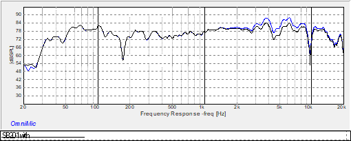

I used a 3.2 mH and 6.8 Ohm the values I have at home (calculated values for a 17" wide baffle is 3.3 mH and 5.6 Ohm). I used Dayton Omnimic to measure the response at 1 m in a rather probematic room.
Kudos to SB! The two drivers measure the same and the results are consistent with the published curves!
The balance gets better with the baffle step
I will also try the other part of the filter to tame 3-7 kHz peaks

I tried the suggested LCR trap and it does reduce the two peaks but it also deepens the dip between them. I might load the whole thing in Xsim and have two high Q filters one aiming at 3.5 kHz and one at 5 kHz.
The LCR trap did improve the sound! When I used a LCR trap on a Goodman Axiette Alnico the frequency response improved but not the sound, rather the opposite in fact.
