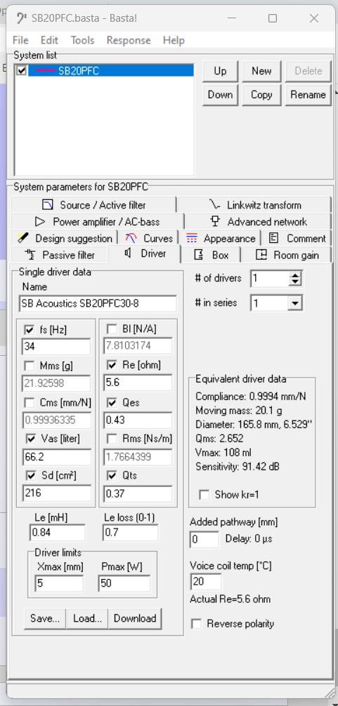

Do you have any idea what I’m doing wrong? I’ve gone through every possible setting that I can find. Thanks
I used the manufacturer's data for both drivers.

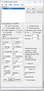

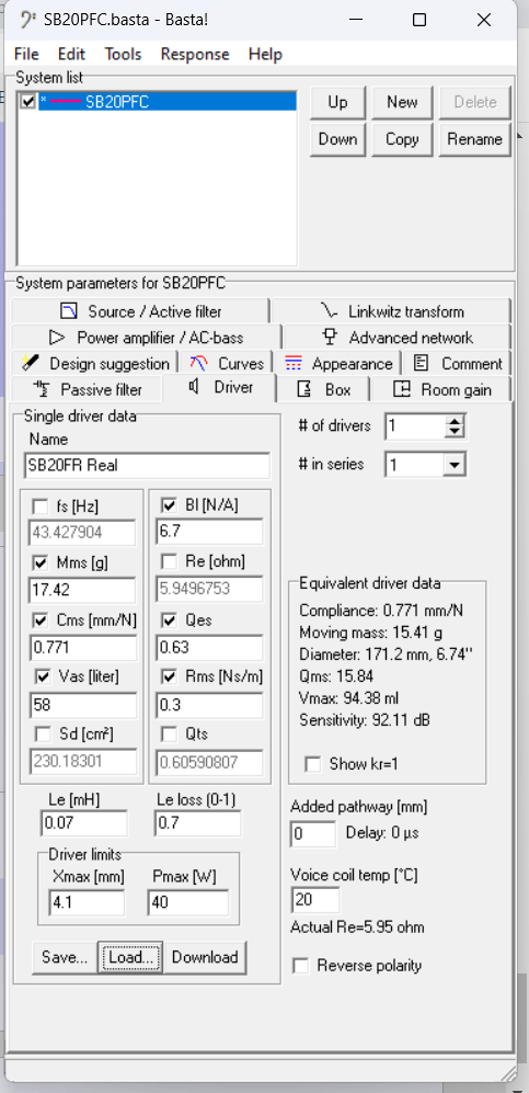

Below you'll find 3 images of the system parameters window, one for each driver as per the manufacturer and 1 for a real SB20FR which I measured myself using LIMP.
Also make sure that you have the room gain enabled for both drivers in your simulation.
Thanks GM. I read that three times and I’m not sure I follow, but then I often don’t understand half of what you say lol. You’re just too advanced for me I guess. I’m guessing that your just screwing around with those very specific XO points? Anyways, this is a .5-way not a 2-way, so it doesn’t have a XO per se.Dunno, depends on what the drivers actually measure. Regardless, the way I figure stuff, the XO point would normally be ~349 Hz, though considering the under-damped alignments would opt for ~108 Hz (or 'close enough' THX LFE 120 Hz or ~195 Hz if doing passive due to component cost) to isolate the mid-bass and make the divided! box either 15 L each with the HF ~aperiodic and maybe experiment with the LF box taking up most of the space, though either way removes any LF influence on the HF with the XO trimming it even more as we're mainly concerned with getting the > 250 Hz BW 'squeaky' clean.
Sounds like divided box is the consensus, which kills my design. Maybe I should just use two of the of the full range in a .5 alignment. I’ve done 2.5 ways before and I don’t use separate enclosures with no ill effect. My only real issue with that is I don’t want the full baffle step comp.
Stanislav, I used the manufacture data and I triple checked it. I don’t think I have room gain enabled though. I was waiting to mess with that until I got everything else working. I think I’ll just start over. After first entering the FR data, I believe the sensitivity was correct. Then it all changed for some reason.
Still confused about the phase rotation though. There basically shouldn’t be any. And there’s no way to unwrap it that I see.

Stanislav- I started over in Basta! And it’s all working fine now. The issue with the sensitivity was that I changed the listening distance to 3M. I have no idea what was going on with the phase though, but it’s fine now.
