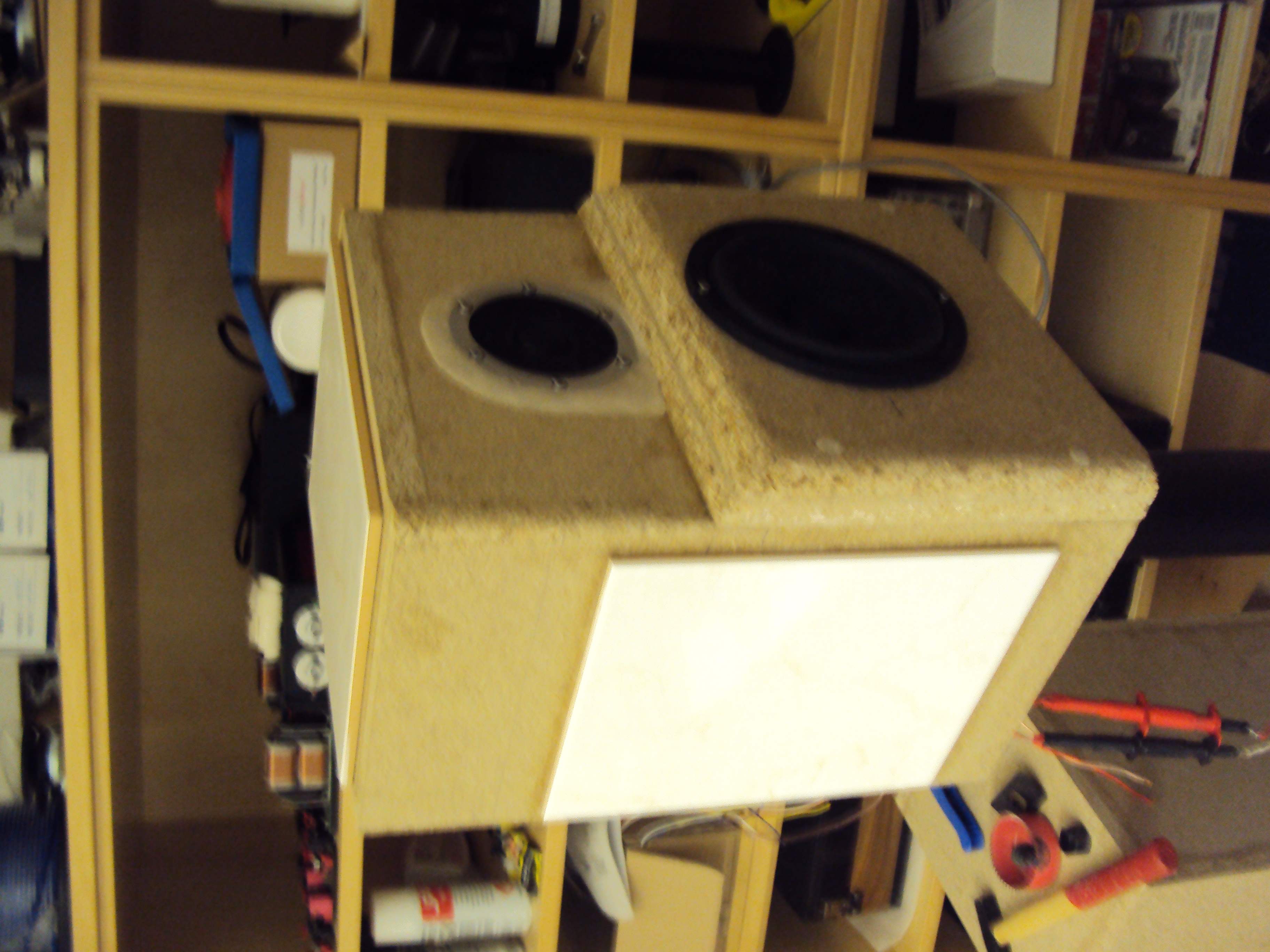

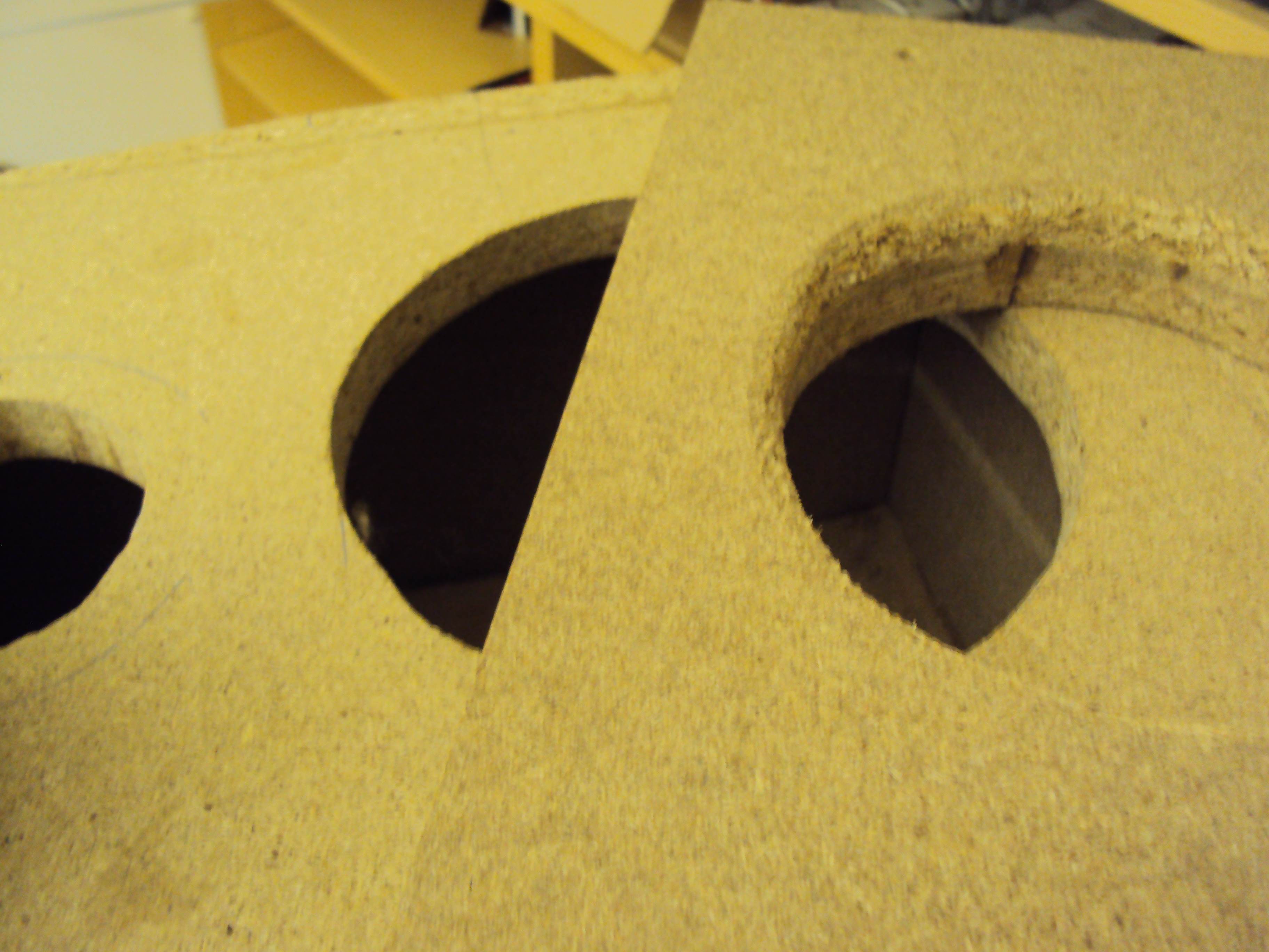

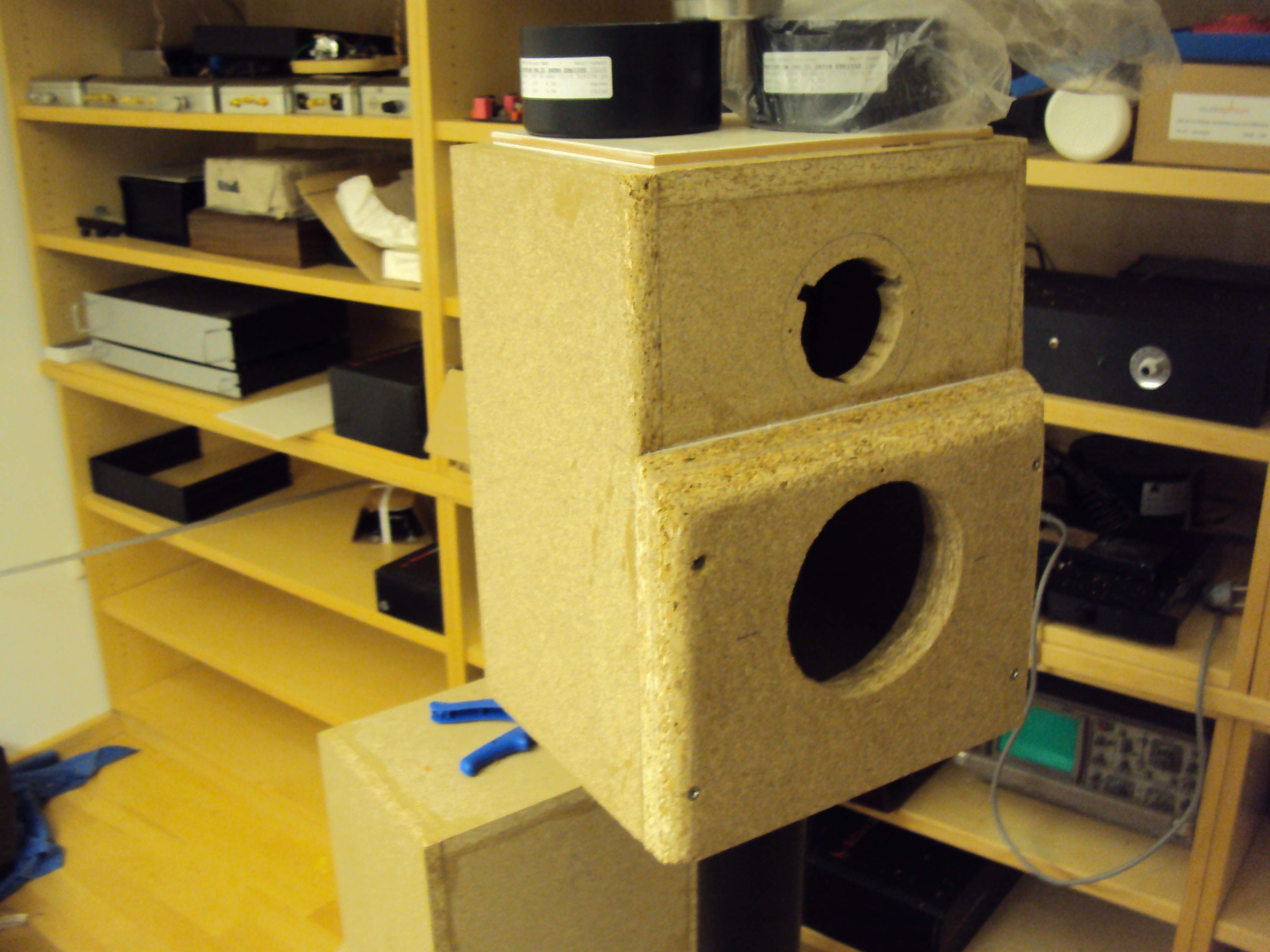

The front baffle of the DIY version is quite thick so i made the inner hole bigger and rounded the edges of the outer whole for the woofer.
I chamfered and rounded the baffle. I will glue tiles to the top and the sides too.
I put in the reflex tube from the back.

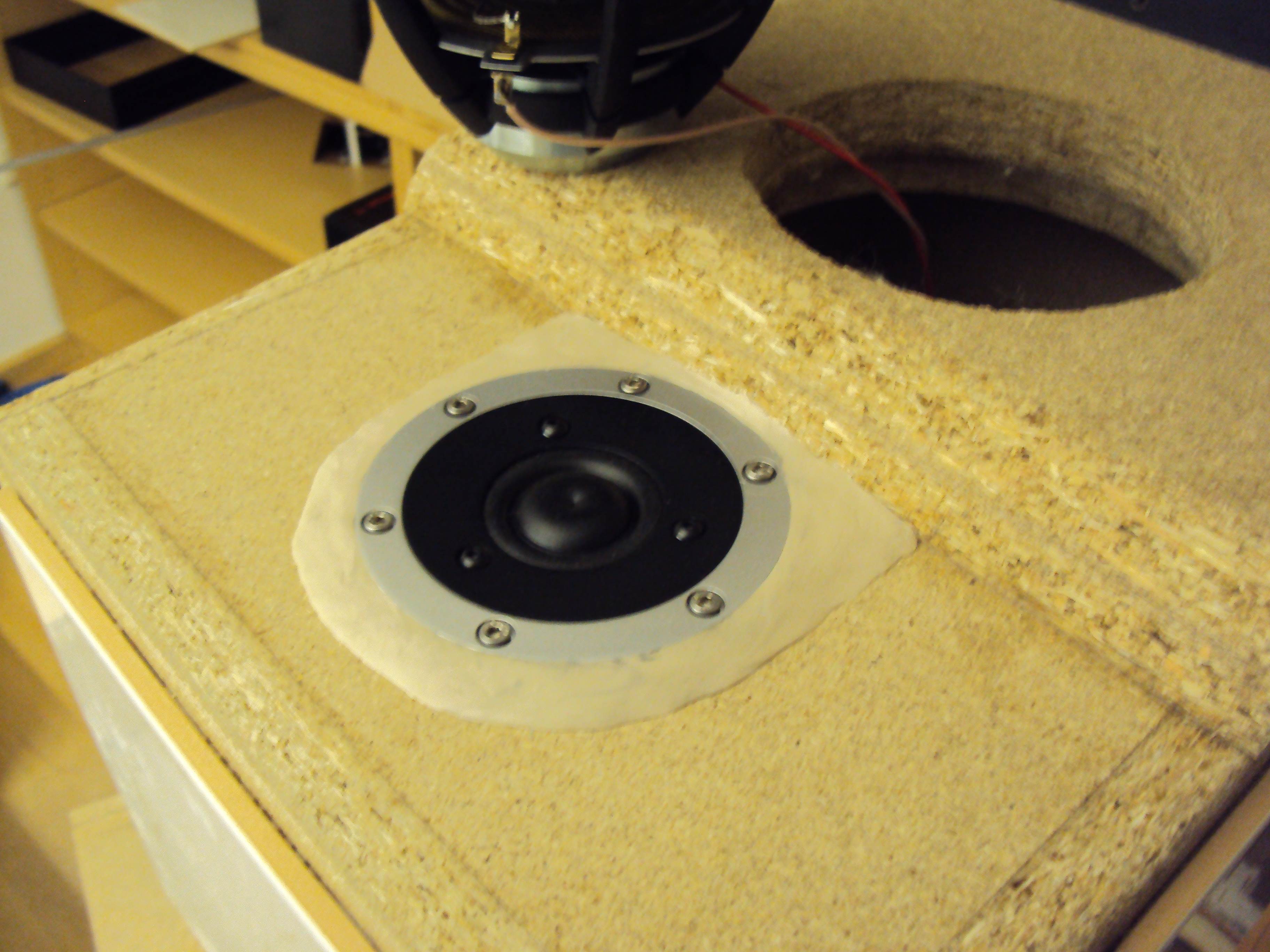

I have now put the drivers into the cabinet. I also smoothed the edge of the tweeter with plumbers putty. This and the rounding and chamfering of the cabinet has a very positive effect on the frequency response of the tweeter.
The reflex minimum sits quite symmetric on 36.5Hz without any wrinkles in the response over 100Hz. That shows that the cabinet walls are stable and there is enough damping material in the cabinet. I used natural sheep wool. 1/2 20 liter package.
I will show measurements soon.

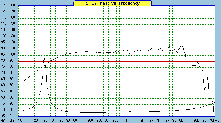

Here are the measurements i took today. Woofer nearfield, woofer with reflex port nearfield, reflex tuning, tweeter on axis, 15° off axis.
