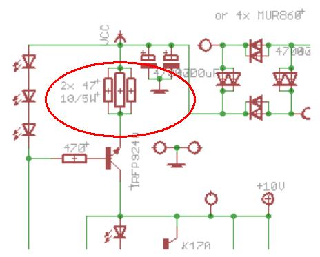

Hello everybody,
I would like to know how to calculate the resistors on the shema attached
Serge
Those resistors will set the current that flows trough the regulator. The smaller they are, the more current will flow and the hotter everything will get, including the resistors themselves.
2x47 is the default, low-current version of the schematic, anything lower you put will result in more current. If you look trough this thread and/or the original build thread, you'll see many examples.
estimate the voltage across the current setting resistors.
As a first guess take 1.8V
The current through one 47r resistor is given by:
Iccs = V / R = 1.8 / 47 = 0.00383A = 38.3mA
Put in two parallel 47r and the total ccs current would be 2 * 38.3mA.
But before you decide to put in parallel resistors, build the circuit and measure the actual voltage across the current setting resistor. It could be anywhere in the range 1.4V to 2.2V and varies with the tolerances on all the components around the CCS.
Let's say you measure 1.681Vdc.
The CCS current is 1.681/47 +-resistor tolerance +-DVM tolerance. ~35.8mA+-tolerances
The power dissipated by that resistor is given by:
Pq = V^2 / R = 1.681^2 / 47 = 60mW.
A 600mW resistor will be running at ~ 10% of power rating (=cool).
Now add a second parallel resistor.
The voltage across the two resistors will drop slightly, maybe to 1.676V
The CCS current is now 2*1.676/47= 71.3mA+-tolerances and each resistor dissipates 59.8mW+-tolerances.
47r does not need to be a power resistor.
20r would dissipate ~150mW, a 250mW resistor would run very hot, a 500mW resistor will run just under hot, a 600mW resistor will run more than warm. You still don't need power resistors. But it depends on the voltage across the resistors. You must measure your build to find the Vdrop.
If you reduce the CCS current setting resistor to 10r then Pq does become an issue.
Do the measurements and do the sums.
