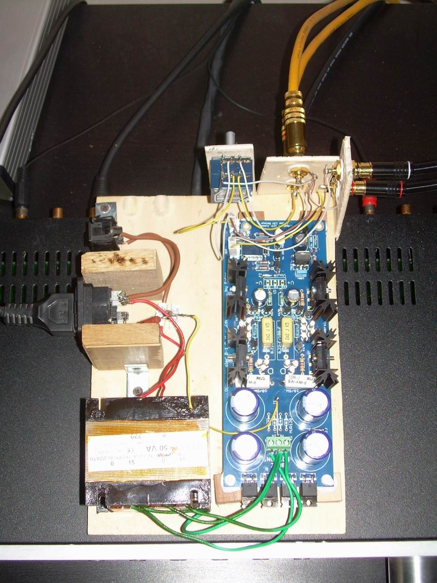

Ciao a tutti,
my hot rodded dcb1 just finished :)
Some test value :
1) Vout + 10,09 v ; Vout -10,00 v .
2) dc out : right channel -0,1 mv left channel -0,8 mv
3) ccs sink temp : around 49 °
What do you think about these value, specifically Vout?
Next step: fit it in a case ( probably hifi2000 gx288 model ) and build a
lightspeed volume control.
Now is time to play and enjoy music with it ;)
A great thank you to all members involved in this diy project.
Anto

Interesting system. And what are you planning to do with DCB1? Use it alternatively to a preamp, or just buffer a DAC? You should watch grounds with so sensitive loudspeakers for no buzz. Let us know impressions. Regards.
I have built pass f5, penasa my ref and my evo too...:eek:
For now I will use dcb1 with lightspeed as general pre swapping it with the others pre.
Very interesting idea buffer dac with it.
Could be put into a greater case with one of penasa's ampli in order to obtain an integrated amplifier for a second smaller hifi chain.
Will post some listening impression soon....
