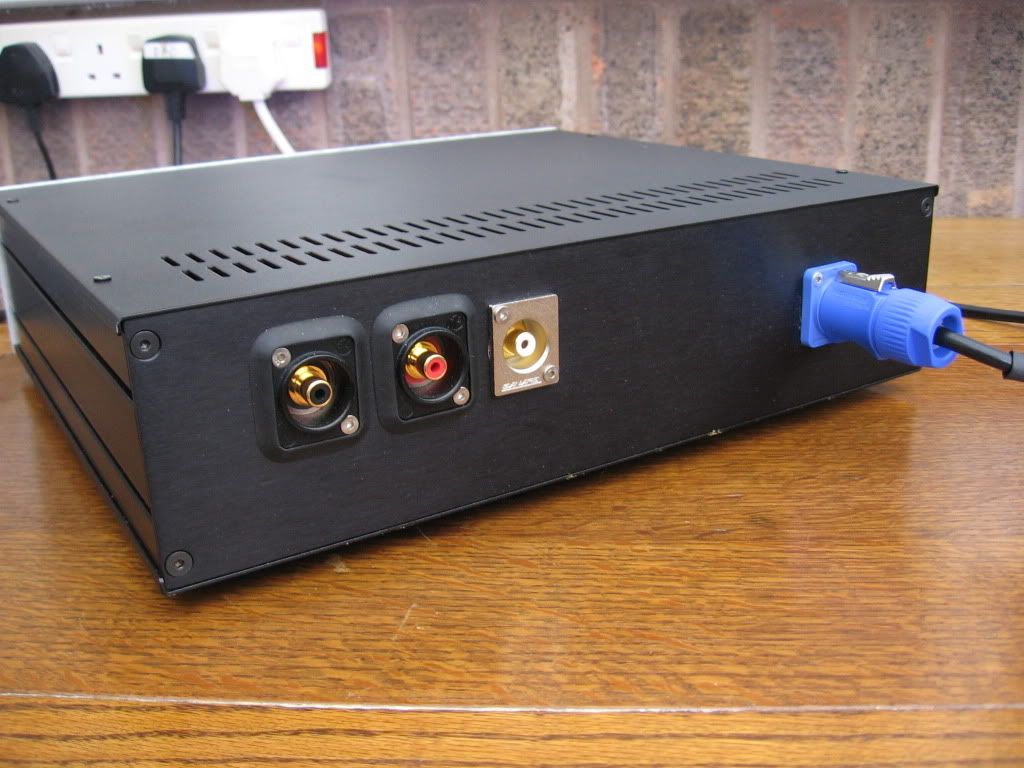

Hi, has anyone had any experience with these chassis?
Autocostruire - made in italy audio tools
They look great, they might fit the bill.
Merlin - they are Modushop chassis parts, exactly the same. Very much recommended. See post #693

Did you drill out the chassis yourself?
Great, thanks.
I did yes, just using a bosh hand drill. Very easy to drill as I bought the case with 3mm front panel for now. I intend to have some nice custom 10mm panels made by Schaeffer AG one day.
The large holes for switch, power inlet and RCA sockets were cut using metal hole cutters like this:
BOSCH|2608580402|HOLESAW, HSS, BI-METAL, 22MM | Farnell United Kingdom
http://uk.farnell.com/ruko/106-201/arbor-holder-with-pilot-drill-type/dp/379128
RUKO|106 201|ARBOR HOLDER WITH PILOT DRILL | Farnell United Kingdom
Is that a 2u or 3u case?
I'm looking at a 2u, and the larger caps just fit in the case (it would leave about 10mm room up top).
Oh, one other thing, I thought the 3mm front panels had holes in them for rack mounting?
