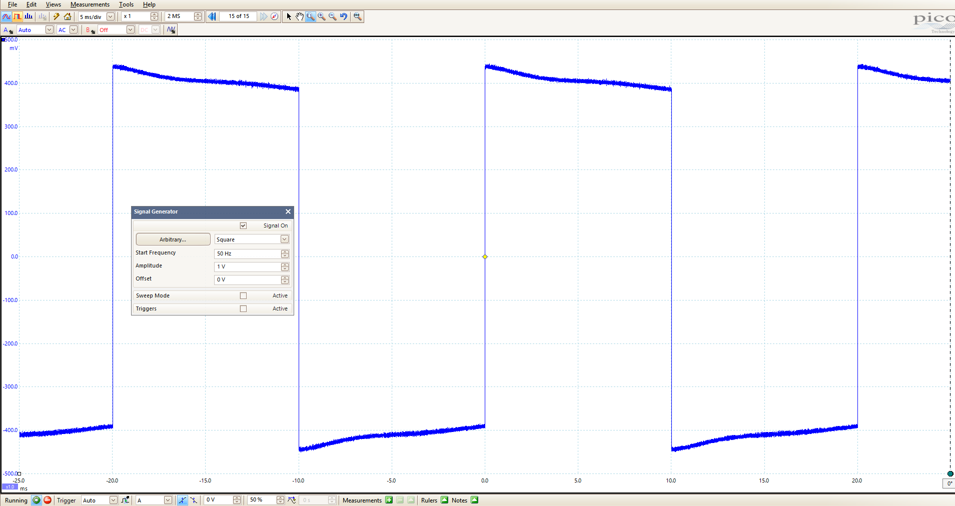

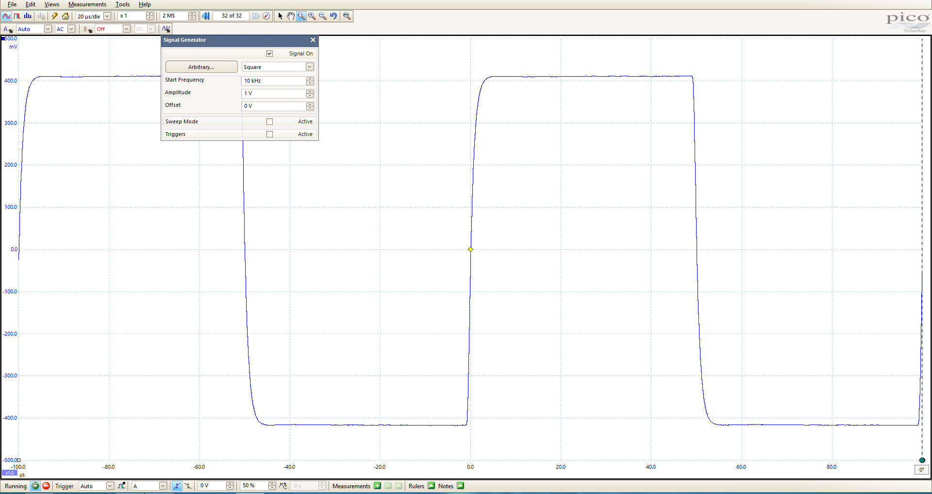

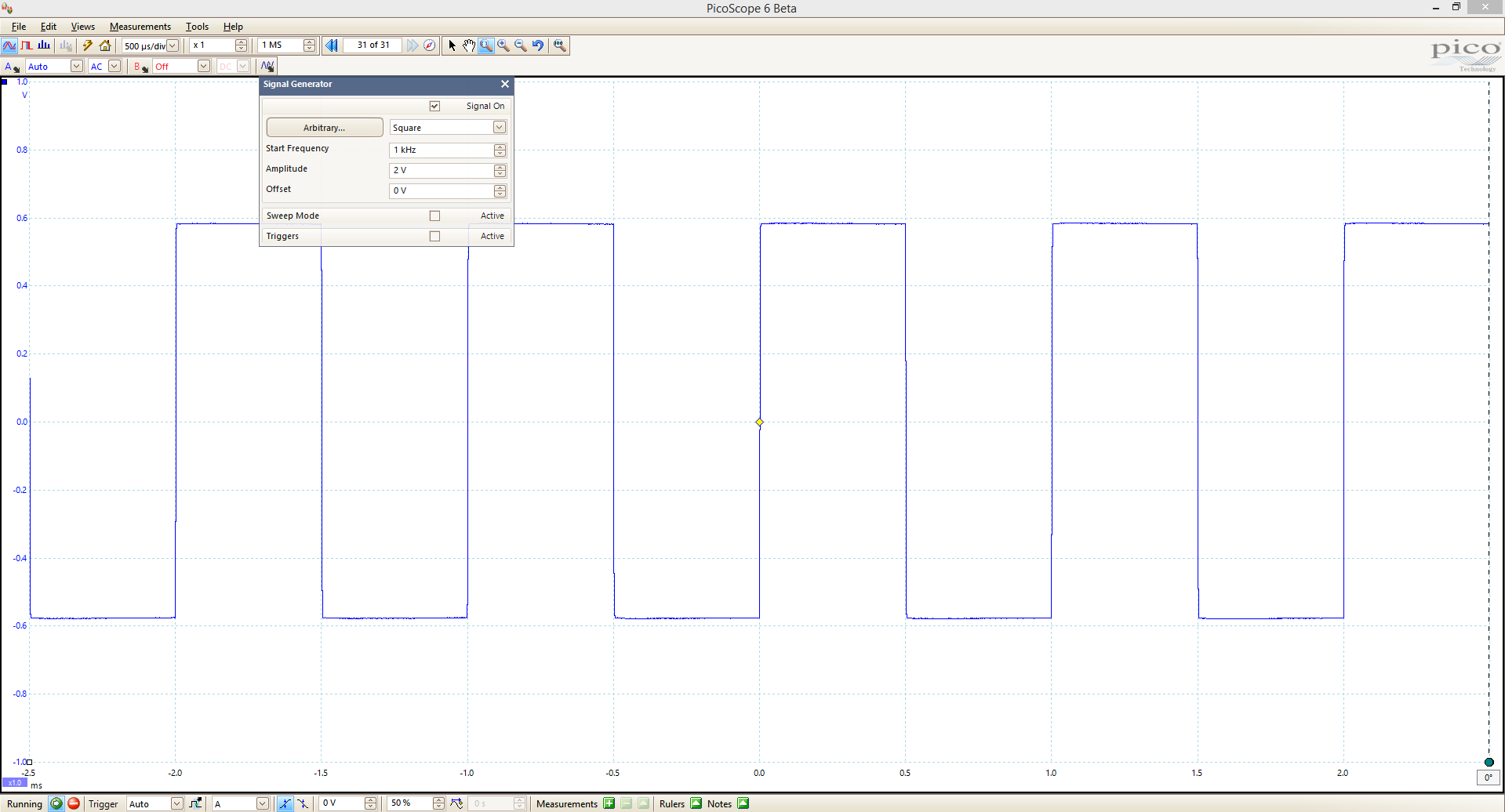

Did some measurements the other day.
To be honest I am a bit new fiddling with the scope. Anyway I feel my dcb1 is a bit to "light" in the bass Otherwise it sounds very good.
As volume control I use Lightspeed (ldr) - Maybe this is the sinner? I don't know yet.
Perfect 1khz squarewave
Next to perfect 10khz squarewave
But what happens with the 50hz wave?
PS: This is running with no load.

diyAudio Chief Moderator
Joined 2002
DC couple the scope input for under 200ΗΖ squarewaves. They got a small value capacitor normally on AC input position.
The long run DCB1 subjective feedback merits the bass area so a feeling of lightness there its possibly due to a peripheral circuit or 600 Ohm input amplifier? On anything > 5kOhm it should do well.
Make sure that the input impedance of the LDR is easy on the source equipment used.
Also high hot-rod enhances the feeling of tonal completeness. Let it run in its electrolytics first before any further mod planning in any case.

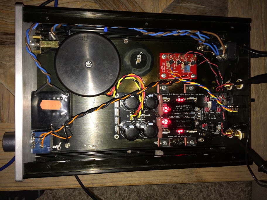

I did some drilling and rearranging, and put in all in the case, formerly known as a cd player:
The blue leds are there by accident, standoffs were not high enough, so leds on the negative reg burned out. :eek:
Did some bypass cap testing also:
1. Teapo low ESR 470uF, this sounded better in the bass, a little faster. No measurable difference in noise
2. Tantalum 330uF shows that measuring is not all. Noise a little lower than above, but sounded metallic, so had to go
3. Russion PIO 0.22uF as bypass over the Teapo brought back the bigger stage, and slightly more transparent highs.
Happy now, so waiting for new red leds. When I need to remove the print for replacing these, the start delay and dc detecting system will be added.
Actually happy that it will take a while for the leds to arrive, time to listen!!:D

Basically I took a Sony CD player that was beyond fixing, took all innards out, and threw the front panel away. Out of a piece of wood ( oak in this case, it was a leftover piece just large enough ) I made a new front panel and sprayed it matte black.
I am always amazed about the price of even simple cases. Most of them on ebay that are affordable are in odd sizes, too small for my liking. The better looking cases still need the drilling and don't have any lettering on them, so the result when you want to do it all yourself will never be anywhere near professional finish. Then there are some cases that come predrilled with source selector and volume control position, and lettered accordingly, but they have the brand printed on the front panel. As it will be my amp, not the case builders, will not buy them too.
For me it is better to have a clearly diy built case, then the missing printing on the front looks more logical. When any of you have found a good way to get white letters on a black front in a neat way, please provide the info about how to do that. Black on aluminium is far easier, but I don't like aluminium fronts, they don't look good in my house.
My power amp is in a case ( and uses the transformer ) of a 2x150W PA amplifier. Still need to repaint the front panel ( it is aluminium ) but perhaps I will get my hands on a piece of sheet metal or aluminium and replace it completely. It has two pots for master volume setting that I don't need...
Sorry for the ramble;)
