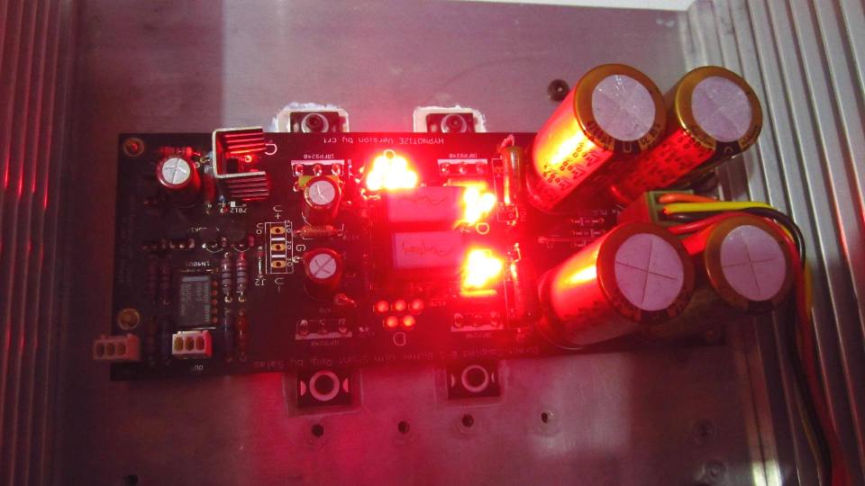

My negative reg side seems not working normal. Group of 5 leds light glow is very low, but none of them are dead. Measured voltage on V- is -20V while V+ is working good at +10.4V. I'm using 2x15V transformer.
I also try with 2x12V trans and measured V- is -16V and V+ is +10.4V
What parts should I check and replace if needed?
If you have -20V where it should read -10V then the regulator is not working.
That will make the follower/CCS buffer run very hot. Maybe even damage these 4 jFETs.
A downstream fault in the relay and it's drive circuit cannot cause the regulator to run High.
Have you checked the AC input voltage, the DC input voltage at the smoothing caps?
