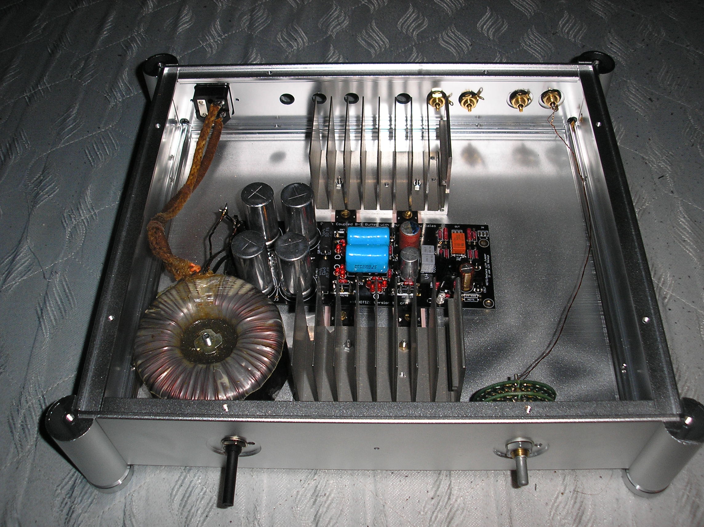

Thanks guys! My impression is that this unit is simply brilliant.
It adds no distortion or coloration but does help a bit with dynamics. Where I find it helps the most in my system is with vinyl replay, I was not using it for a couple of weeks there because of a low hum issue but I really missed it when playing my lp's.
The DACT pot is quite noticeably clearer than the carbon Tocos pot I was using in my separate passive pre-amp for control at first.
The unit is very quiet indeed now and takes pride of place on my rack, cheers

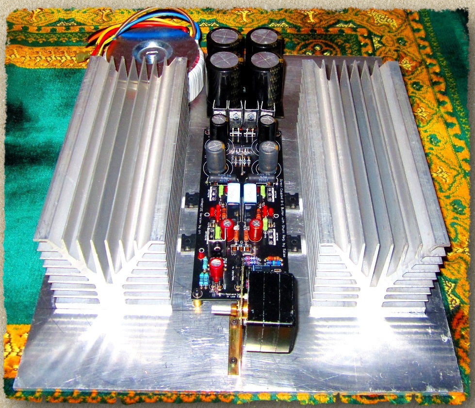

That's impressive heat sinking you have there gadut, how much power are you going to put through it?
I wondered if my 2x12v rated transformer would provide enough voltage but at 200mA I still get nearly 14v from it so it's not an issue. I tested it with a dummy load and had to draw around 2A before it's output dropped to 12v.
I'm expecting 600mA with dale 2r7 6W ccs resistor. It's talema 2x12V 160va that I have now, I'll try to check output voltage next week -I got 1 week holiday
I'm ordering another 15V transformer to give more voltage room since my mains is not stable,while existing 12V can be used for another project.

The Salas Style Shunt regulator requires a higher voltage drop to operate properly.
Usually we aim for at least 5Vdrop across the regulator to ensure that the CCS is actually sending a real constant current.
To ensure that minimum of 5Vdrop we often adopt >=7Vdrop for normal operating condition.
12Vac cannot get the necessary 17Vdc to power a 10Vdc regulator at the full range of mains voltages.

My 12V transformer outputs around 14V with the DCB1 running at 200MA.
I measured the + rail at 10.36V and the - rail at 10.24V
It seems to work very well indeed, is there any reason why I should fit a higher voltage transformer if I don't intend to take the unit to the next level?
