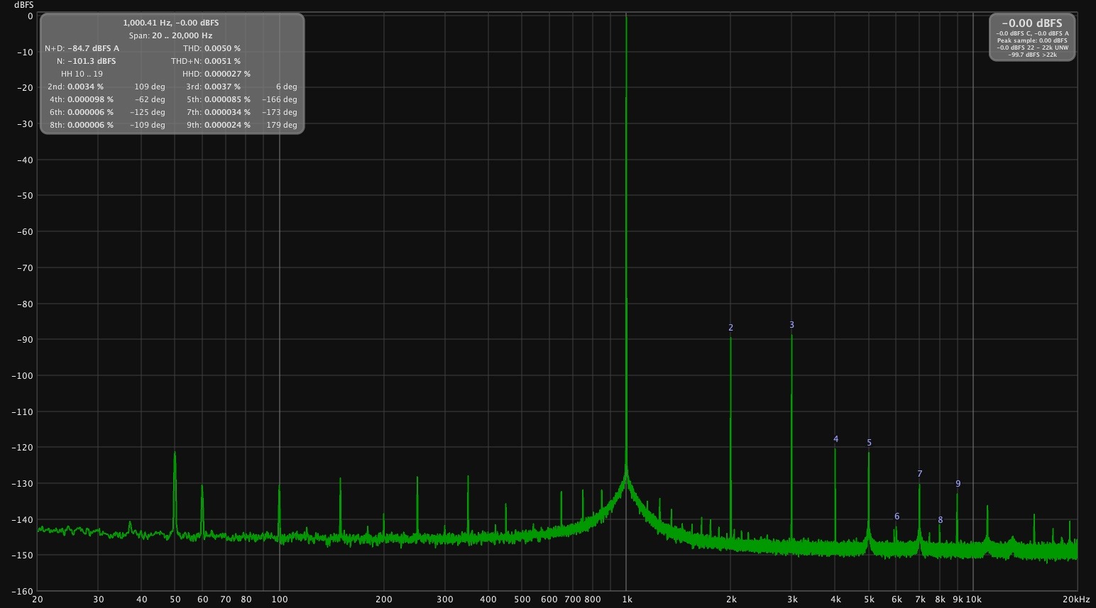

Before I´ll do a second attemt implementing a muses 72320 volume control a couple of quick measurements using an SSL2+ audio interface. -6dbFA and 0dbFS. Volume pot is a bourns 20k log for the time being.
The 1khz tone was fed with another soundcard. I guess quite a bit of the thd is from that.
Feeding with same soundcard I got a lot of distortion. Gnd loop I guess.
Is it healthy?

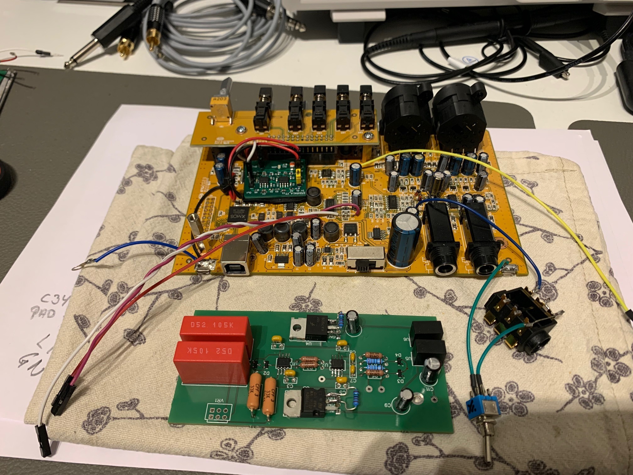

It was for me a looong journey, because i bought the Behringer UMC 202HD, and it was not very good stock that is...
Well well well, i saw the thread here on diyA https://www.diyaudio.com/community/threads/behringer-umc-202hd-for-measurements.341309/ and i began to investigate stuff.

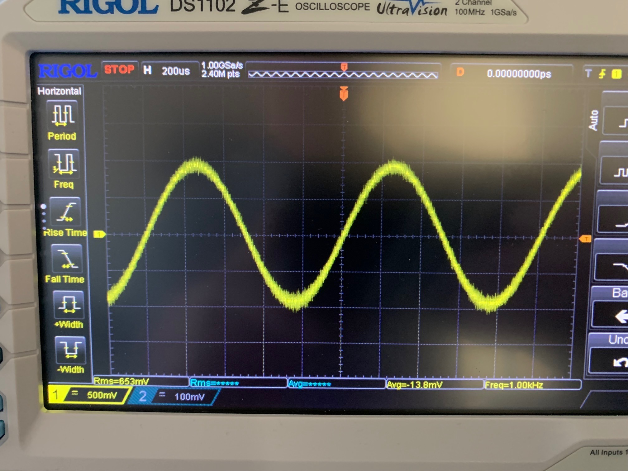

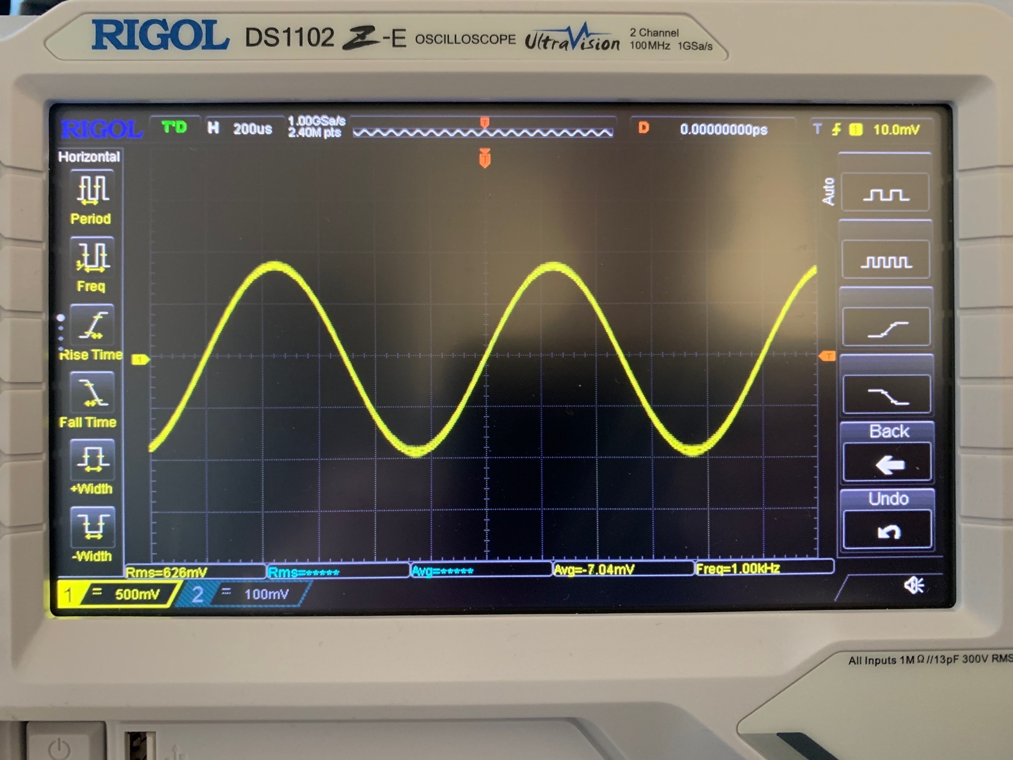

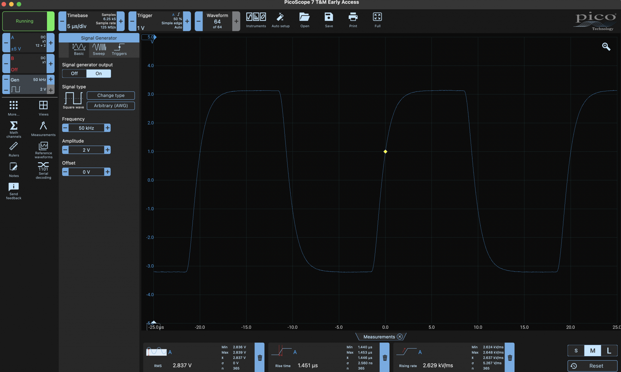

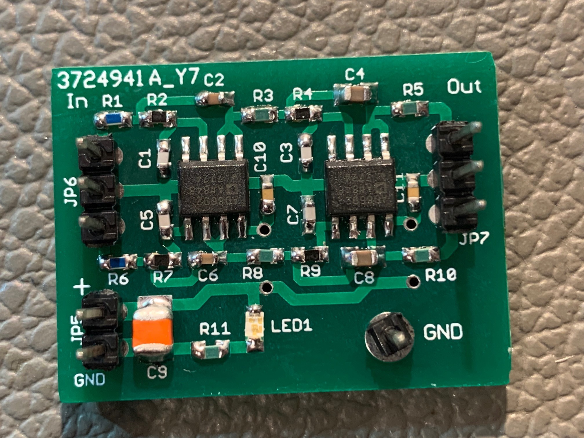

First thing i did was user @alfredr 's very nice lowpass-filter.
The output get's cleaned up a lot, when using this little thing... thank's @alfredr
Sine 1KHz with and without his filter... pictures tells everything here.
Very good... i now own a good sinewave generator

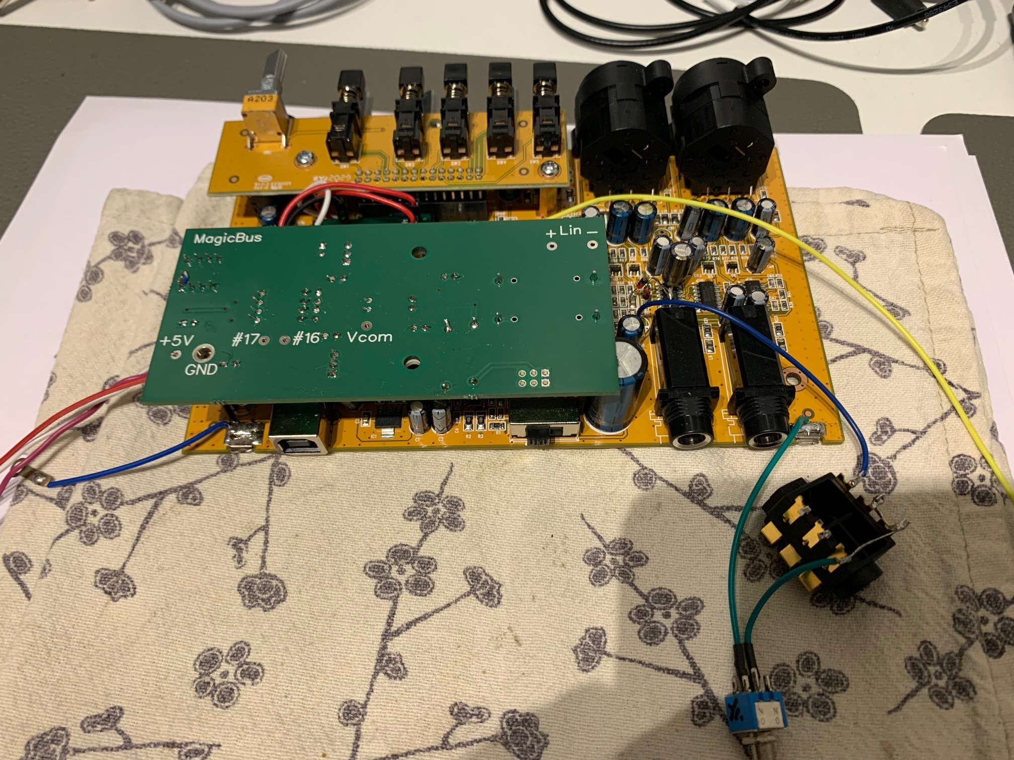

Along my journey i fighted a lot with noise, spikes and hum, having still not so very good measurements.
User @YashN did a very good mod, with some direct input, i also did... Thank's @YashN.
But still fighting with spikes and noise i stumbled over @MagicBus 's balanced protoboard. (never tested i guess)
Along with some trial and error's i finally got it up and running.
Showing good result's

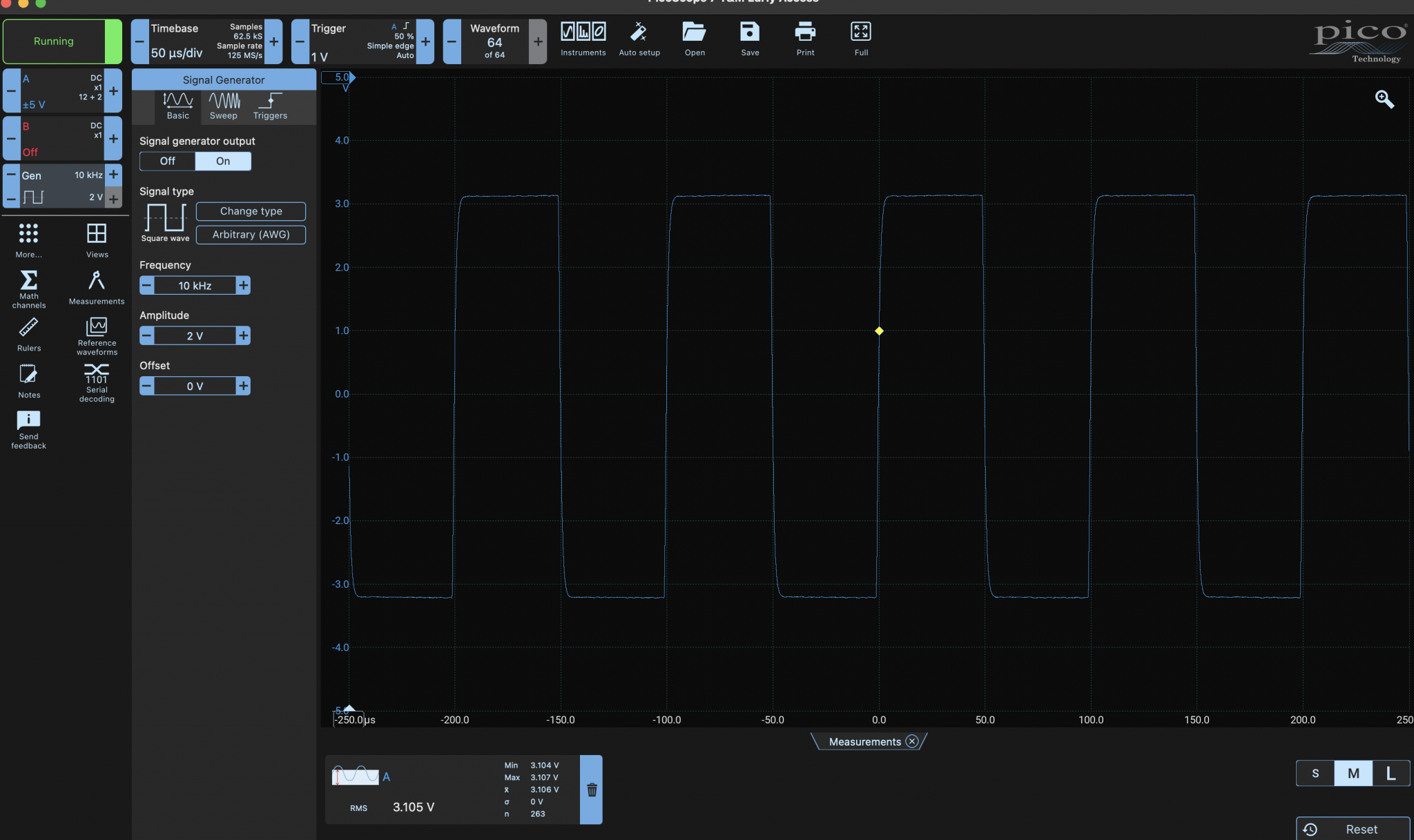

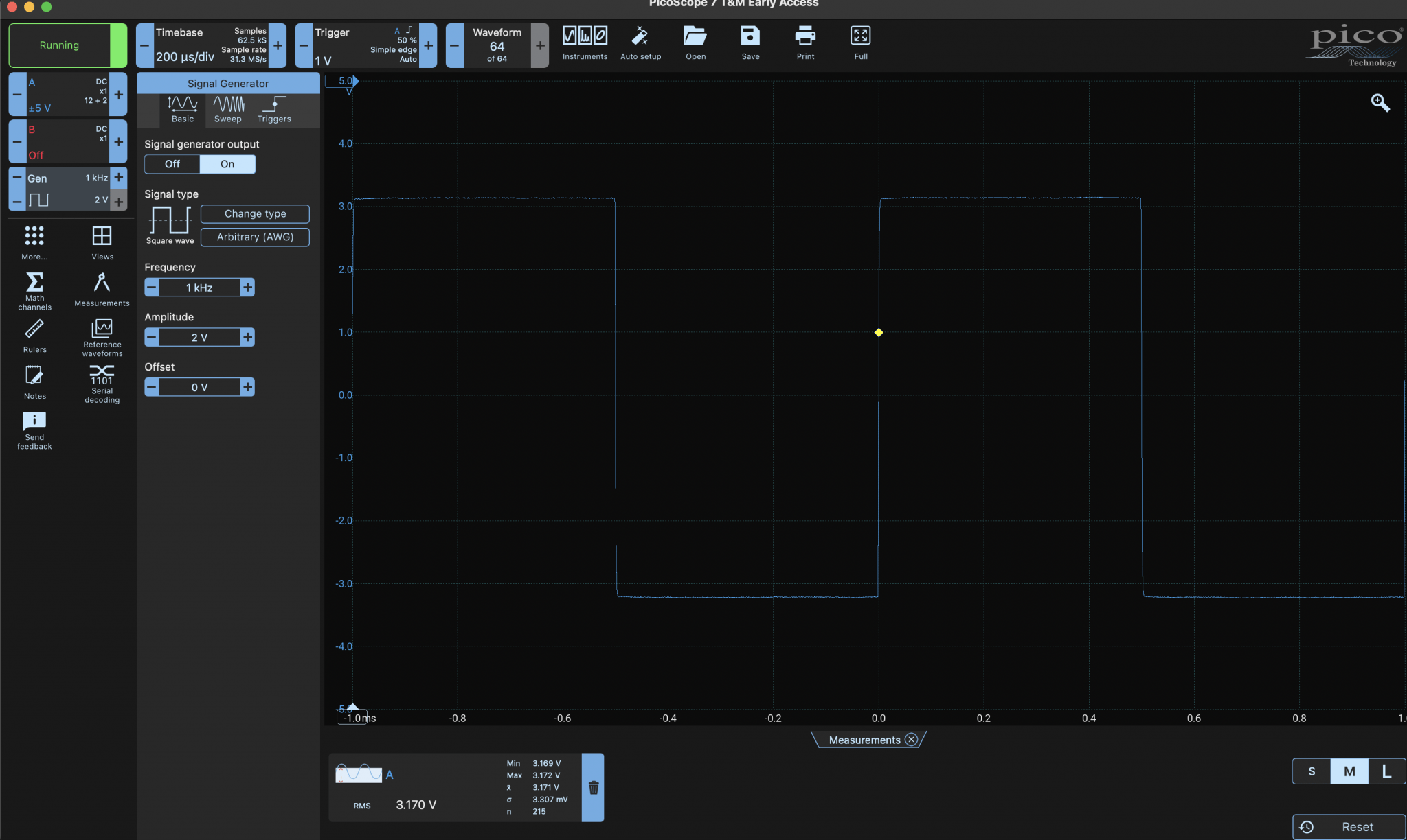

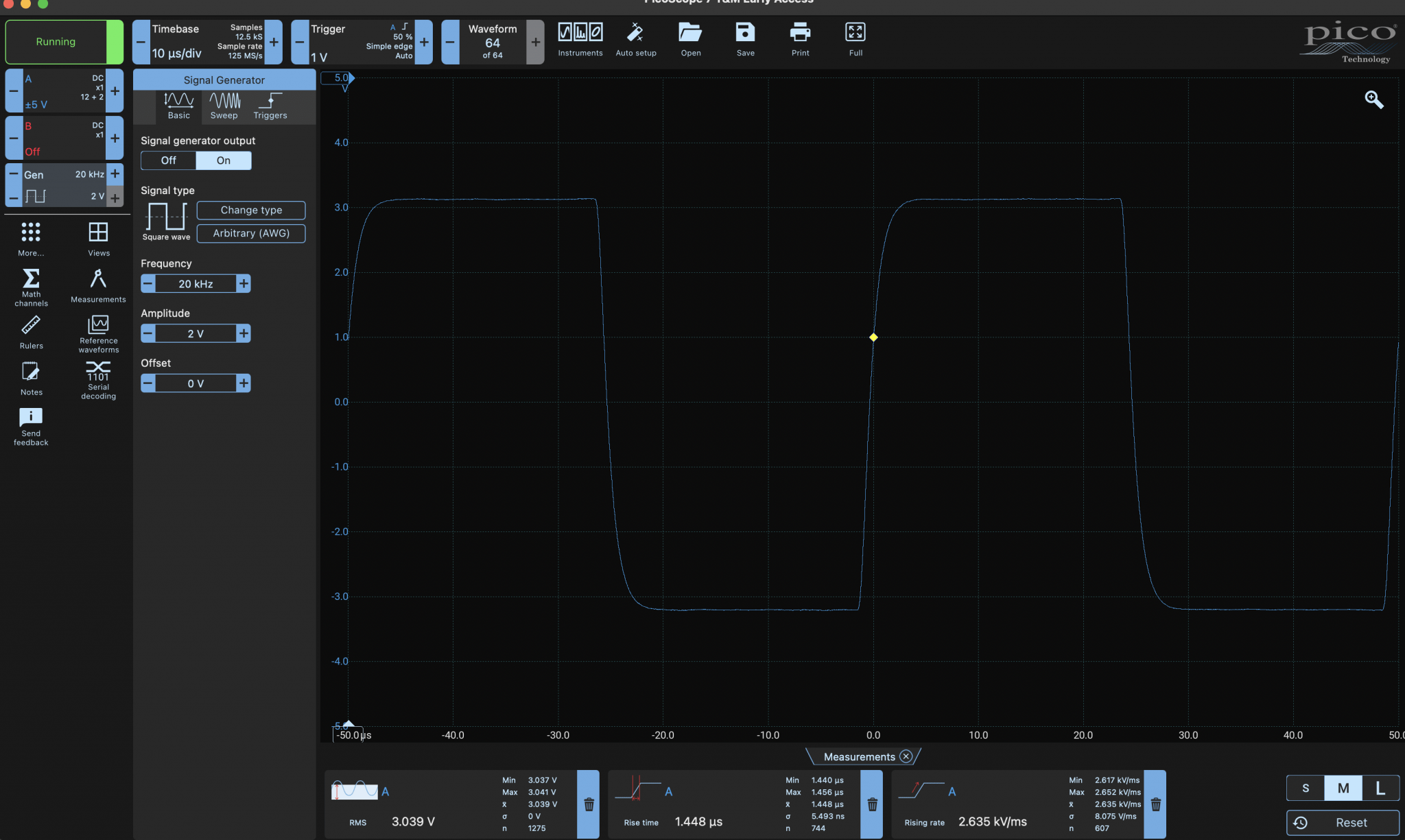

THIS is along with Victor's 1KHz osc ::
And finally i'am able to do some real world DUT!

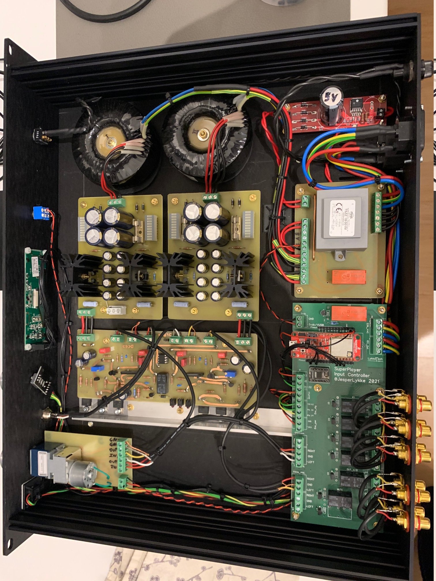

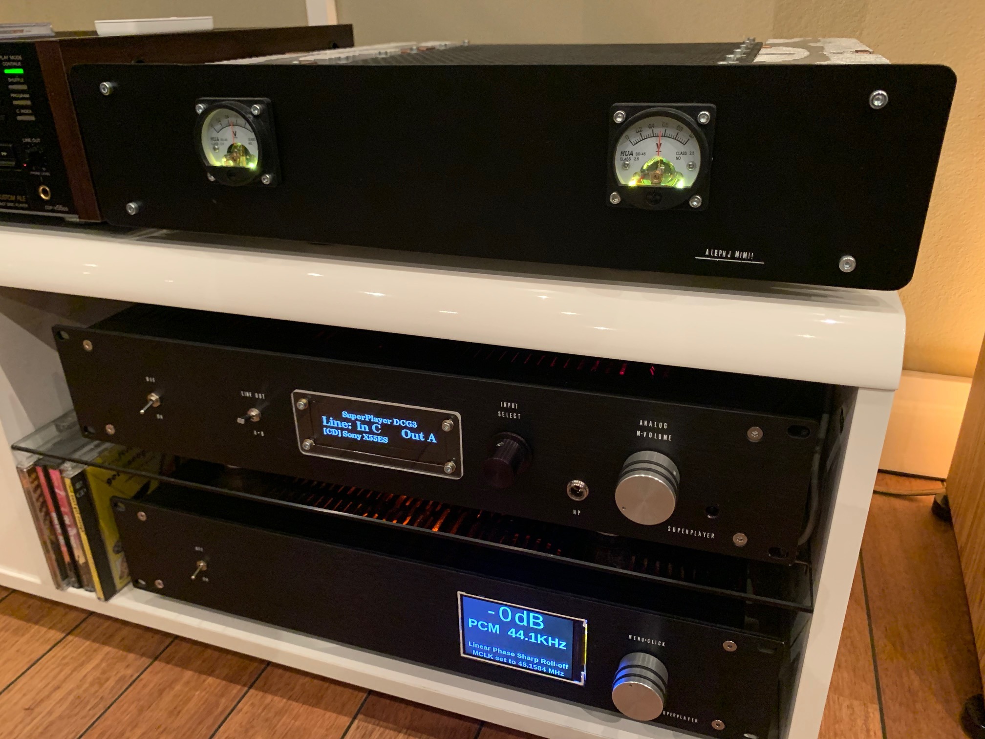

Salas DCG3, protobuild build with help from Salas on non original homedrawn pcb's in 2016.

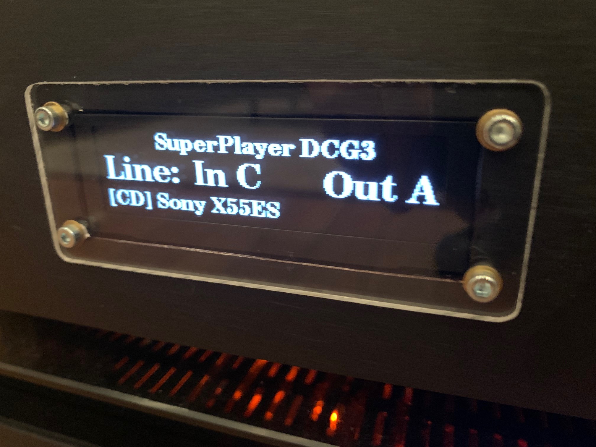

Rebuild into another chassis lately, with remote ESP32 controlled stuff.
A nice OLED... to add noise .. No just nice to have!

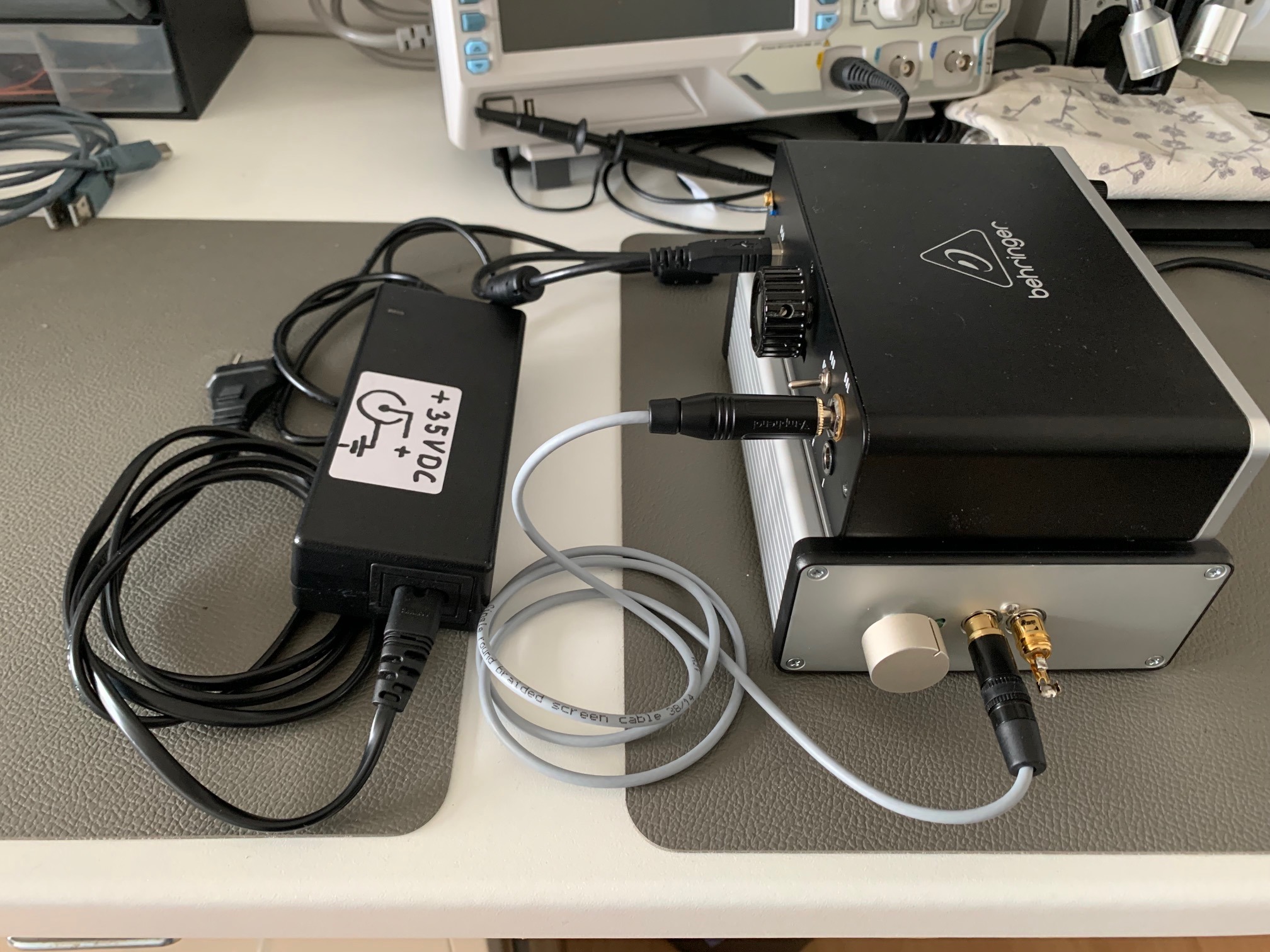

So having it all setup, looking like this ::
Modded Behringer & Victor's osc..
So i did some measurement's on my DCG3...
There are allway's things to improve, but i'am satisfied with it as is. - No hum, no nothing at full volume with my +91dB spk.

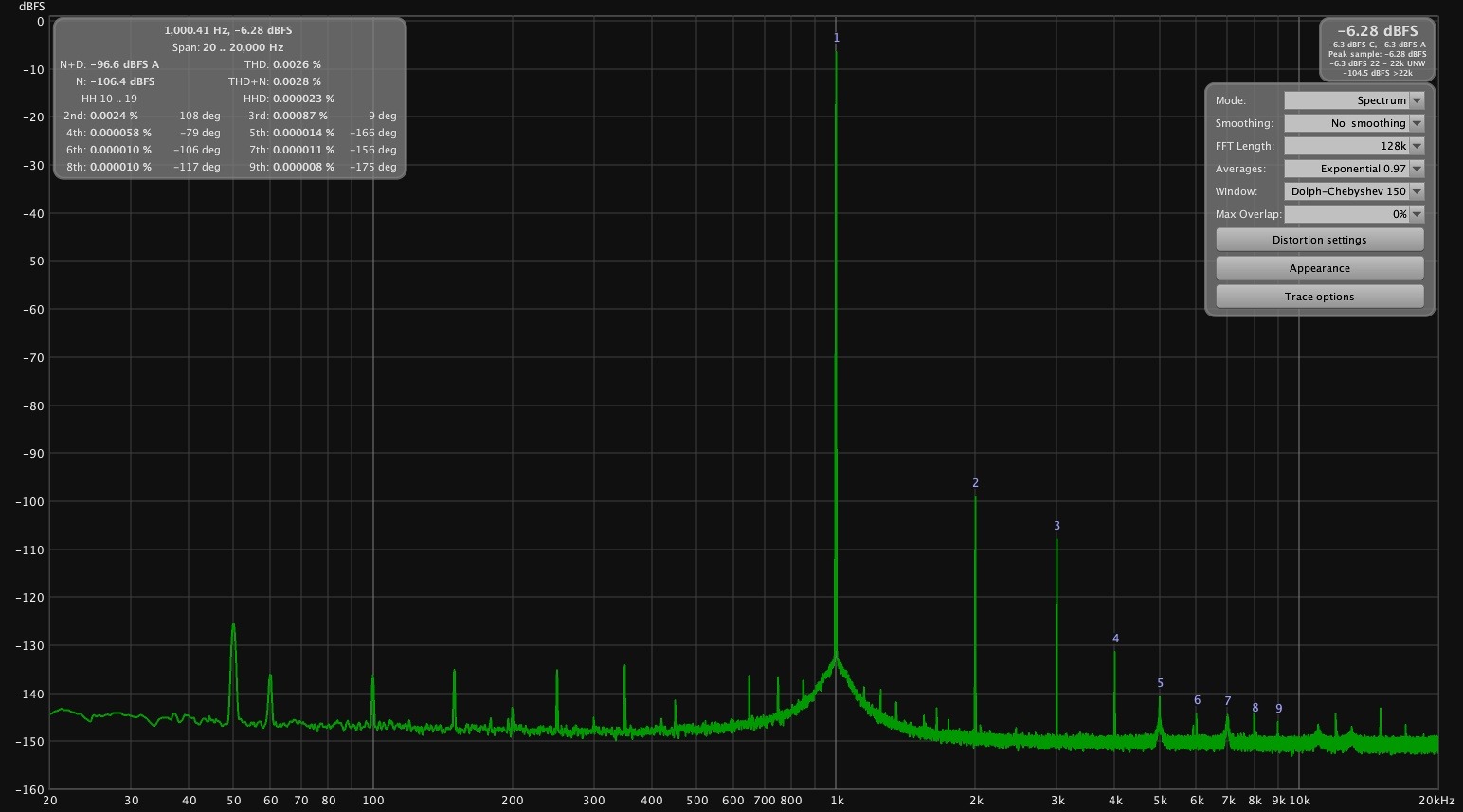

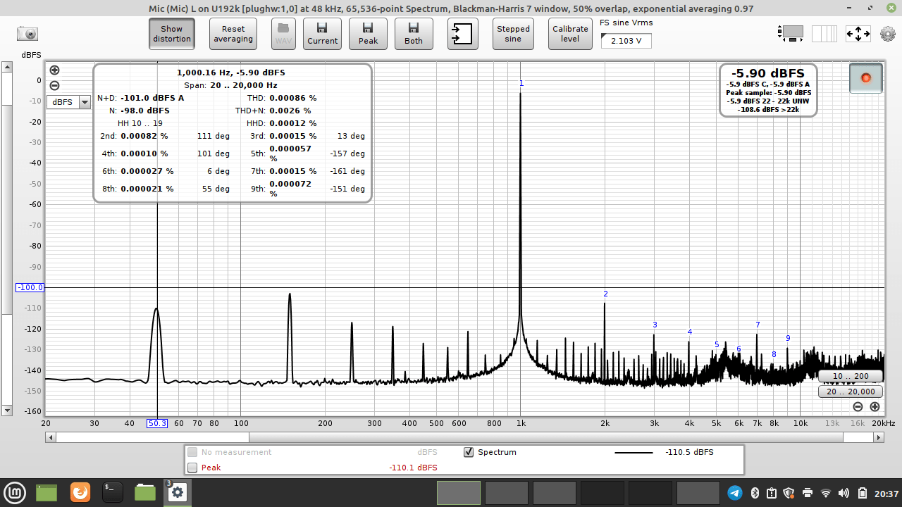

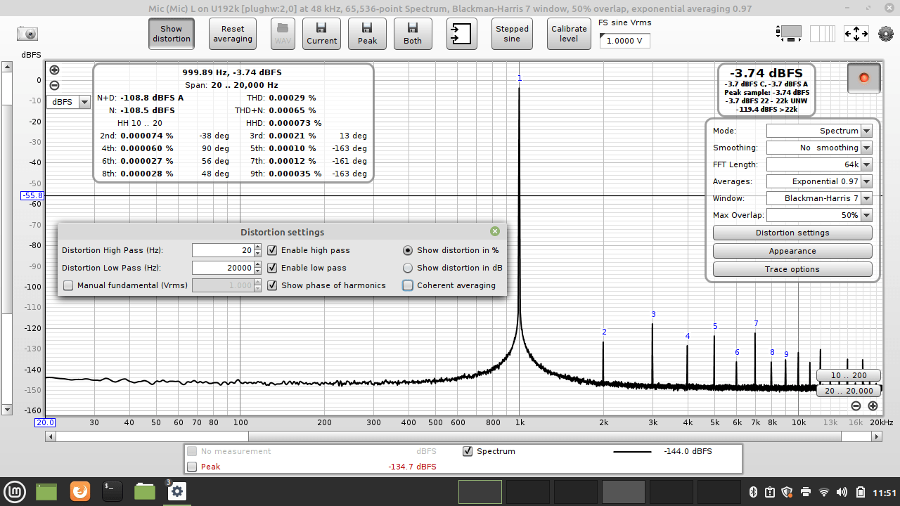

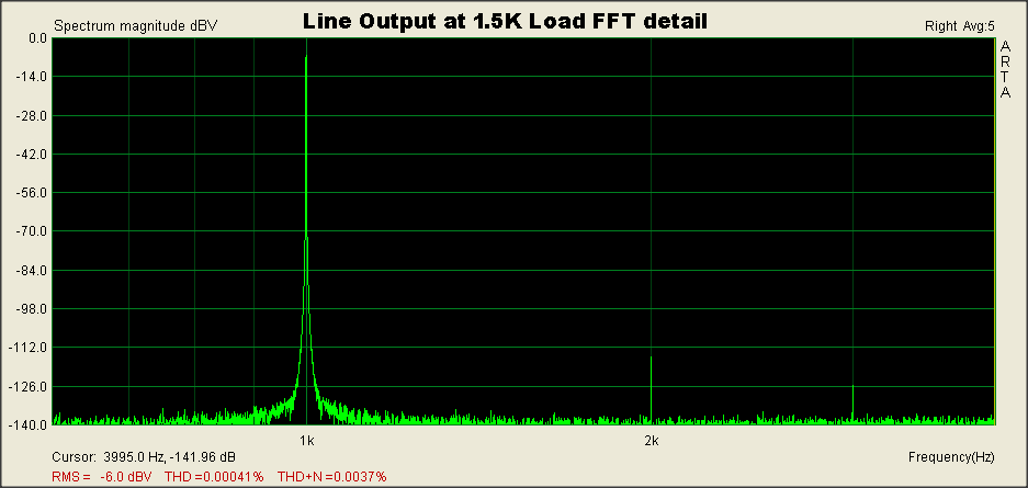

I attached a FFT shot i took today at -6dB as Salas reference from first page of this thread.
Salas's looking better, but we are talking noise, and stuff below 100-110dB.
I'am sure the mains hum which are reaching ~110dB are proberly the enviroment it is in during test.
But the Behringer is now very prone to noise, i can even have the laptop psu in the mains outlet, without any noticable things on FFT.
The THD number's are near Salas's numbers so i think it's good, and the noisefloor of the Behringer must be way "under" the DCG3 (~150dB)

Congratulations for your FFT gear efforts. You have additional electronics inside the preamp that probably radiate some. But your harmonic spikes are still below audible and your THD+N number is still very good. Shows your measurement gear is very quiet. Not adding enough own noise.

Ohh correct i did that also.Jesper, I forget if you did the disabling of the internal DC-DC booster. That got rid of some of the spikes.

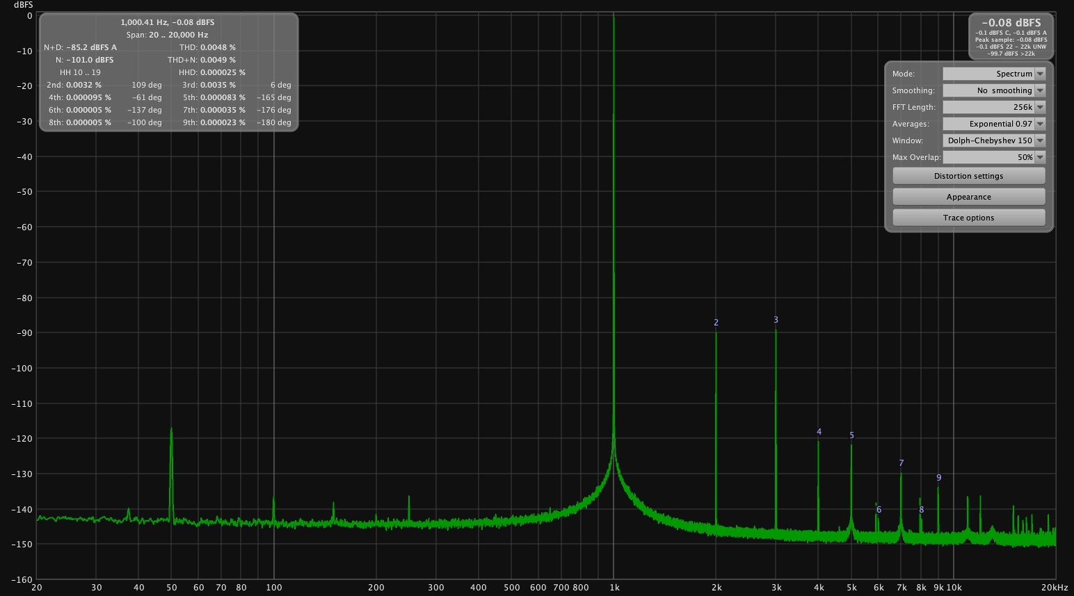

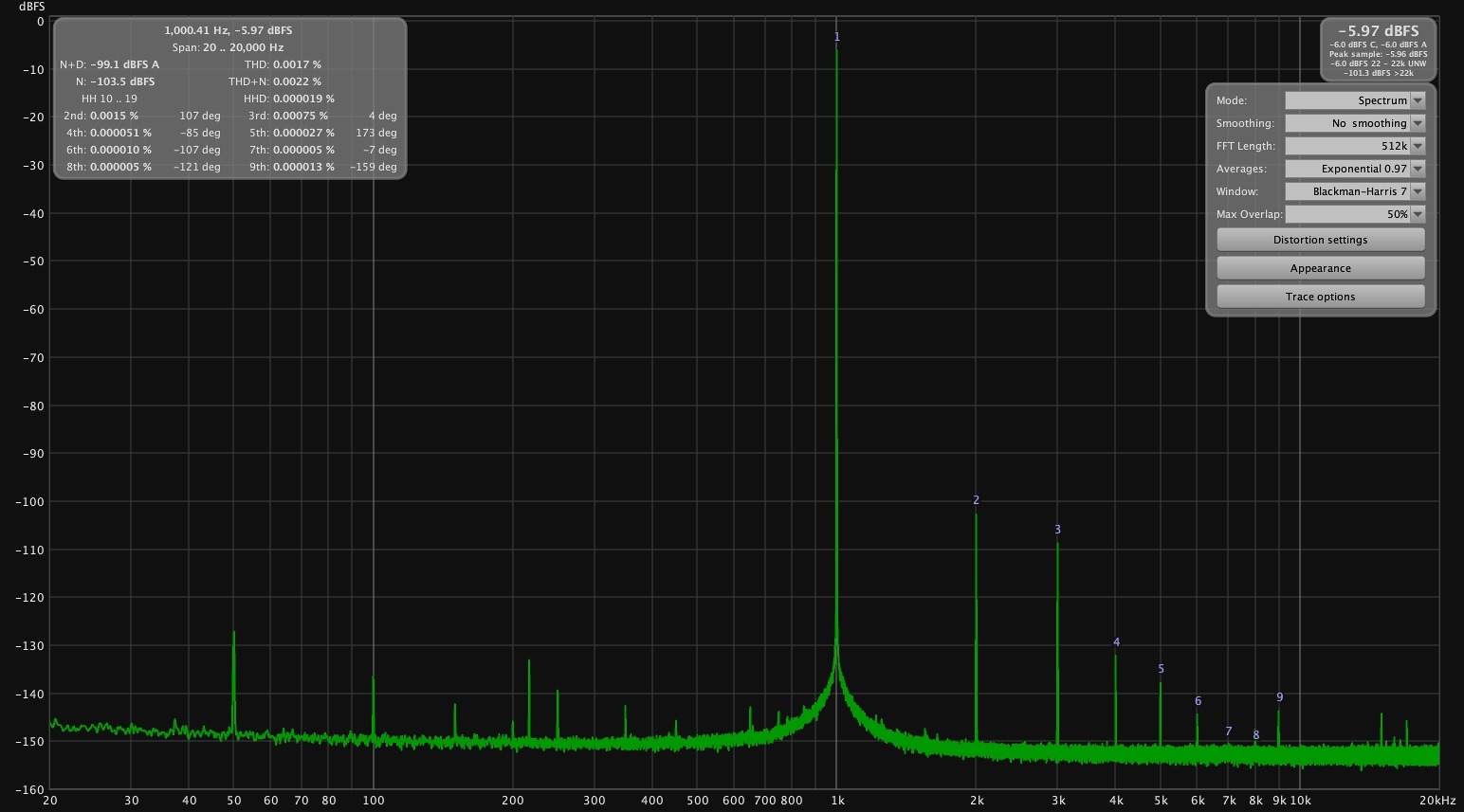

Did some more measurements. This linestage is very sensitive to internal signal cabling. Got some spike every 100hz from the former measurement. By turing/moving on signal_in coax cable these almost disappeared.
BTW: I am not sure how much of the harmonics is caused by the dac/adc in the measurement setup. Probably quite alot. A decent oscillator is by far the best to use but I think this is good results anyway. This is at 0dbFS.
This is a very clean result for harmonic noise. I can't right away tell you if the THD numbers are spot on vs my prototype because I need to know what is your card's zero dBFS input level in VRMS first. What is it?
Regarding higher order small harmonic spikes they usually crop up from DAC and ADC above about 400mV RMS in such audio interfaces. Without averaging they tend to just lurk in the grass.
You are debugging down at -130 dBFS level with single ended signal. Just looking at it the wrong way it could change behavior. How a weak magnetic field crosses a signal route is what you are probably tweaking.Did some more measurements. This linestage is very sensitive to internal signal cabling. Got some spike every 100hz from the former measurement. By turing/moving on signal_in coax cable these almost disappeared.
