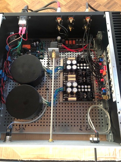

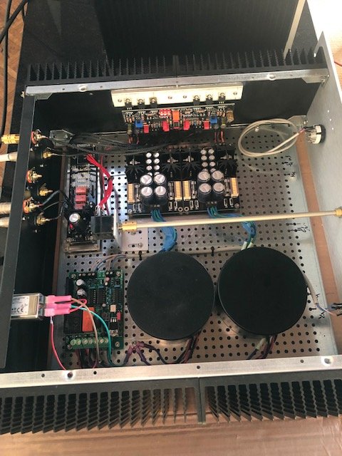

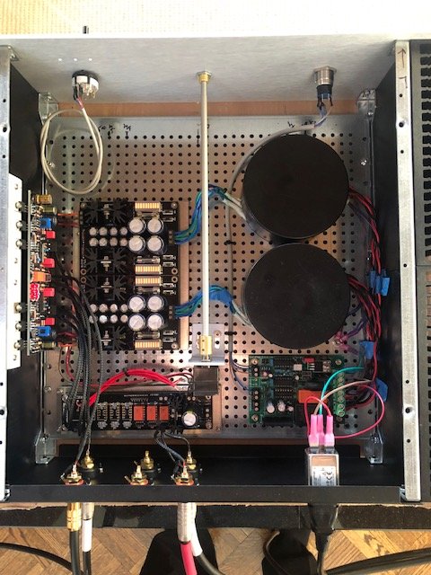

Attached are some pics of my DCG3 pre build. Been using it for almost a year now. Didn't know how good it really was until I hooked up my newly completed Monkey tower speakers and the system came alive. SP-10, Salas RIAA Phono pre, DCG3, M2X Norwood and the Monkey Towers. The sound is awesome. Thank you Salas. I never really finished the DCG3 build because I wanted to install a Muses volume control which has an ultra low noise power supply and I wanted to be able to try it with the UBiB 1.3 shunt power supply which somebody raved about with the DCG3.
I am not very good at jamming a lot of stuff in a box so I started a parallel build and am moving the trafos to a separate box to give me more room and get the AC out of the DCG3 box. I used the flexy boards for this and bypass the front section of the UBiB. Anti ringing on the Flexy. Putting a 200uF cap that I have in the C1 position. Then a big question came up. Sound wise am I better off putting the UBiB 1.3's in the trafo/ flexy box or in the DCG3 Box.
I am using 2 Pairs of Flexy boards one per Channel single ended so the power stays separated all the way through the UBiB. All set up for mono blocks.
Any thought's on this would be greatly appreciated.
I just can't get over how good the sound is.

Don hi,Then a big question came up. Sound wise am I better off putting the UBiB 1.3's in the trafo/ flexy box or in the DCG3 Box.

I am happy that you like it.
Better keep the UBiBs in the same box with the preamp board. Vout cables kept short that way is a clear benefit.
