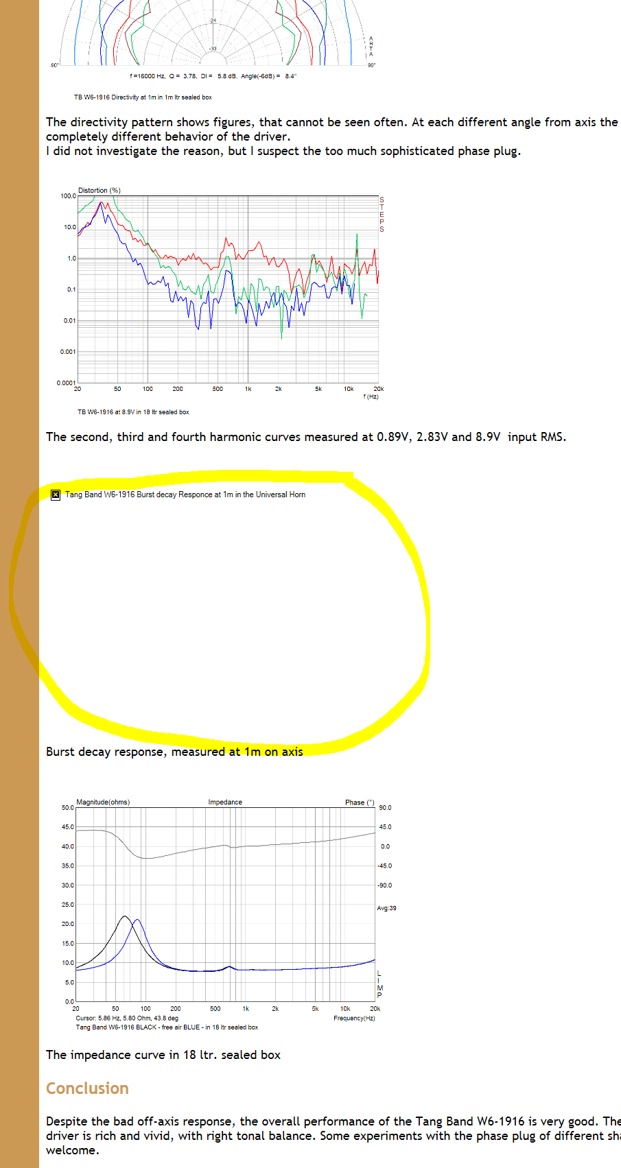

A new driver arrived for tests
Tang Band W8-1916
This driver is a bit strange.
Here you can see how its off-axis performance looks
Interesting, isn't it...?
Tang Band W8-1916
.....Interesting, isn't it...?
Indeed it is thanks sharing : )
For info at moment seems link to CSD plot is broken as can be seen in below picture.
Would be fine I think they need to send all model range to Rutcho.If TB is reading this they should consider sending Rutcho their newest generation driver of this design.
