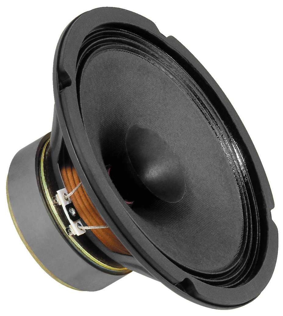

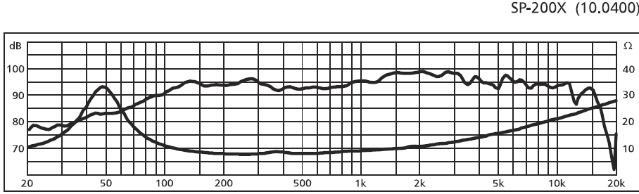

Approach could be, take a cheap 8" full range with whizzer, perform a technique to increase rigidness of the whizzer, measure if off axis response has improved.
Possible test bed: Visaton BG20
..........Approach could be, take a cheap 8" full range with whizzer, perform a technique to increase rigidness of the whizzer, measure if off axis response has improved.
Possible test bed: Visaton BG20.
Alternative Monacor SP-200X though cost/Xmax points to BG20.
