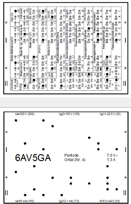

Ok so this testcard I made doesn't seem to be right, I read the manual and checked all the pins and it did make sense and I honestly thought it would work.
However after heating up a tube for a short time some smoke came from the tester, I quickly removed the tube and re-did the card and tried again with same result.
Maybe someone can tell me what's the flaw in this test card? Hope I didn't really destroy anything in the tester... seems to still work though.
There was for some reason no connection made for grid No. 1 (No plug)! Should have been plug 44/I. Which version of my software were you using, I want to try to reproduce that, the latest snapshot sets the connection for G1 properly.
Therefore, when heated up the tube may have drawn way to much plate current (because of Ug1=0V) and overloaded the supplies by that. Since that are tube regulators, the damage to them should be limited, but maybe some of the (unfortunately) custom shunts are damaged. I recommend to check that.
I'm sorry for that unfortunate outcome, but I thank you a lot for taking the risk of alphatesting.
Yes I don't know what happened, I was sure I had it set right but having a 2nd look it now works just fine!
I think I was just so busy checking that everything that was there was configured right that I forgot to check for what was missing :D

Cerker, I don't think your software did anything wrong, I might have just not clicked it properly when I was using the scroll menu, sometimes scroll menus are like that. Alternatively, could it reset itself if you change the other items later? It was the first one, the one with the save picture error.
That can happen if you change the tube socket after doing some settings. When a special connection is not available at this socket, it will get reset. Nothing should happen if you "fill out the form" from top to bottom.
But your incident showed to me that I should think of implementing some sort of sanity checking, e.G. if all grids are connected and warn the user if thats not the case. I will keep that in mind for later versions.

I just did an attempt to fix that problem, now there are 2 additional pin functions available:
Heater(+) & Cathode
Heater(-) & Cathode
NEVER assign both of them, that will short circuit the transformer!
The next alpha release will have some sanity checking, which forbids to do that. But at first you can check with a few cards if it works basically correct.
