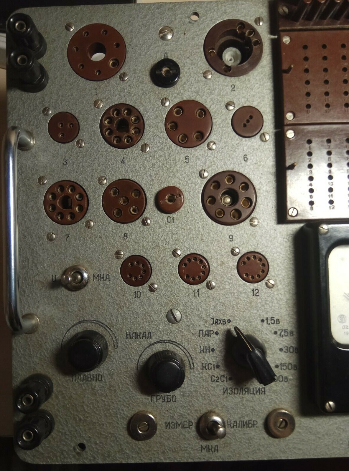

Another thing--My L1-3 seems to have voltmeter and micro-ammeter built in using the main meter, with external jack sockets and a switch between V/uA The range is on the 'Insulation' rotary switch, going from 1.5v to 500v in steps.
Ive no idea how to access that function though....
(sorry about cruddy pic, this pic is from seller and before I cleaned it.)
What you have there is likely an "MILU-1".
Found this reference right now, but they don't know much about the specialities yet: https://www.radiomuseum.org/r/frunze_milu_1il_1.html
I, unfortunately, don't know anything about it, either. But there is one plug, the 28/II which is officially not used, but on the L1-3 and L3-3 I encountered it DOES connect for socket wiring purposes (Line F to G1, IIRC). Maybe they used it differently on the MILU-1.
It being near to the current range setting may imply that it was once used to connect the meter to this special ranges and they later repurposed it.
So use my software with care and check this out maybe.

Left down corner are 2 connections B + and -, I think these and the switch 1.5V to 300V can be used as a voltmeter.
I think from MILU-1 to L3-3 was a continuous production, of course with some modification, improvements. MILU-1 from 1961 till 1970, then L1-3 then L3-3.
http://www.rw6ase.narod.ru/index1/pribor/izmiritel/milu1.html
