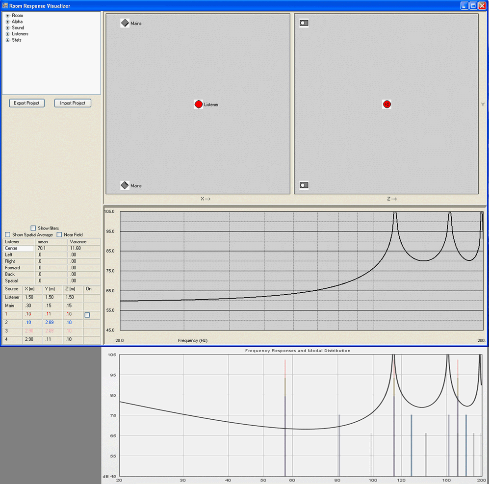

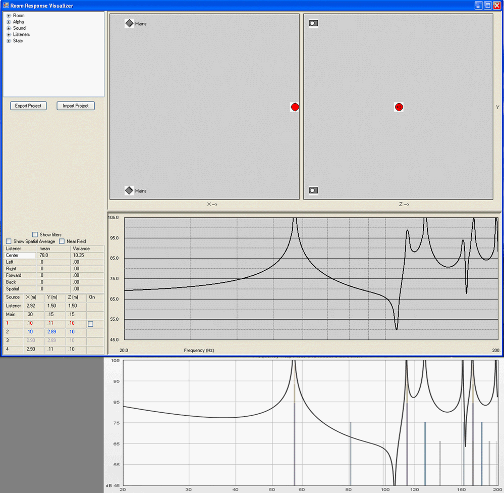

I grabbed some screen captures to illustrate the +12dB/oct slope difference I am seeing.
Room = 3m x 3m x 3m
Sources = 2 full range(f3=5hz, Q=0.7) placed 0.3m from front wall, 0.15m from floor and side ealls
Filters = no filters, crossovers, EQ, etc...
Attachment #1: Listener placed in the exact center of the room. (REW response at bottom)
Attachment #2: Listener placed in the exact center of the rear wall. (REW response at bottom)
It appears to me that REW does include "room gain", although it would be a minor player when larger(typical) room dimensions are used.
REW is using a zero or DC mode. This is not possible in any room that is not perfectly sealed. People would die in such a room. When the room is not sealed then this mode moves away from DC, a sort of Helmholtz resonance to the outside, but it tends to be very lossy and hence there is little to no rise.
Having worked in automotive audio at Ford for 20 years I assure you that I have measured more cars than you. It is rare to see this mode significant in any large vehicle. And none of them are "flat" from a single closed box sub at 50 Hz. You are just making that up.
I exclude the zero mode because it is numerically a problem and it is unrealistic. It is an easy matter to add it back in so that my results would match REW, but that would make no sense since I think that REW is wrong.
