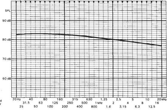

Did you read the Harman paper "Listener Preferences for In-Room Loudspeaker and Headphone Target Responses" (AES Convention Paper 8994)? The preferred curve looks like this:
Quite a departure from the B&K curve.
Markus, yes I have seen that. Have you seen Sean's report on Audio Musings by Sean Olive: The Subjective and Objective Evaluation of Room Correction Products Have a look at Slide 24 in the presentation referenced in Sean's post. The noted preference is 0 dB at 20 Hz and straight line to -10 dB at 20 kHz, which is a bit different than what you have posted above.
I did use Sean's target (the one I linked to) for about a year with another DRC product, but it did not sound right to me. It had the sonic characteristic of sitting midway or towards the back of hall seating as opposed to being seated in row 5. Not that there is anything wrong with either
Also, relative to neutral, the bass sounded too forward, but I am looking for a neutral or transparent reproduction. Again, not to say that there is anything wrong with having a spectral balance that is more bass tilted. Personal preference perhaps, and/or different corrections based upon different psychoacoustic analysis algorithms.
However, I would say these 4 referenced targets are very similar, all with a -6 to -10 dB point at 20 kHz and flat to a certain hinge point, and that's where the point of departure is for each one. But they are all within +- 5 dB (or less) of each other. One can easily make corrections for each target and in real-time in JRiver's Convolution engine A/B the corrections. A personal preference can quickly be determined.

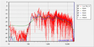

Even so, it still doesn't look right

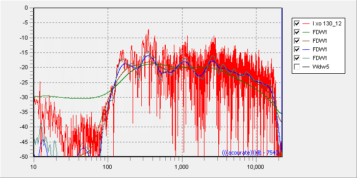

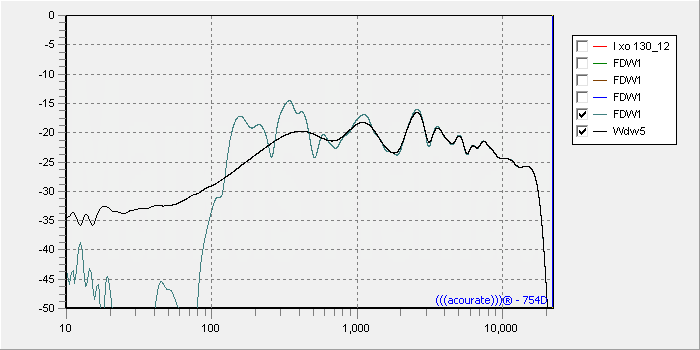

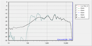

Some more graphs. Once more this is the long window response overlayed with all the frequency dependent windows from 1 to 8 cycles:
Here's a fixed 3ms window vs. frequency dependent window with 8 cycles:
