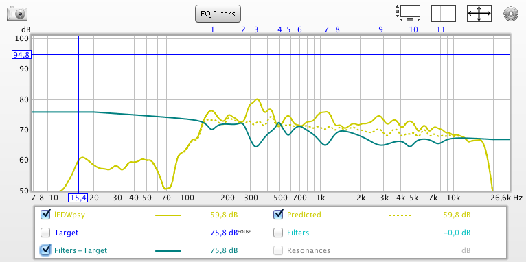

Thanks. REW does similar:

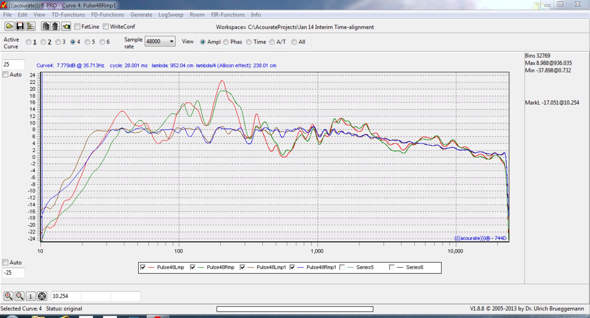

Here is a quick example of Acourate digital room correction of the before and after at the listening position of my old school Cornwall type clones with CD horns. The after is +- 2dB from 32 Hz to 1 kHz and +-1 to 1/2dB from 1 kHz to beyond 20 kHz within the target response.
Finite Impulse Response (FIR) filters provide corrections both in the frequency and time domain (excess phase). And at 65,536 filter tap length and 64 bit processing on a computer offers a level of performance/resolution that most people may not have heard before... regardless of listening position. It is a real ear opener.
PS. If you go the full nine yards with Acourate's digital XO, time align the drivers, linearize each individual driver, and then apply room correction, one will be rewarded with the smoothest frequency response, excellent step response, and imaging that really makes the speakers disappear.

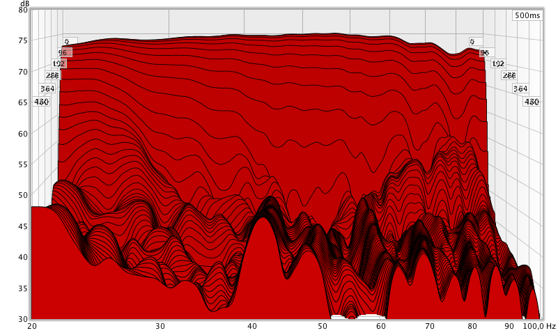

Yes, CABS or DBA can deliver great results. Here's another example: Double Bass Array (DBA) - The modern bass concept!
I've also had great results with direct field listening by placing subs very close to the ear (about 1 ft.):
(The stuff <45Hz is mostly noise floor only)
