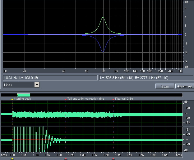

Example, a modal peak of 6dBat 80Hz with a Q of 7. To correct it a filter with 6dB dip at 80Hz and Q of 7 is used.
How long does the correction filter need to be? Filter is IIR, but in practice may readily be truncated. In a world of 24bit sound systems, truncation to point in time from start of filter peak where level has decayed into noise floor of dithered 24bit system is good start. Filter may be shortened further with marginal loss of performance, for this example a 32bit filter is generated and converted to 24bit with dither to get approximate length for application.

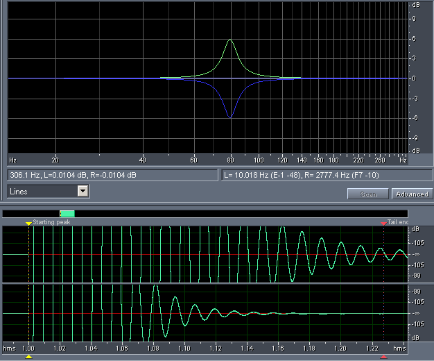

Waveform of PEQ filters start with peak and have ringing tail corresponding to magnitude and Q of filter:
Above are waveforms of filters and corresponding spectra. Filters start at 1 second. Sample rate is 48kHz.
Lower track is correction filter. It is selected from 1 second start point out 10904 samples, about 0.23sec. This is convolved with entirety of top track with following result:
Result is Dirac pulse at 1sec. Noise level is seen to increase in resulting tail.

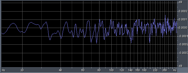

Resultant spectrum is flat to <1/1000th dB as seen here in zoomed view:

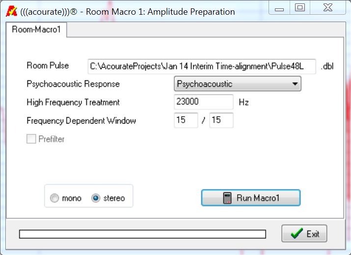

Attached is the dialog box that is applying the variable frequency domain windowing to calculate the psychoacoustic frequency response. Another dialog box also uses FDW to correct phase response, but that is another topic for another time.
The result of which can be seen in the chart. The red trace is the non-smoothed or raw frequency response. The green trace is the psychoacoustic frequency response. Note the difference in both the low frequencies AND the high frequencies.
It is the green (psychoacoustic) response that is used to calculate the FIR filter. Note how this is different than virtually any other room measurement/correction software, except the ones using FDW. The end result also sounds very different. And to my ears, superior to anything else I have heard by a large margin.
