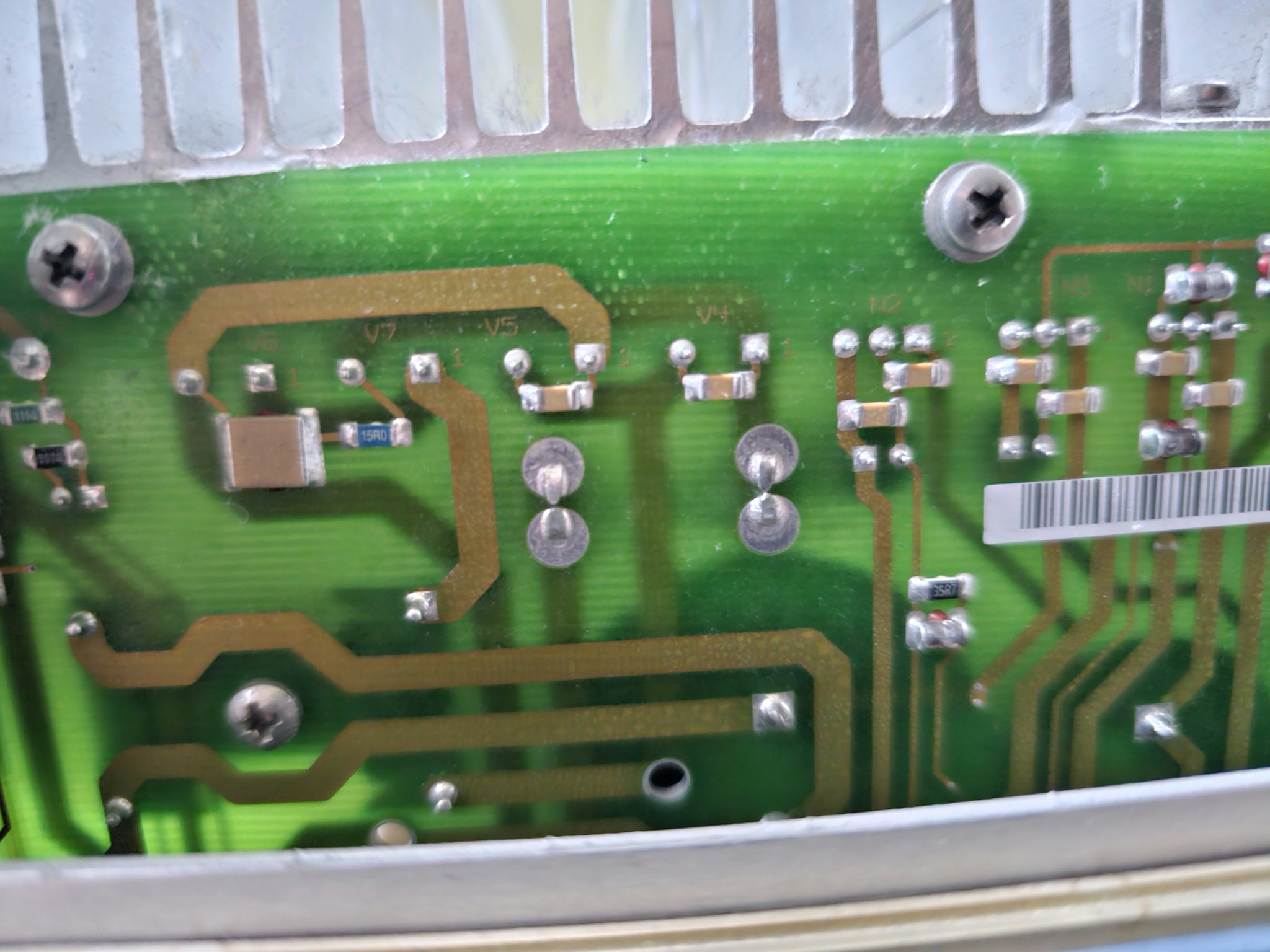

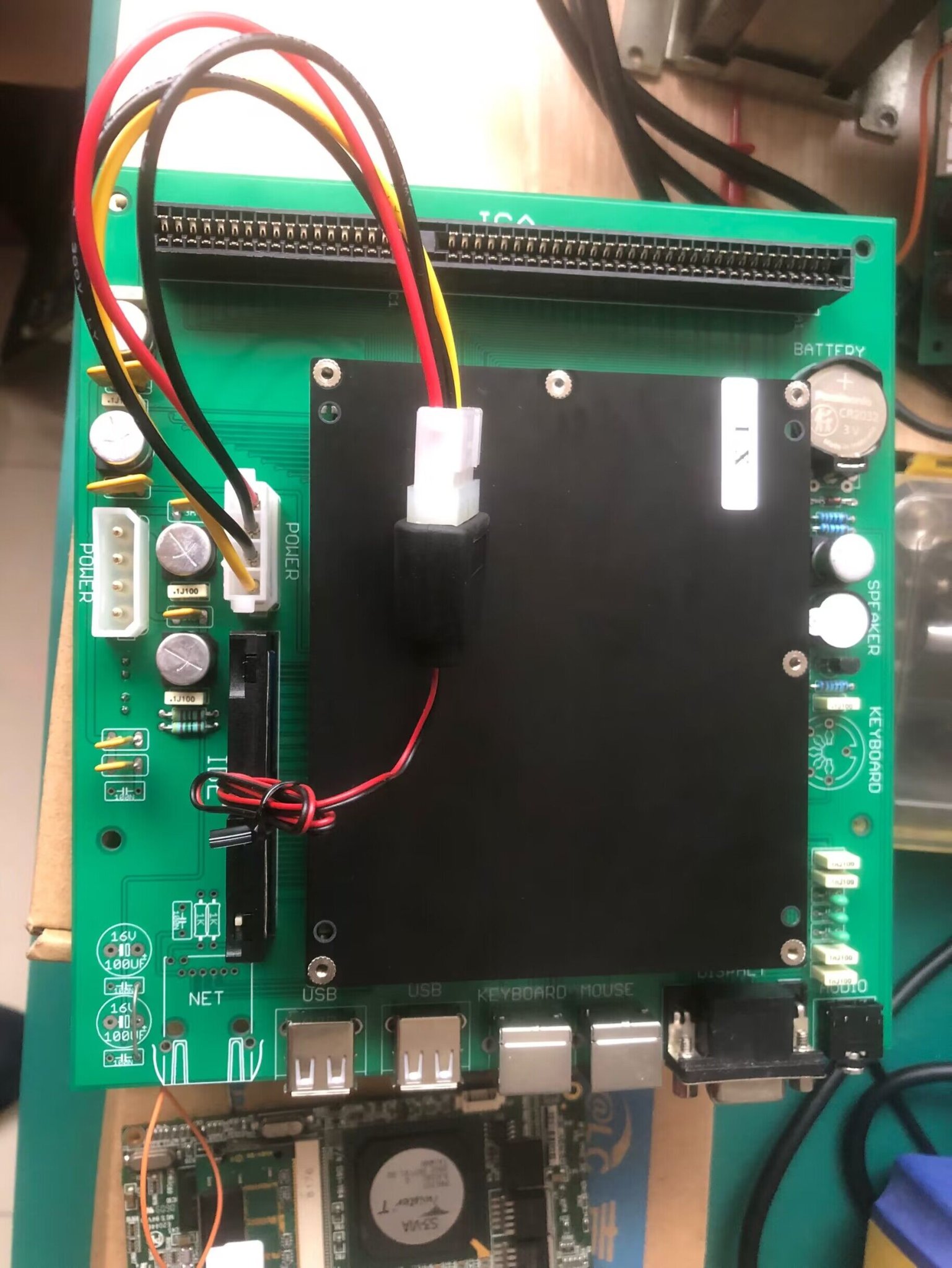

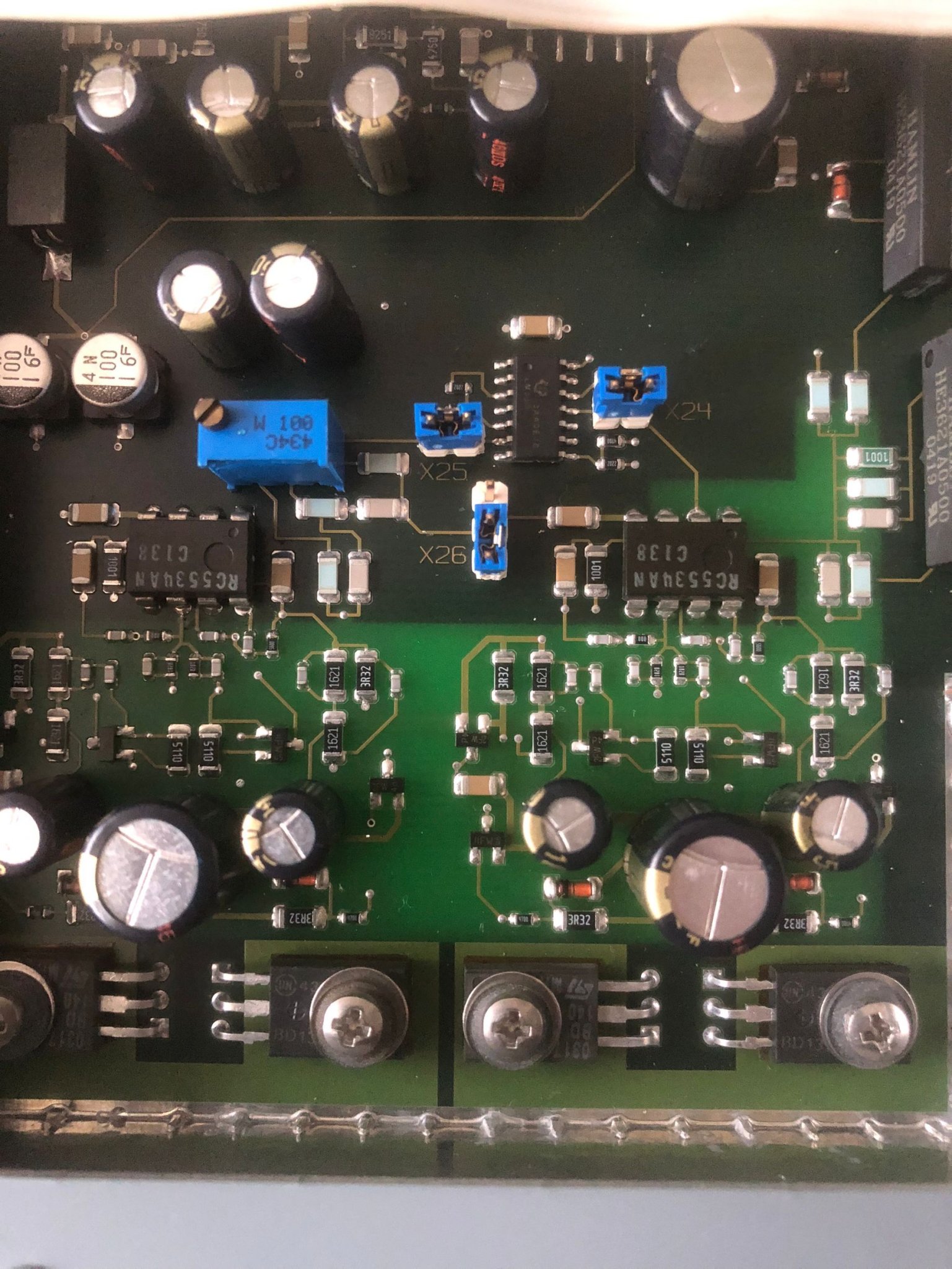

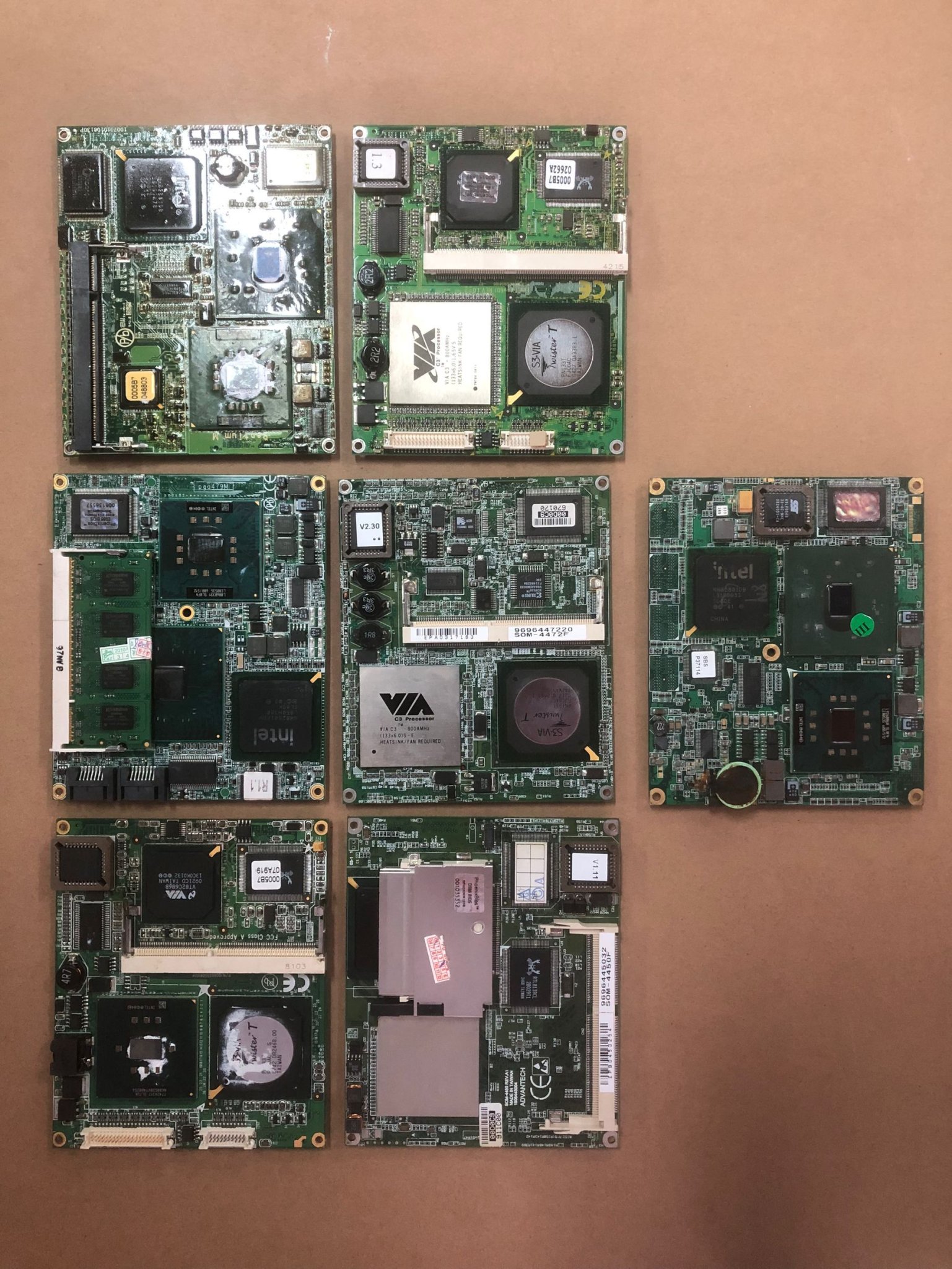

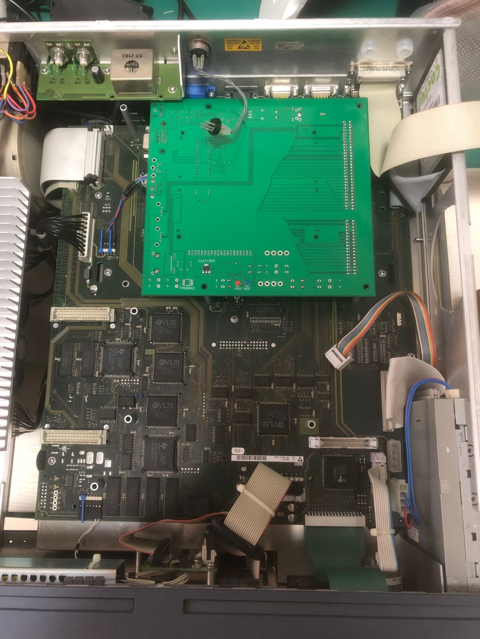

Thank you. Currently, ATOM processors cannot be used for testing, only AMD series processors can be used. The most ideal is GX1. Testing that the LX800 works. But the display is not quite the same.This test harddisk comes from a new motherboard. I am currently having a headache. The machine alternates between good and bad. OVLD often occurs during the testing process. After restarting, it cannot function properly. Always in a protected state. But the cold start is completely normal. Overload after 10 minutes of work.
The current inspection result is a jumper issue near LM339. The jumper fault has been cleared and resolved, but it is unclear how it will develop in the future. If Overload occurs again, decide to replace LM339. In addition, Kontron ETX-LX testing is used. Use the IDE DOM to test that everything except the display part is working properly.
Thank you. Currently, ATOM processors cannot be used for testing, only AMD series processors can be used. The most ideal is GX1. Testing that the LX800 works. But the display is not quite the same.This test harddisk comes from a new motherboard. I am currently having a headache. The machine alternates between good and bad. OVLD often occurs during the testing process. After restarting, it cannot function properly. Always in a protected state. But the cold start is completely normal. Overload after 10 minutes of work. View attachment 1228622

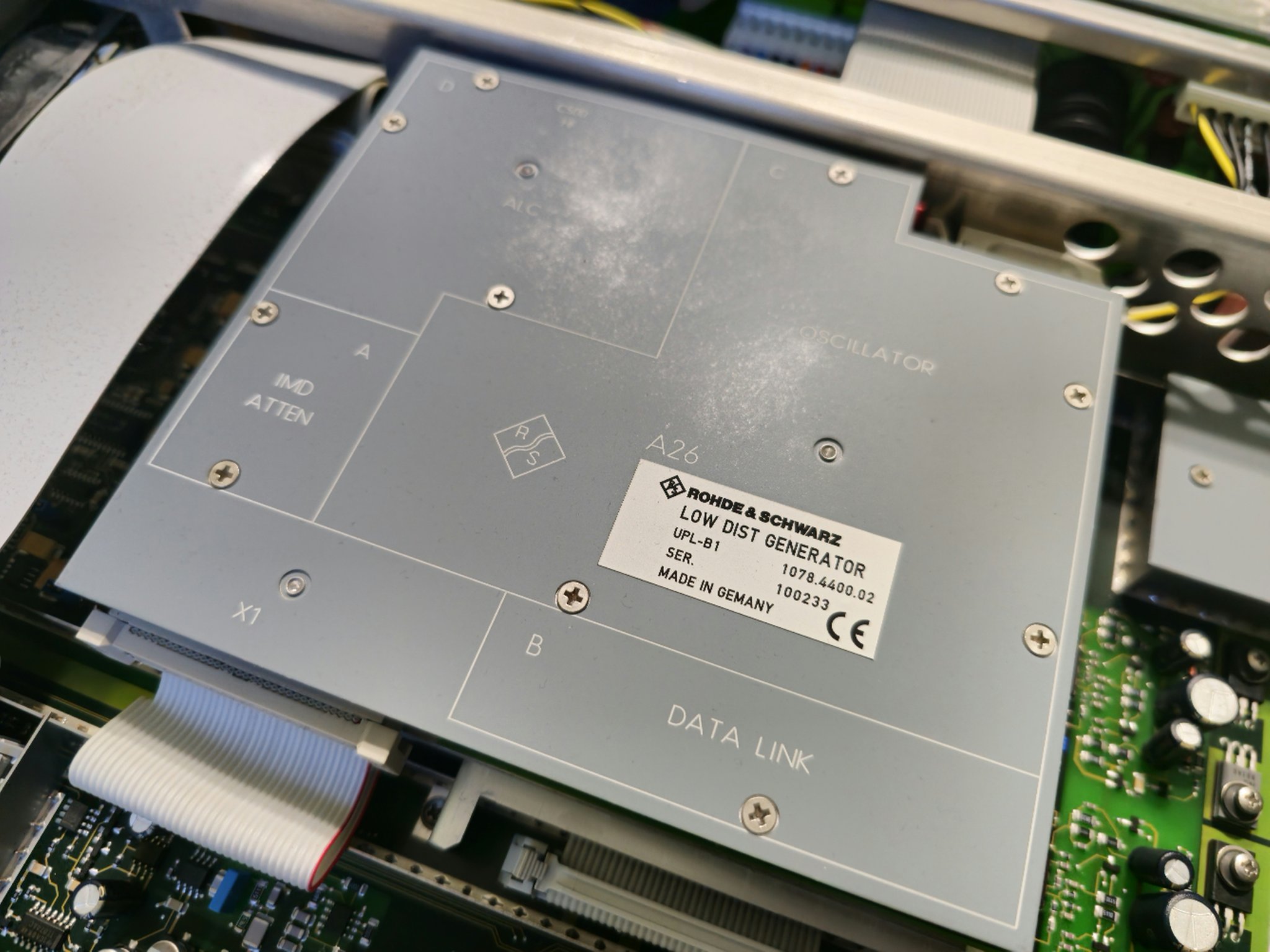

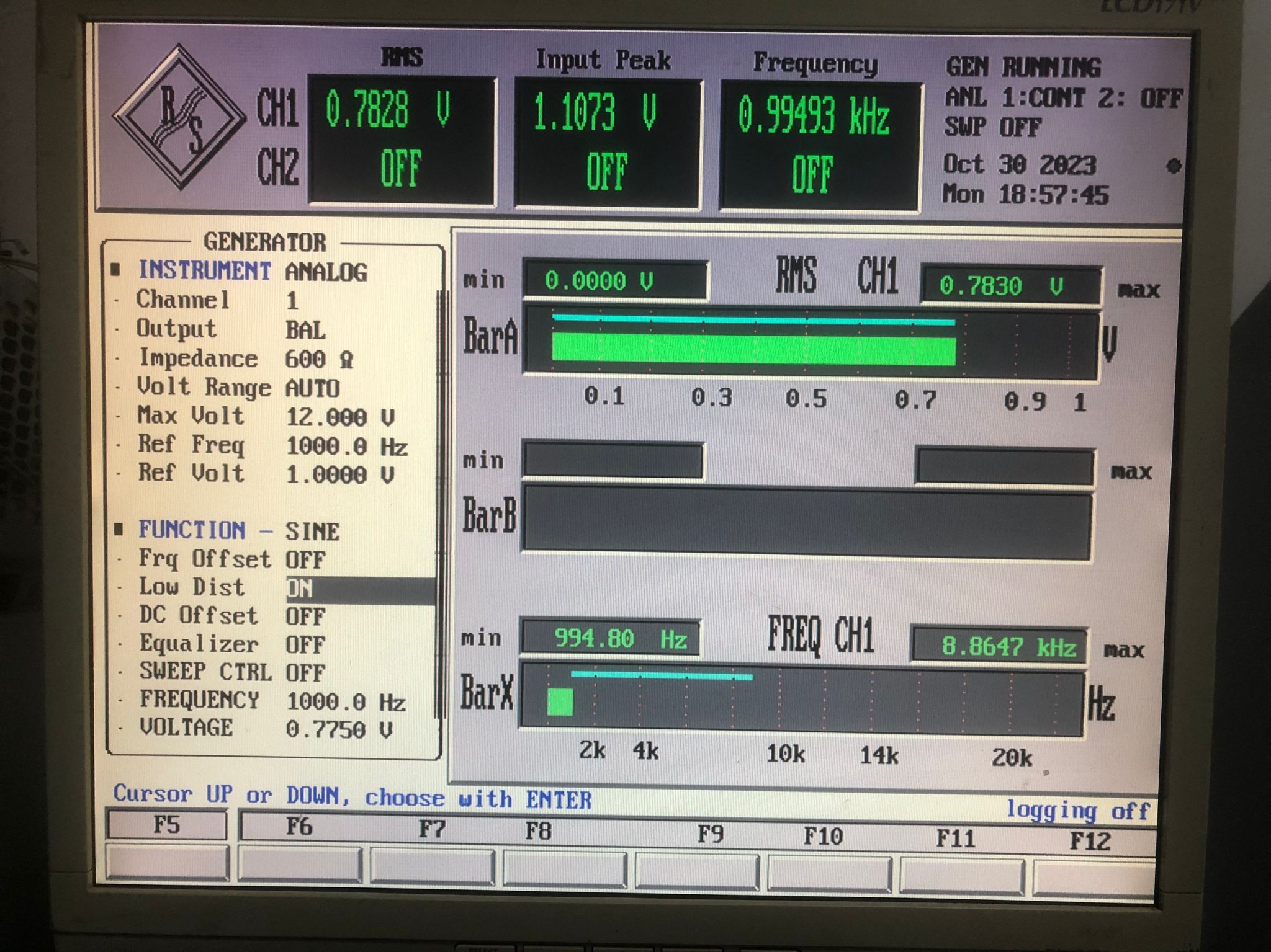

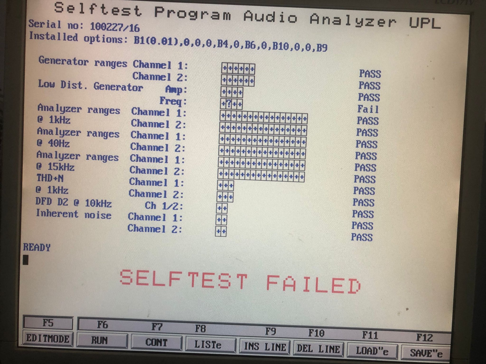

Good morning Bjirre,I need your help now. I have discovered new problems again. During the testing process, a question mark appeared on the B1 option. But it can output normally, but the frequency and voltage are not correct. May I ask where the problem lies. Additionally, I have purchased almost all ETX motherboards. Prepare to test which display is completely normal. Then I will provide timely feedback to everyone.​
Thank you also to my best friend. Alex_twn
cheers
@wyqgyn given my recent experiences with the signal path, the first thing I would check is the relay that switches between the internal gen and the low distortion gen.
You can check my recent post surrounding this topic. You can easily verify this by bridging the relay contacts. If the self-test passes 1 generator and fails the other and vice versa, you will know that the relay needs replacing.

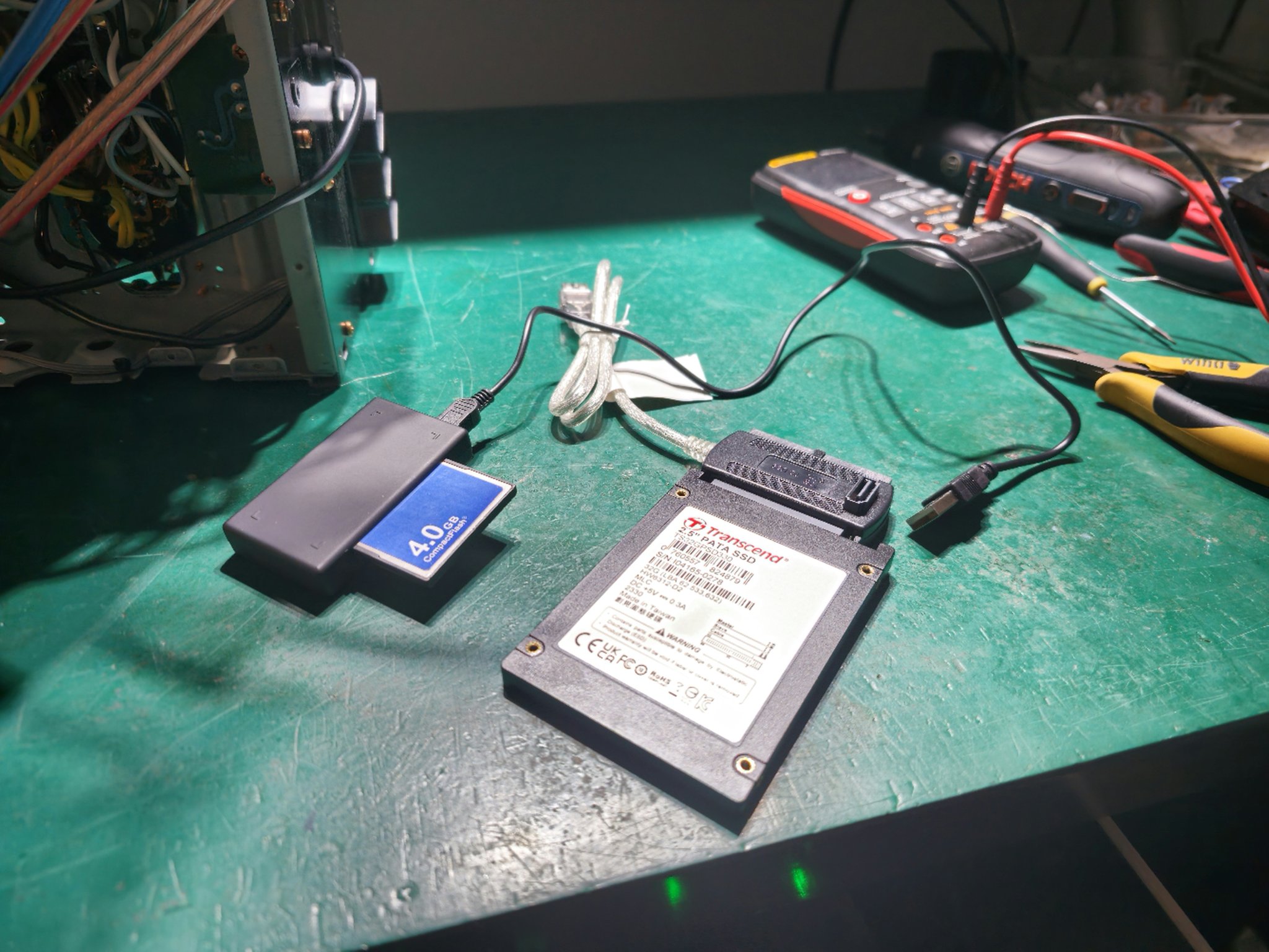

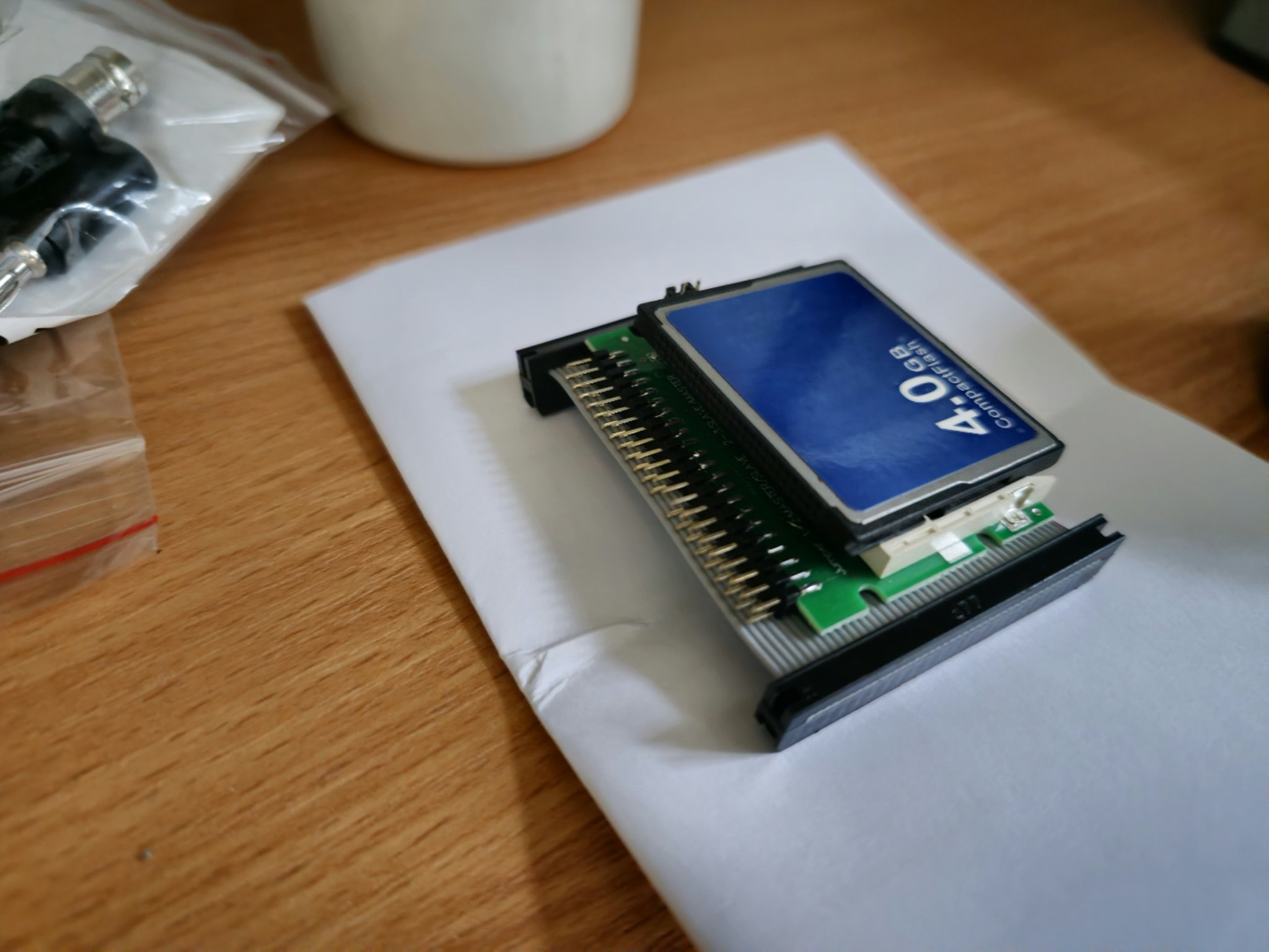

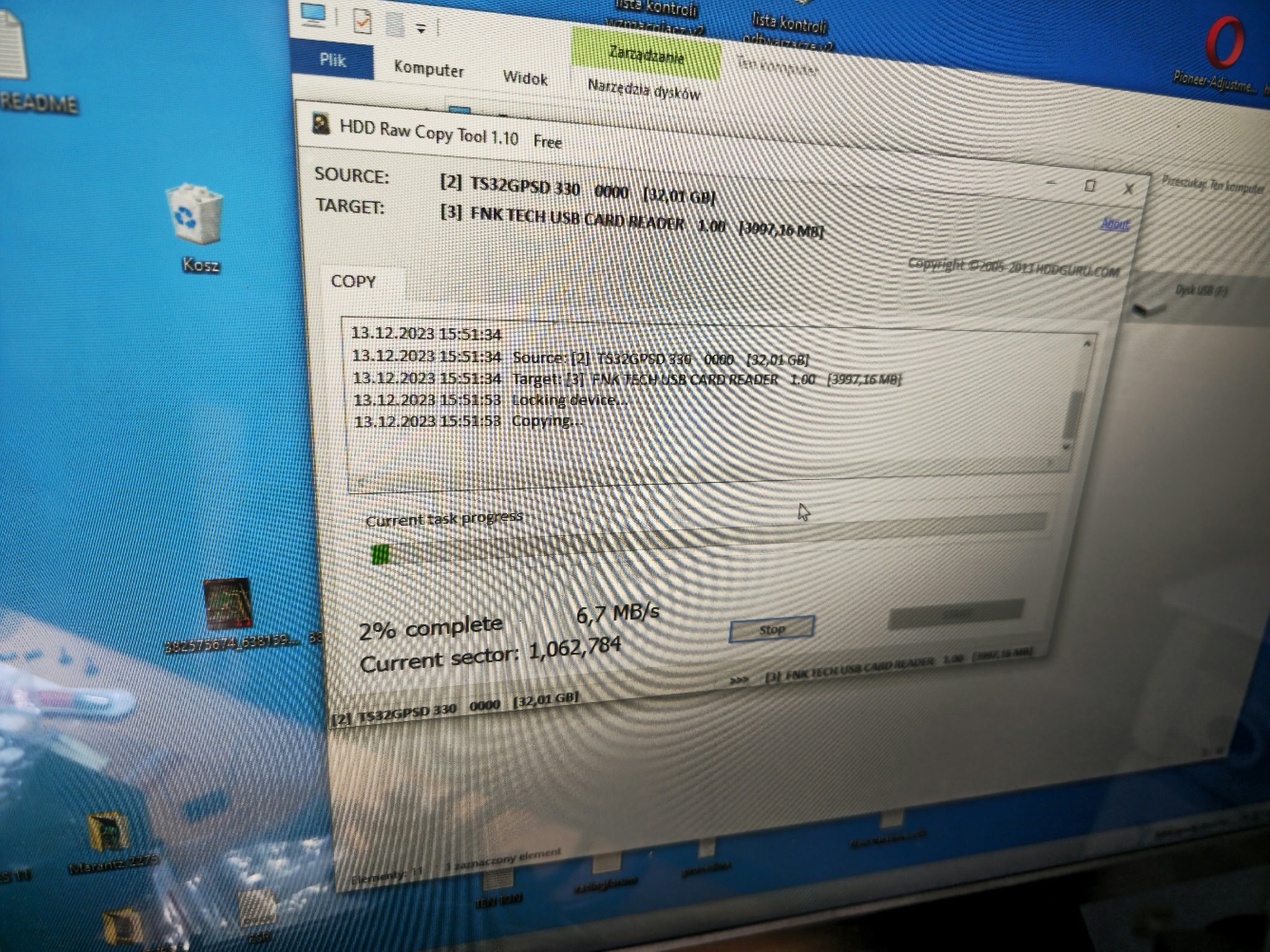

Hello i just bought the UPL from a test equipment company, they tried to change the disk for ssd but it doesnt work.
They had transcendar 64GB ssd and from what I read these discs were not working.
I ordered CF adapter and 4GB card, after I receive unit I will make disc image from this ssd to CF and hope it will work.
The original spinning disc is 20GB fujitsu from 2003 year
A good starting point is to look to your bios, does it recognise the ssd there?
Cheers, Bart

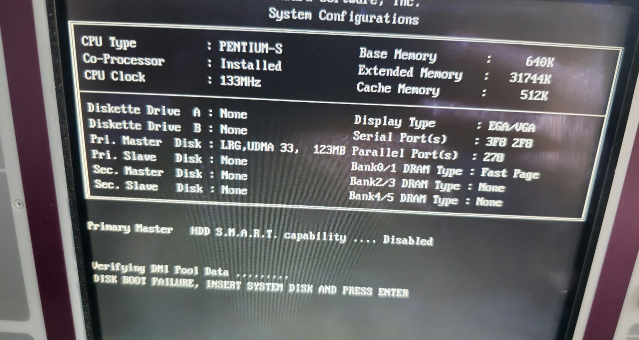

Cheers, Bart
Looks like it recognize it but As 123mb disc
I connected both discs to PC
Original hdd has 20GB and has one 2GB active partition just like the new clone SSD

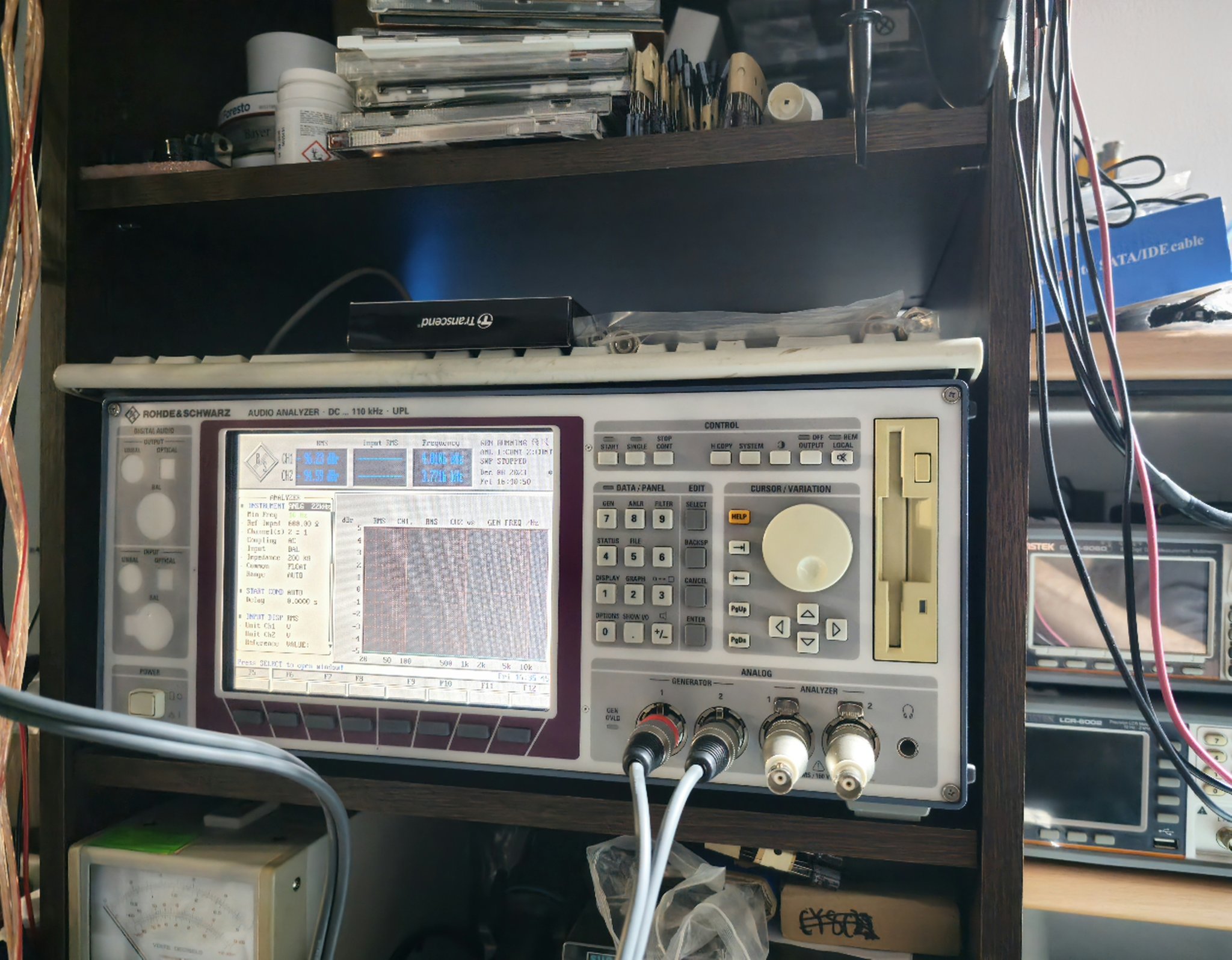

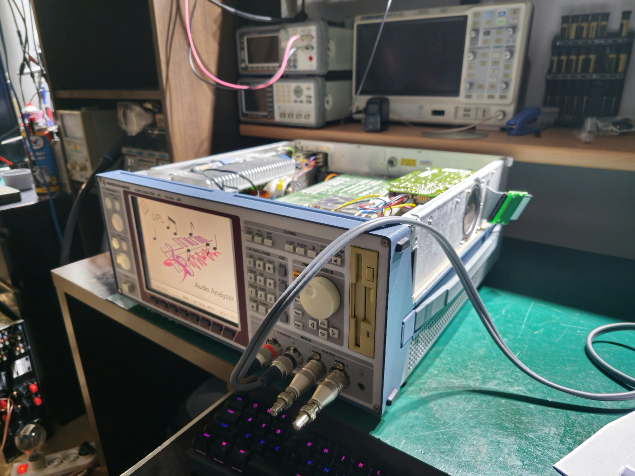

The good info is, the unit is working well and looks like it was not much used, no signs of repairs, PSU looks ok, not even a single cold solder joints at fuse socket
And it has B1 :)
It light like new with original CCFL
