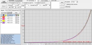

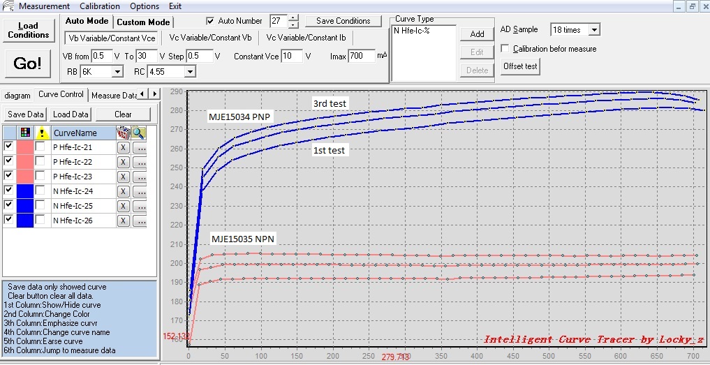

MJE15035 looks good but MJE15034 seems to be very different from my transistors, direct samples from ON Semi. Maybe you have a fake transistor?!
I did direct samples from Onsemi, however such hfe spread of mje devices seems depends on from country of origin. Chinese devices used to have such wide hfe spread, thus low quality production.
hFE is affected by Tj.
As Tj increases hFE increases.
But, I would expect similar increase for both NPN and PNP.
Your results don't show that NPN to PNP correlation.
I did another test. Yes, the hFE increase is indeed similiar. BTW, I find Locky curve tracer is a very convenience and useful DIY tool.

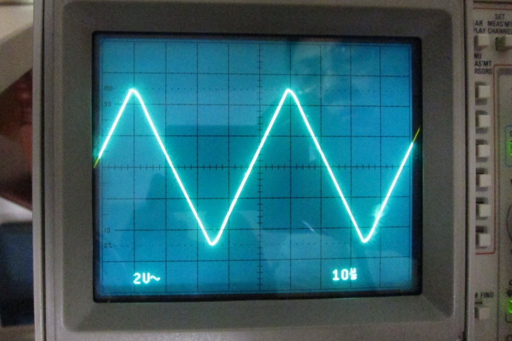

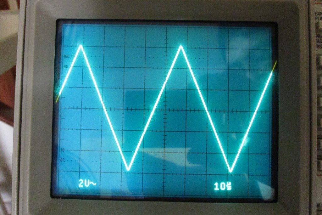

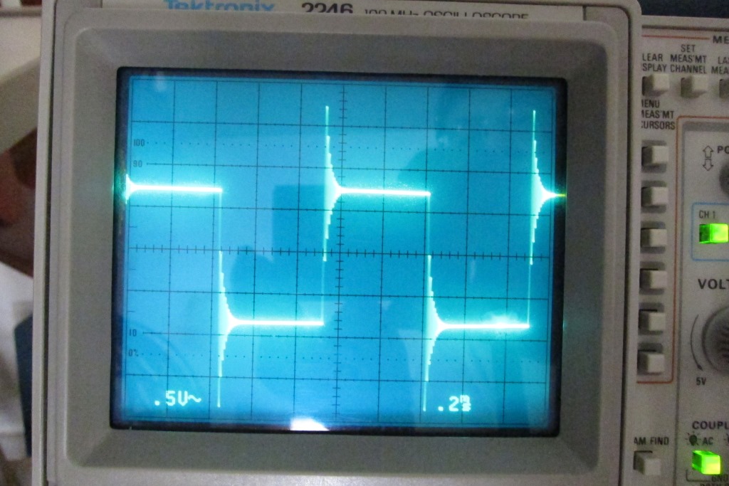

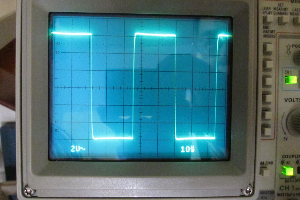

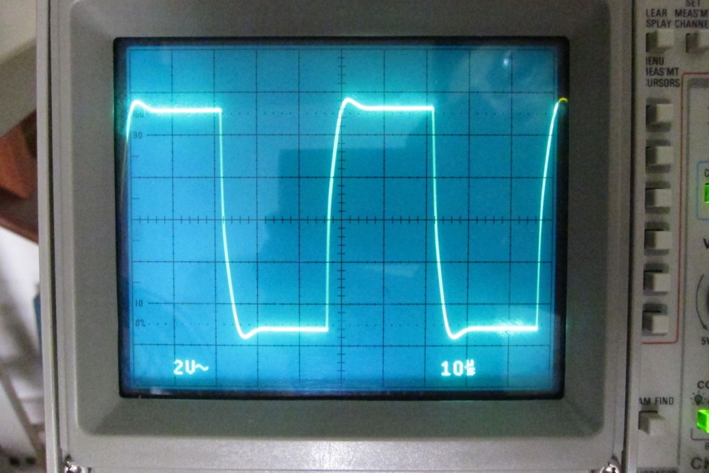

Hello, I did some testing for 8R resistor load at 20KHz. One channel is fine, another is overshoot, slower slew rate and non-linear. anyway to fine tune ? thanks for help. I haven't put in the output coil.

There is certainly a visual difference on the scope.
Is the "system" safe enough to connect a good speaker?:D:D
What does it sound like? Is that difference audible? Subtle or obvious?
Yesterday evening, I plug in my favorite Dynaudio contour 1.4 bookshelf speaker. The amp has good control over bass, smooth vocal and from time to time give me surprise. However, it is not forgiving on poor source.
As for the high, one channel is more airy, surprisingly it is belong the one with square wave overshoot :D
Thanks for that report Peter.
I had no idea whether your different channel would be audible.
You have confirmed it is audible.
That was quite a small overshoot, many are worse than this.
I explain that as over amplification of transients. This leads to an emphasis of HF that is not there in the real signal.
This may also relate to you hearing something added to poor sources.

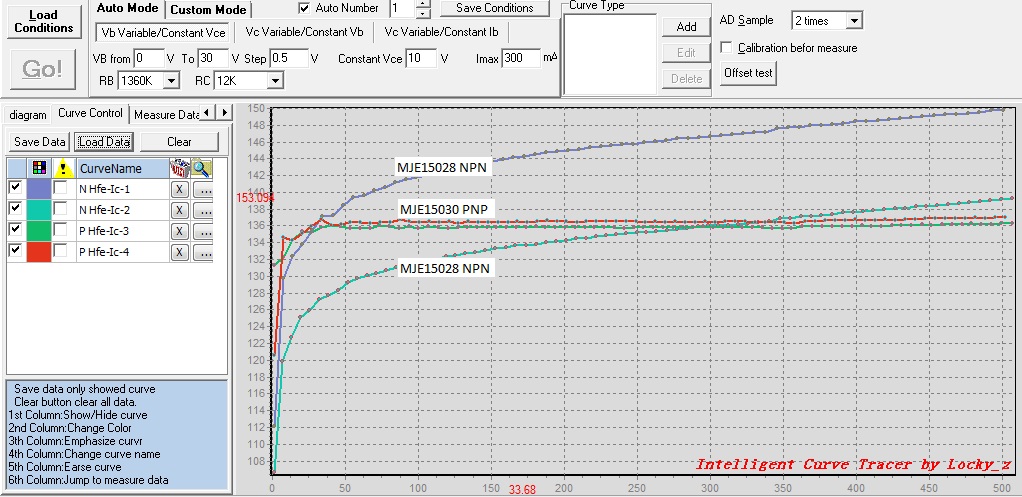

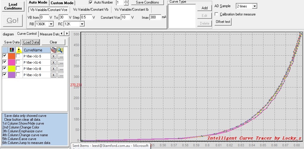

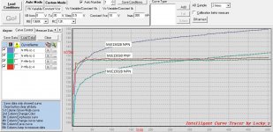

I didn't matched. But I recently purchased some transistors and managed to get two good matched pairs for MJE15028/15030. I am wondering how much beneficial to replace them?
also, if I increase the value of C8,9 15pf, will it help to trim down the overshoot?
