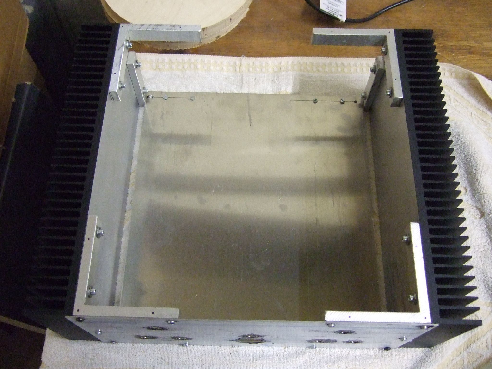

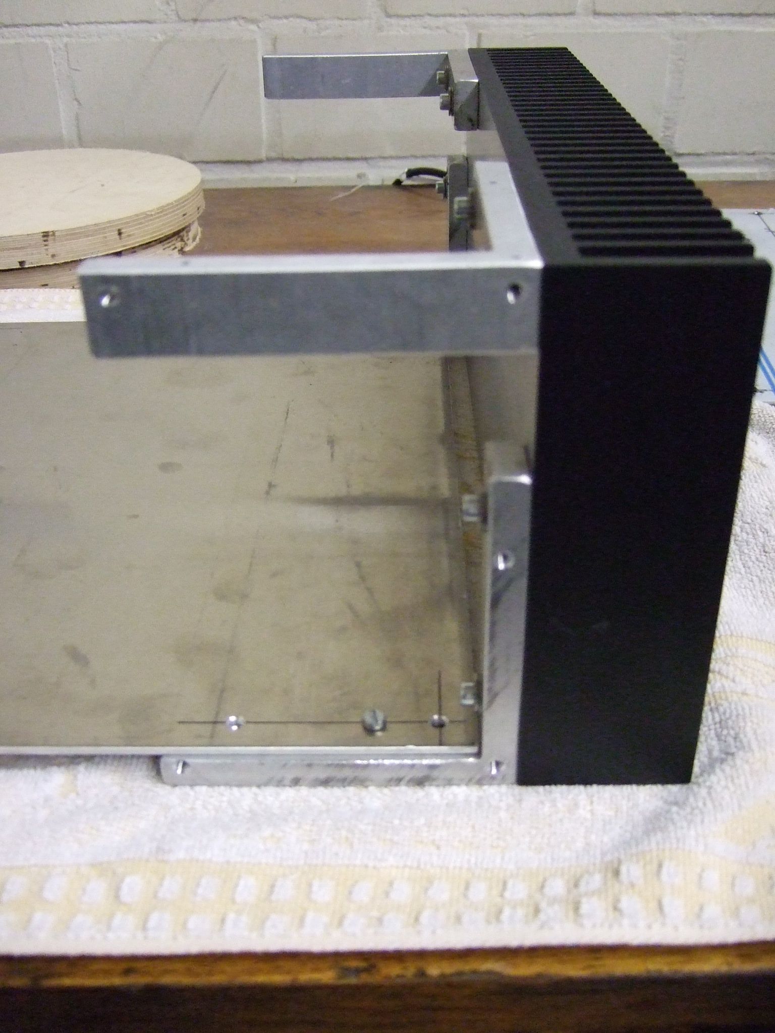

Gentlemen, if you are still wondering, how to build your FC-100 case, I want to give you an inspiration - see attached images.
This is how one of the German DIYers did it.
Start with an ALU - bottom plate (300 x 380mm, 4mm thick) and 2 ALU - side plates (150 x 380mm, 6mm thick) and buy 8 ALU brackets.
Leave a 10 mm gap between the bottom and side plates for good air ventilation.
Connect the heatsinks of your choice on the outer side of the ALU side panels.
Best regards - Rudi_Ratlos

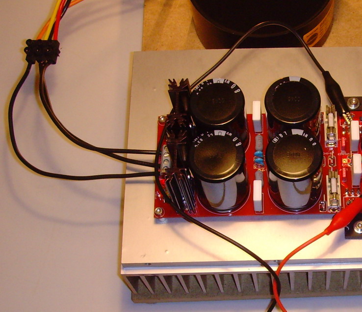

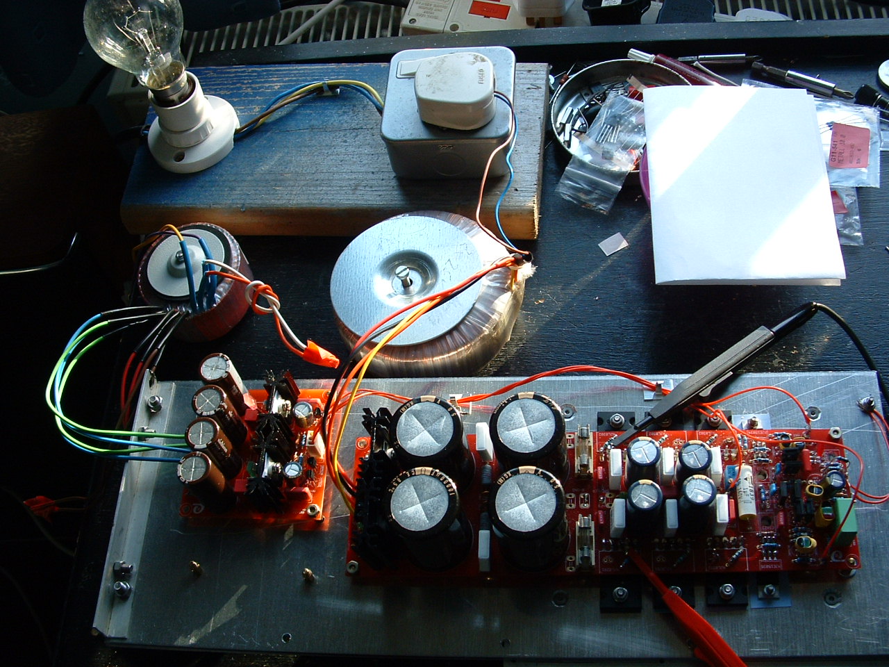

Well the time came to switch on and see if my hard work pays off,this is what i have on both pcb.
Switch on frontend only 2 x 34 ,shunt looks good all leds on except 2 red/green on front of backend.
switch frontend on 2x 25v all stays the same but bulb tester shines brightly and same two leds off meter reads 36mv
If i try to ajust pot r22(upwards) then bulb tester starts to dim and resistor r28 (10r) starts to smoke.
Switch off shunt bulb tester goes out and both leds red/green come on
After reading old posts see Rudi s post 186 looks similar. can anyone advise please regards john

John, I advised you to verify your build this way:
1 - remove the fuses from the on-board fuseholder (disconnect the backend) , connect the frontend-transformer (2 x 34 VAC) to the bulb-tester
and switch power on.
Do all LEDs shine? If not: review your build.
2 - If Yes: remove the frontend-transformer from the bulb-tester and connect it directly to your mains.
Connect the bulb-tester between the backend-transformer and your mains and switch power on.
Is the backend-PSU working correctly (showing correct voltages)?
3 - Insert fuses into the fuseholders, keep the backend-transformer connected to the bulb-tester, verify that the potentiometer is preset to 0 Ohm
and switch on power again.
Best regards - Rudi

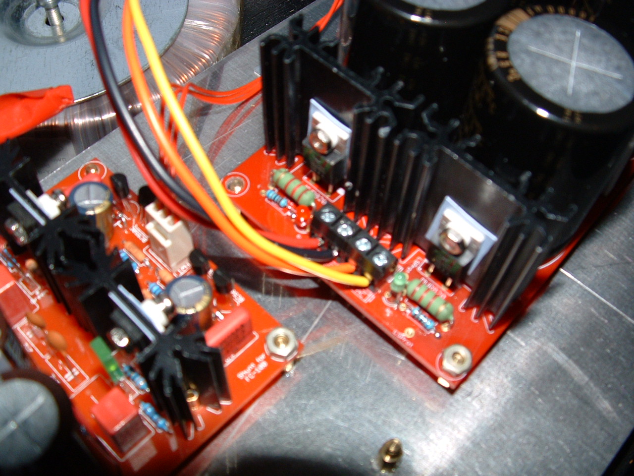

John, is your backend-transformer correctly connected to the PCB?
What brand is your transformer?
Have a look at my build and compare the colours of the transformer's leads.
The orange and red leads connect to the AC-poles of the 4-pole connector,
the black and yellow leads connect to "GND".
Rudi

Rudi Transformer 2 x 25 160va Airlink Transformers ltd......am sure its connected correctly but i could be wrong,,,,,,,,,,,,,if i switch on 2 x25v transformer only then both led s red/green come on........Have i misunderstood you
Something is wrong when i switch both transformers on all leds on except green one next to 4 block connector and i hear buzzing sound, :confused: ,,,,,,,,,, time for a drink (tea) thanks rudi regards john

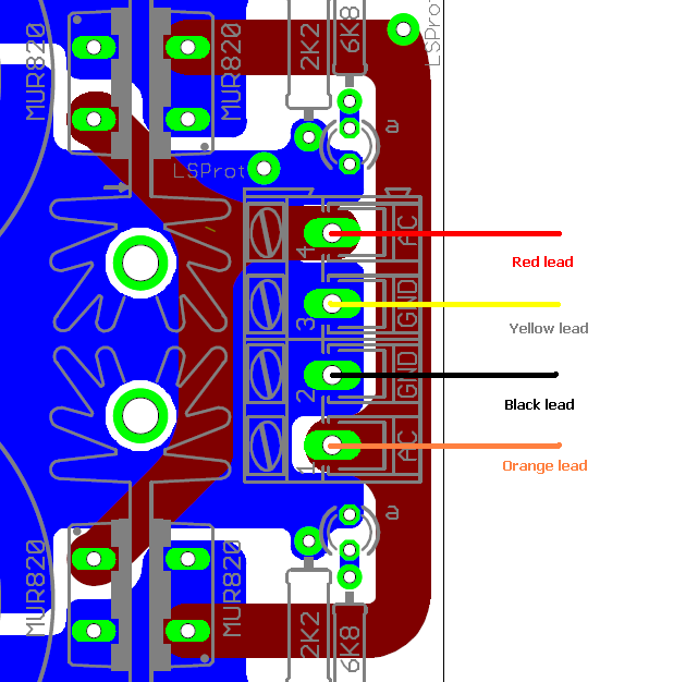

John, the image that you posted is very irritating, and you connected the transformer to the 4-pole PCB-connector in the wrong way.
Please disconnect your transformer from the 4-pole connector, wire the black and yellow lead together and measure the AC voltage
between the red and the orange wire.
Your DMM should read about 50 VAC.
If so: connect the transformer to the 4-pole connector as shown on the attached image.
Best regards - Rudi

Dam it
Rudi i understand ,,,,i was following the pcb image .:eek: you must get frustrated .,,,,,,,,,,,,,,,,,,ok .
When i switch power on to shunt all led come on but not the red and green next to 4 block connector.
Then i switch power on to 4 block connector red and green led come on .....so all leds on,,, all looks ok,,, But 5 sec later resistor r28 (10r) starts to smoke,,,,,, i switch off john
